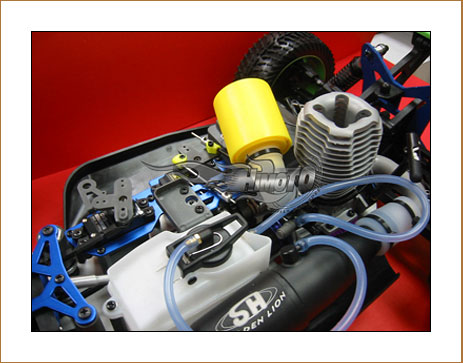

I'll get it started with coule attachements of some pics of the himoto 1:8 scale buggy
ID:	377511   Click image for larger version
