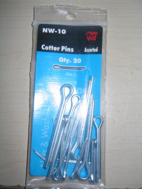

Alright well with this one I got a little creative but I did end up saving myself a few bucks. I accidentally forgot my body pins at the local track and I didn't feel like going back because by the time I realized they were missing it wasn't worth going back. I was checking out how much replacements were and they run about 5 bucks for a bag of them. Well being the cheap guy that I am[sm=greedy.gif], I decided to take a trip to good old Wal-mart and tried looking for something else that may work. Well what I ended up finding were some cotter pins that cost all of 80 something cents. With a couple well placed bends these things worked perfectly. Here are some pictures so you all can marvel at my engineering prowess. [sm=pirate.gif]
In the first one you can see what the original pin looked like, the modified cotter pin, and the original cotter pin. I'm quite proud.

know what works even better? and doesnt require driving....the old fashioned paper clips. They work like a charm and practically every household has one
