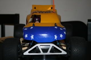

ok heres a picture of my nami with my custom bumper it took about 15-20 mins drawing it up on CAD and 2.3 min's to mill using a prototrak cnc mill it can be mounted on top of the frame or the bottom the screw holes are counter sunk and slotted for adjustment and the bumper is designed to bend during high impact its easy to bend back. i can pretty much program the mill for any design. i chose that design as a test. the aluminum is feather lite aircraft grade. rear bumper coming soon.

nice work retro. You work at a machine shop?
Old 08-03-2008, 02:11 PM
  #1771
retrosoul
Join Date: Jul 2008
Location: Portsmouth, NH
Posts: 193
Default RE: Redcat Racing Tsunami Thread
yes i do i run a manual lathe im going to try making titanium adjustable dog bones this winter and big bore kits for the .18 engine using titanium pistons connecting rods and hasterloy for the piston sleave no expantion or contraction the motor should last forever well the piston and sleeve for sure.

no army just the only body redcat had when i orderd it wish i had a clear body if any 1 knows what other brand bodies i can use please let me know.

pretty much any 1/10th body will fit. you might have to do a little trimming but other then that it will work.
Any chance you can make servo horns? A longer horn makes the steering better but all the long plastic ones Ive tried so far are too flexible.
