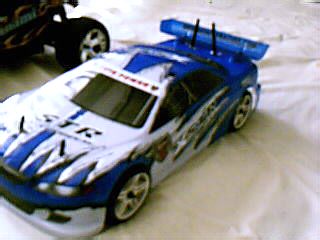

RE: engine cutting off problem
Ok here is some pic of my cars and my brushless jet. I just took'em today. My lightning needs work, my jet needs new
lipo, and my tsunami is all stock except i have the lightning tune pipe and hub. Also notice about the rim? Looks very
