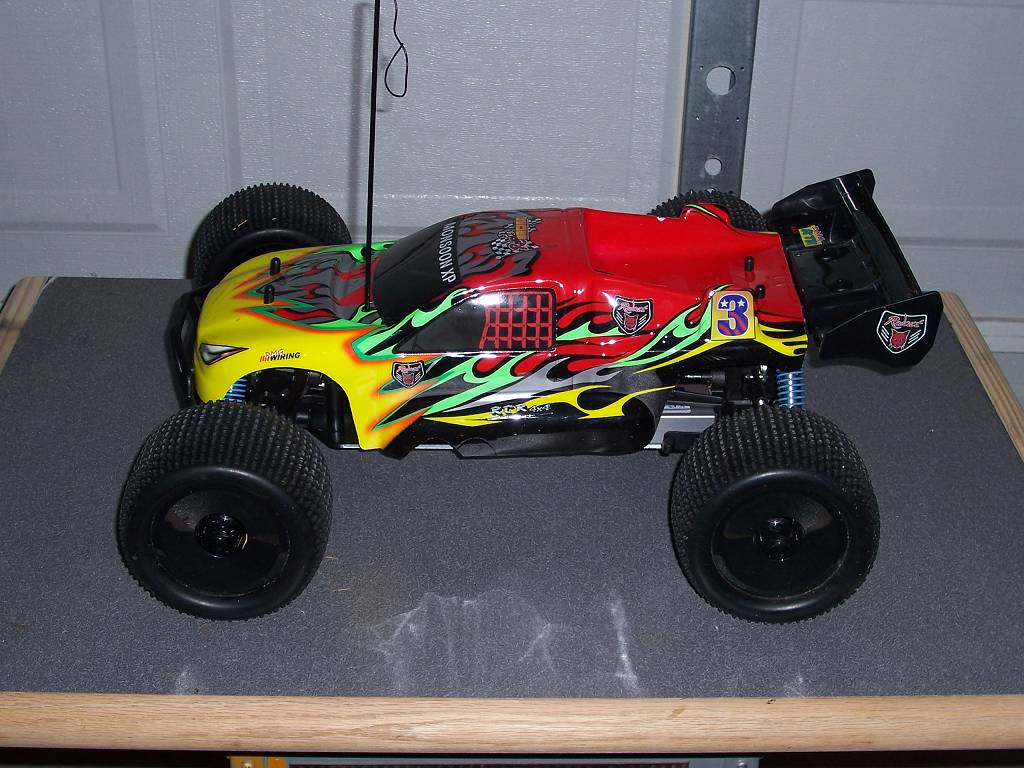

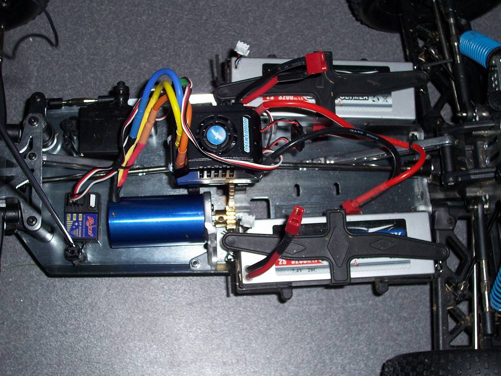

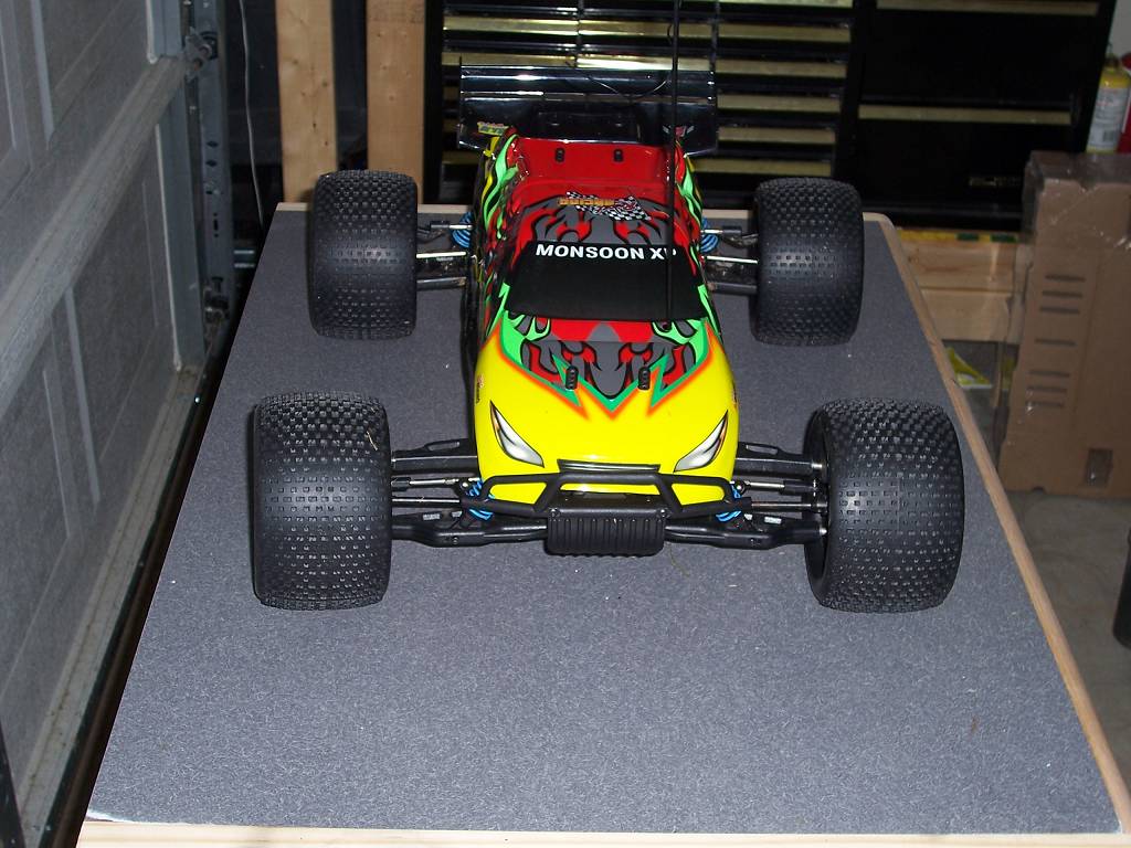

    This is my latest victim built with all Redcat parts. 8E ESC, motor, batteries, battery hold downs, and motor mount (slightly modified) and yes it hauls a**

    That's cool!! What conversion kit did ya use?? Or did ya just use stuff you already had? I was wondering if anyone had converted one to electric.. Looks sweet!! Cant wait to see the vid!!

    I did it all with parts from a Backdraft 8E. I was inspired by this: http://www.youtube.com/watch?v=WuOzJ2jT78Y

    So did you use the backdraft motor mount, and redrill new holes. I may have to look into this. There are cheap rollers for hurricanes at rufaster i think it is.

    Yes it is a Backdraft motor mount I cut the diff mount part off and did some filing to the bottom to make it sit flat on the chassis. Drilled and countersunk a couple of holes in the chassis and there you have it.[sm=idea.gif]
