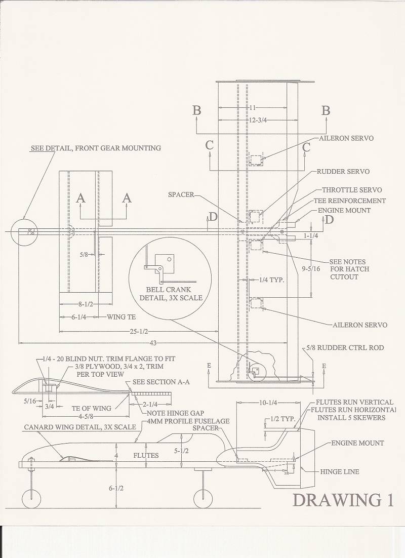

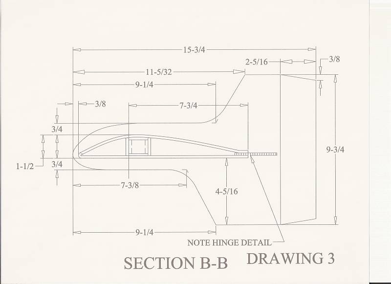

Default RE: Building a SPAD Canard

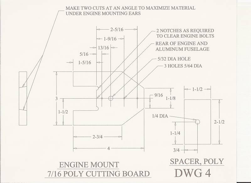

Here is my sixth try. Five drawings. Well it failed again so I will load one, then two and two.
Here are the last two drawings. Any questions, post them here or PM them.

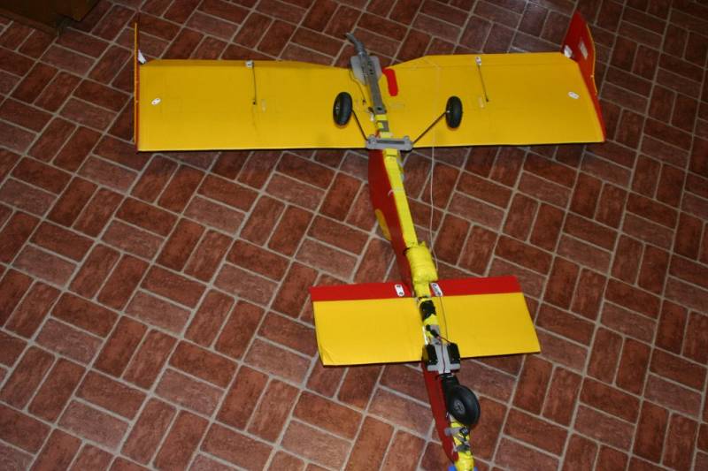

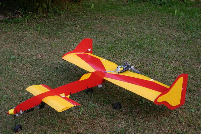

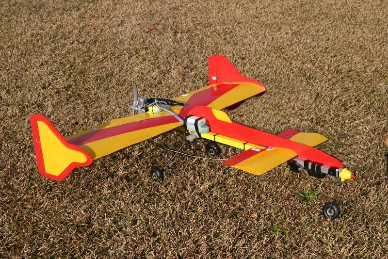

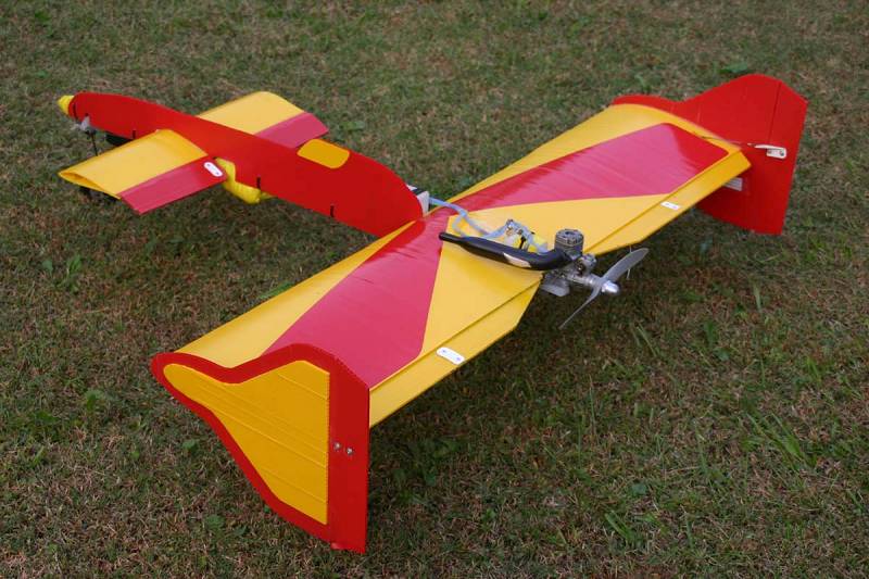

As requested, here is a photo of the other side of the Canard, showing the main fuel tank.

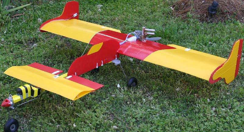

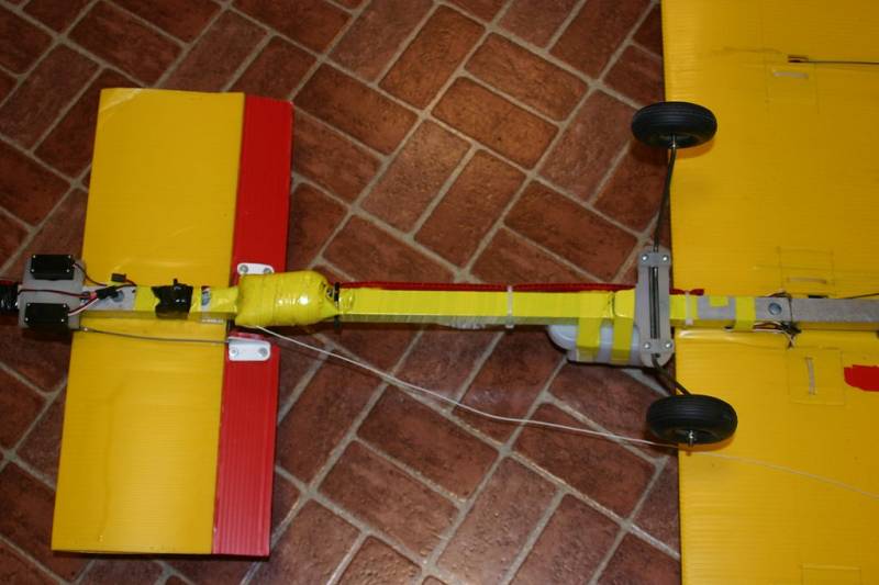

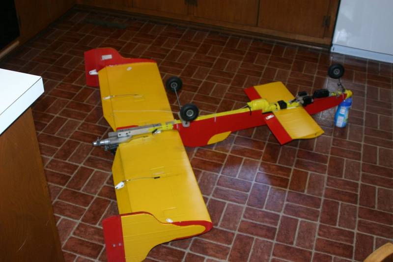

Hi riond. You asked for some photos of the bottom side of my Canard. Here they are. The photos show the Canard in a crashed condition. I pulled a stupid stunt, lost orientation, and spun into the ground inverted, on a blacktop parking lot. I need a new wing. You can still see the broken prop. I dropped from about 100 feet and there is almost no damage. The wing spar is broken so I'm making a new wing. I don't remember now if the canard wing needs replacing. As I mentioned earlier, the profile fuselage gives the two rudders too much control (authority). I will reduce the profile area by ending the front of the profile about even with the TE of the canard wing. I will also reduce the rudder movement (authority.) I hope this crash does not turn you off building the Canard. Riond, this morning I also answered two of your PM messages to me. Hope to hear from you on that. Don't you or others be afraid of the drawings. Not everyone can understand them or needs to understand them. If you need more photos just ask for them. Ask any drawing questions you have.
I just reduced the area of the fuselage on my Canard to make it less dangerouse in knife edge. I also changed the muffler to a PITS style so the exhaust is more in the direction of the rear of the plane. No oil mess at all.

Hi Pilots12
In the photo above your last comment you will see I have a 2 once fuel tank very close to the engine. The main tank is in front of the main wing. Connect muffler pressure to the main tank pressure connection. Connect main tank out to small tank pressure connection. Small tank out connects to needle valve. I have zero fuel problems.
