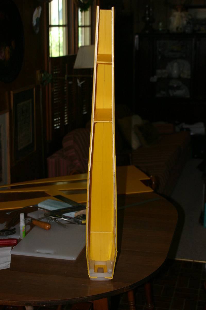

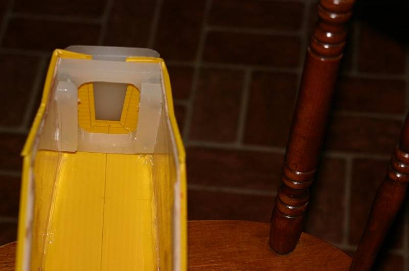

When a few others came up with the CoroCub I tuned right in. Thanks for those designs. I have had two Balsa Kit Sig J3-Cubs and loved them. I decided to build one and used the Sig plans as a starting point. It is a little smaller (71 inch wing span) and will fit better in my compact car. The Sig J3-Cub has a cabin are that is very weak in my opinion. I clarify this by stating that I believe a model should come out of a cartwheel in good condition. My planes tend to be heavy. Attached are 5 photos of the fuselage. All Coroplast is 4MM. I'm using 1/16 inch plywood inside the cabin area, reinforced with an additional layer of 1/16 ply at the top and the bottom of the sides. The firewall mounting is exceptionally strong as shown in the photos. The firewall is 7/16 POLY that sandwiches the 4MM Coro against another 7/16 POLY frame that has 7/16 posts for added screw attachments thru the sides and the 1/16 plywood. It is solid and a bit heavy. I hope to add a little more area to the wing to compensate and will use an OS 46FX engine. I would like to read more flying reports on the CoroCubs that are flying.

The above is about my 5th try at up loading the 5 photos. I keep getting an error message. Finally, a few minutes ago I just up loaded the first photo. Here is the second photo. I will follow with individual messages for each of the remaining three photos for a total of five photos.

I was just automatically rejected because I am posting too many messages in a short time. I'm sorry about that. I'm not trying to circumvent anything. Just trying to post five fotos. This time I will try to post the remaining three photos at one time. Could not post all three, so here goes just #3

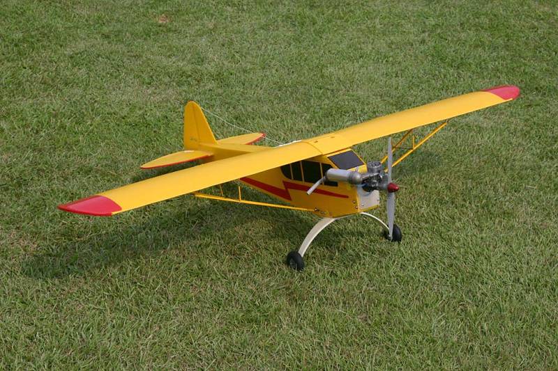

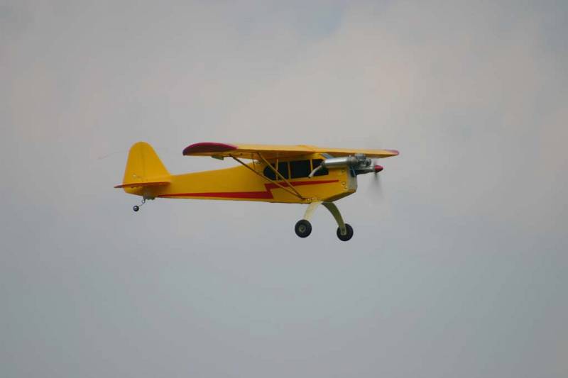

Old 09-14-2006, 09:21 AM
Villa
Villa's Avatar
Join Date: Aug 2003
Location: Wilson, NC,
Posts: 2,057
Default RE: CoroCub also
Here are 4 photos of my CoroCub. I have had 3 bad crashes with it and a number of small ones. Even did a full cartwheel with no damage. Only the last crash required repairs.
