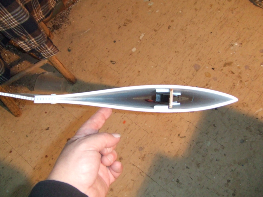

I've been playing around with 4mm coro and have a good looking wing but its a symetrical shape.
Flutes are running cordwise. I scored the LE and folded it over, I glued the aileron inbetween the top and bottom TE.
I then spread the top and bottom and slid the yardstick into position. Very difficult to do. ( I had glued sections of coro inside to make a channel to hold the yardstick in position.
Looks great, a little heavy cause its all 4 mil.
So why do I SEE ALL FLAT BOTToM WINGS?

Hi Popriv
I would say it is an evolutionary thing. Those who made free plans available started with flat wings. Another reason is that the flat bottom fits perfectly to the flat fuselage. Makes things simple, like in Simple Plastic Airplane Design, or SPAD. My SPAD Biplane has symmetrical wings, but all of my other SPADS have had flat or semi-symmetrical wings.

Here is a picture of my first attempt with coro..
Just trying to see what I would get.
Its all 4mm, 36" x 12" with a 2.5" aileron...
I dont see a problem making a wing saddle for the shape?
I wish I had made it longer...
Sooo, how does it look?

ORIGINAL: Villa
Hi Popriv
Hi Popriv
Also, most of the original SPADs were Combat oriented and using the heavier materials we used to have to deal with. Heavy PVC/All 4 mil. Since combat consists mostly of a lot of loops a flat bottom wing will produce more lift making a heavier plane fly better upright and loop tighter than a symmetrical wing of the same dimensions and weight. So what makes for an easy to build wing is actually optimized for our purpose. Past that though if you want to switch up to lighter materials making it symmetrical like you have done is quite the easy thing to do.

Good point about the lift and looping during combat. also the fact that the foam needs to be covered.
Now to get a flat bottom is it just a matter of how you line up the material at the TE? Even like I did gives a symmetrical wing. for a flat bottom I need more material on the top when I line up the TE? Seems harder that way? ( But not much)
I'm trying to find some local 2 mm coro and I'll redo the wing in that.. Less wieght.
Do you think the current wing would work? at the current dimensions?
Steve

ORIGINAL: PatrickCurry
I think that's why the top is wider than the bottom on all the STTB plans and you fold it over after your spar is glued in place, then mark it and cut it off flush. That's a lot easier than trying to calculate the distance with the spar height and the curve and all. To get the flat bottom, I have a piece of 1x4 that I cut a 45 deg bevel on one side. I fold over my wing and get the TE even with the edge of my wooden bench. I jam the 1x4 up tight against the LE and screw it down to my bench. Then I glue her up, jam the LE up under the 1x4, put a 2x2 over the TE of the wing and clamp it down tight. When I pull it out it's pretty flat except for a little bit of reflex on the bottom near the TE where the pressure of the top is pulling up on it. Seems to work pretty good. An angled 2x4 might be even better because then you've got more height so you can not jam the wing under all the way and let the LE come up a bit and you can get a symmetrical wing or a semi-symmetrical if you'd like.

Very good, I'll try that on my next attempt.
Right now I'm leaning towards the gnats shaped wing and I'll see how I progress with that.
