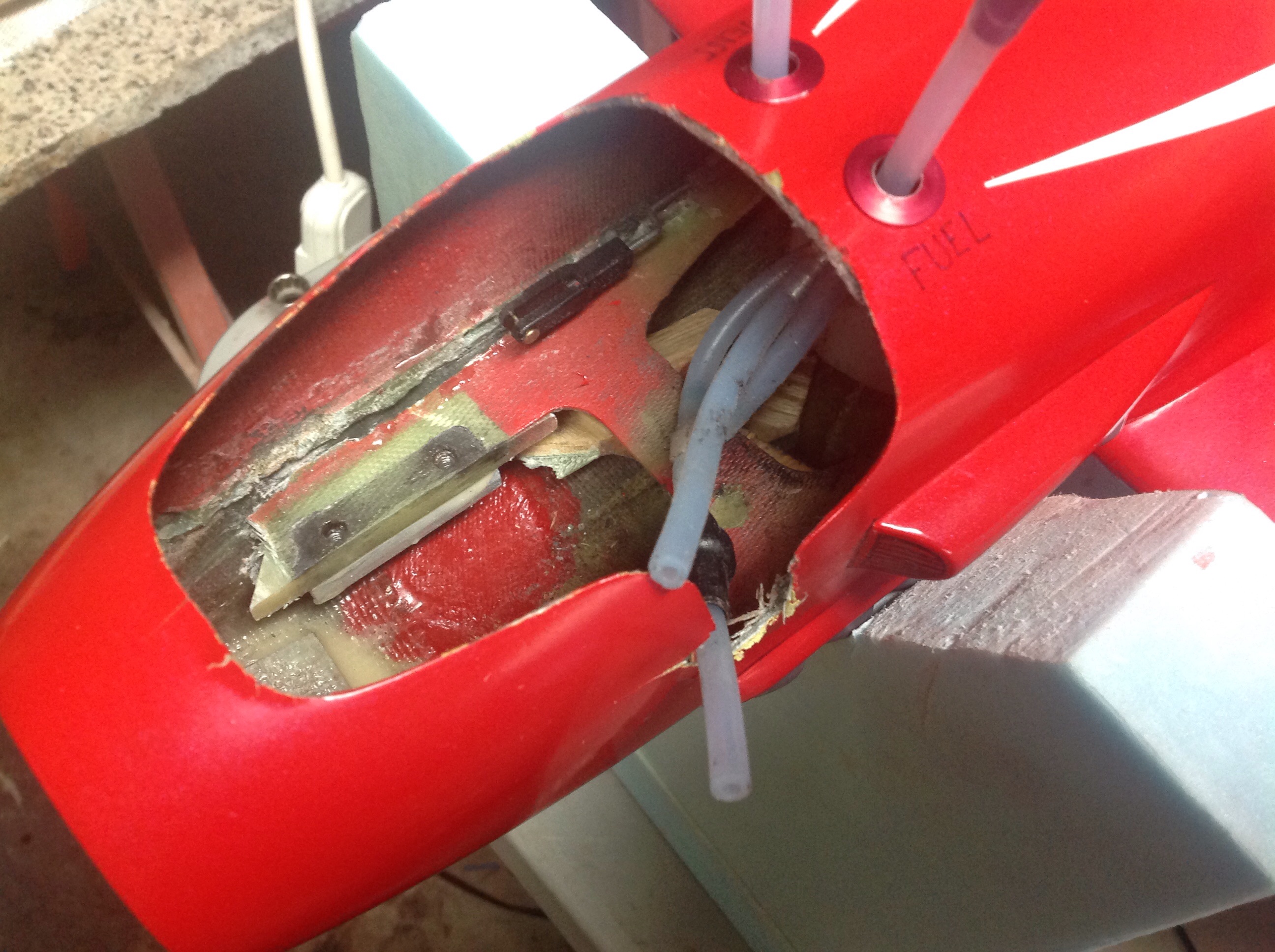

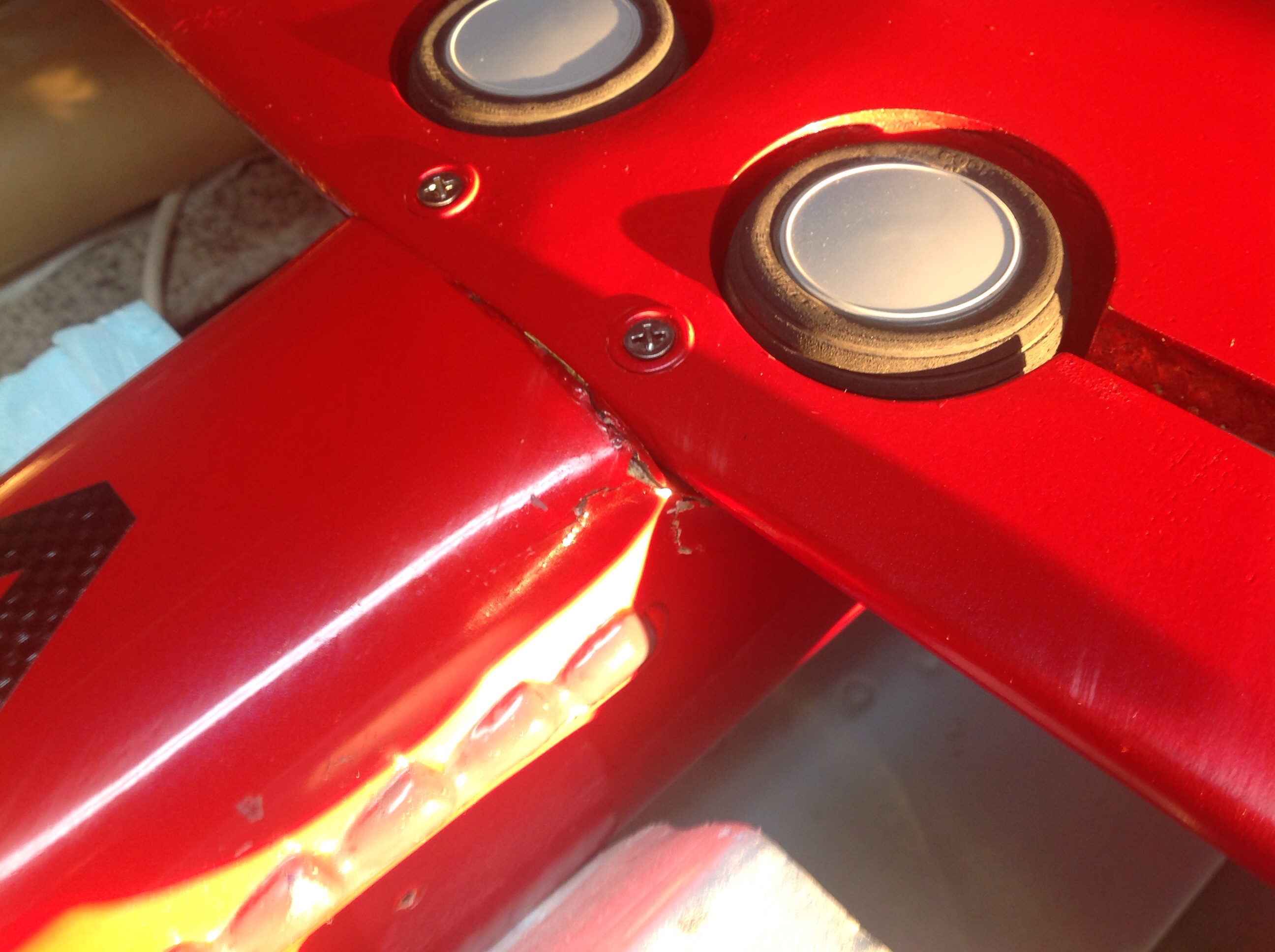

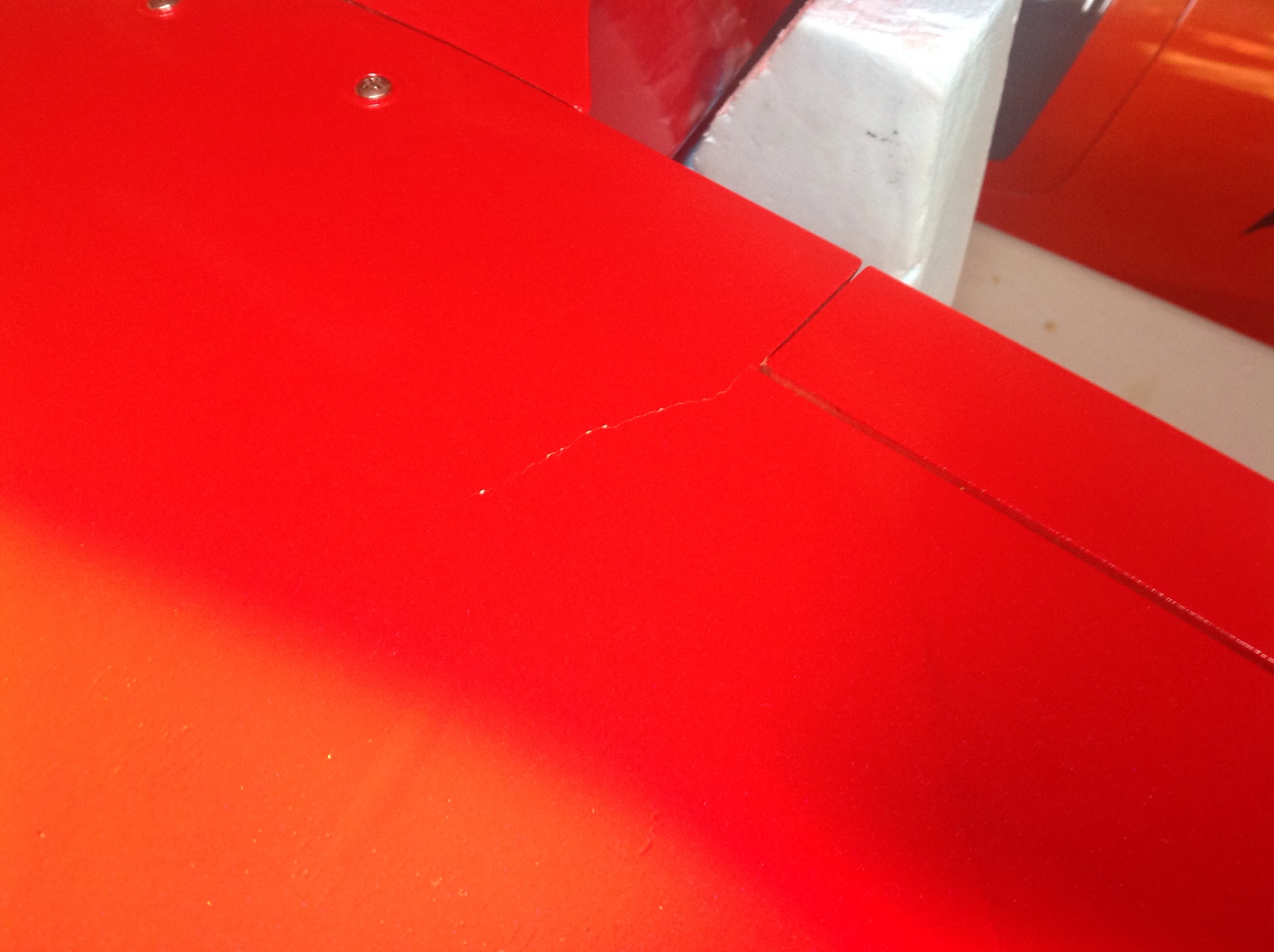

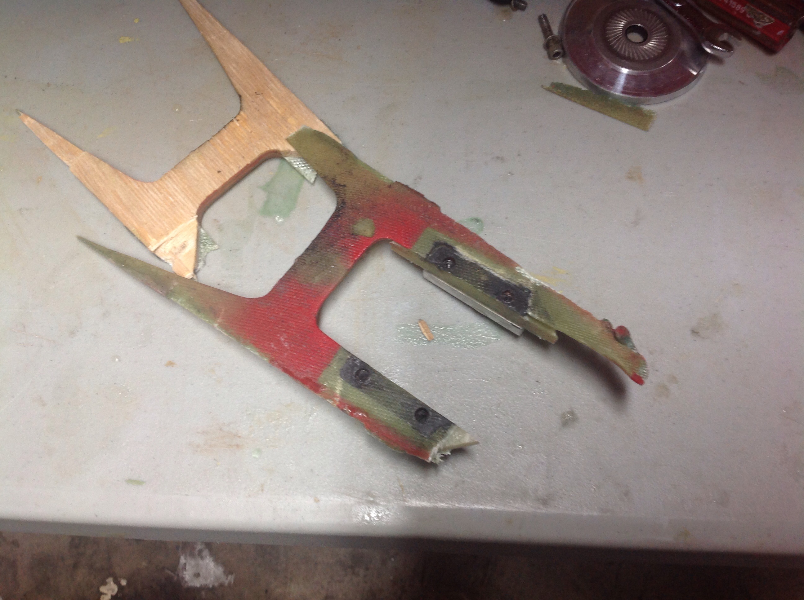

14x13.5. I'm surprised the engine stayed with the airplane. Not sure what the actual cause was. Earlier in the day I had the mount come loose. I epoxied it back and added some screws between rounds. The following round went well with 14x13N and 30%. Made it into the trophy race and knew that 30% was not going to beat Mick and Mark. James Gale gave me a tank of 55% and I changed to the bigger prop. Mick and I were trading the lead back and forth. Virginia tells me I was leading when all I knew was the engine had quit. I had just thought I popped a plug. The look on her face when she retrieved the airplane said more was wrong. Upon inspection the front of the airplane is chewed up but worst is the stress damage to the wing. After pulling the engine I found that the needle valve assembly has vibrated loose, throttle arm was loose and the ratchet clip on the needle valve is gone.

post or send pic of the prop hub ok

That is too bad. You may have been at the rpm limit of the prop. By APC math the 14" prop can only turn 13500 safely??

LOL Scott, I'm thinking at most the engine may have been turning 10,500-10,700. Expect your cores to arrive tomorrow. I did find a nick in the remaining blade. May have damaged it on some FOD during take off.

One thing I learned the hard way running APC props on ducted fan engines is to look for white stress marks on the prop blades near the hub. When they are near or over the safe rpm and you see the white stress marks, they usually throw a blade on the next flight. Ask me how I know that. Check your remaining blade.
