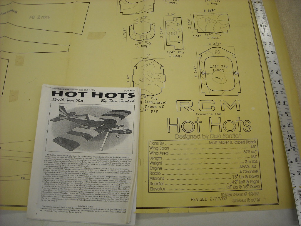

    I'll start with a couple preliminary pics of the building board, plans and instructions. The building board is nothing more than a couple of 2' X 4' ceiling tiles that I have taped together. The tape acts as a huinge so that I can fold it for storage when not in use. It also, helps keep a smooth seam where the tiles are joined. I have them taped due the fact that I sometimes build wings larger than 48 inches and also have plenty of length for lengthy fuses when needed. The two plans pictures are self explanatory. I posted them so you could see the designer's name and the specs. Matthew, the plans picture should address your question about which Hots we are building. I also, have both the Hots Bipe, Ultra Hots and the Big Hots plans and hope to build one of them next winter... Hopefully... probably the Big Hots.
    Keep in mind guys that I'm building two at the same time in addition, I travel a lot in my job so you may see some gaps in my postings when I'm out of town or performing duplicate task on the second wing, fuse, etc.

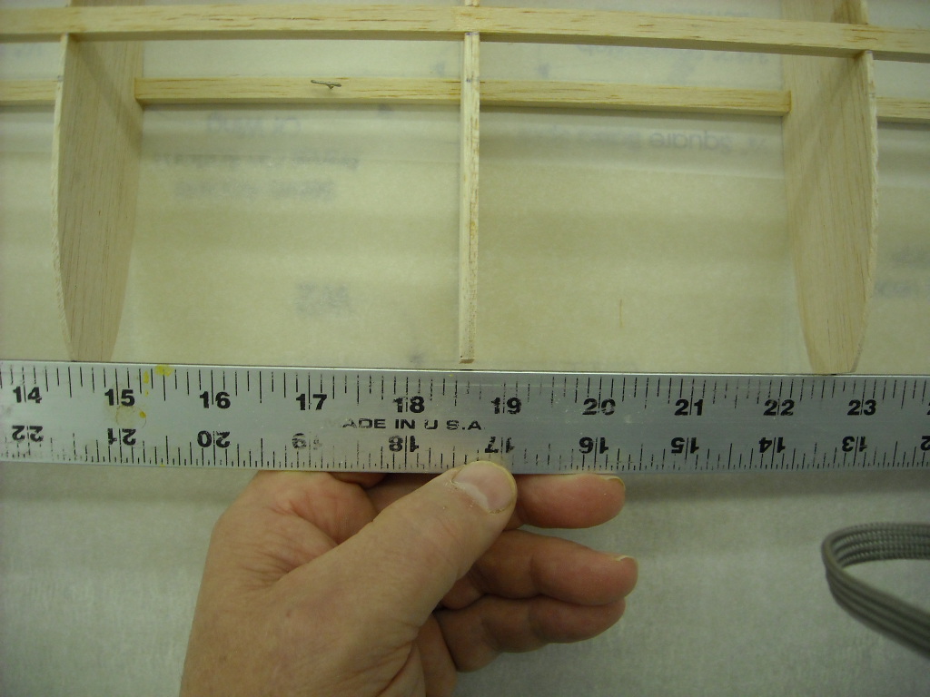

    The 2nd pic is showing how I checked the ribs to make sure they were in alignment after I sanded them with the T-Bar.

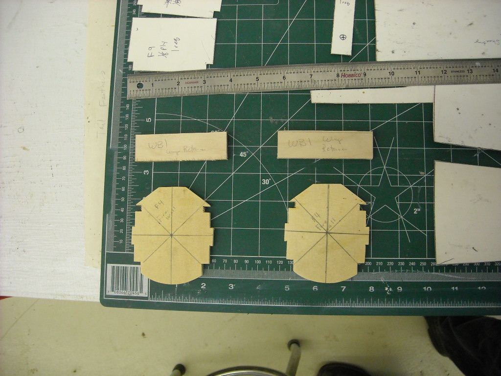

    Pic number 4 is two fire walls and two wing bolt down plates. Even though the plans call for AC grade ply on the firewall, I have found 1/4 " lite ply to be more than adequate. This little plane is heavy for it's size and weight should always be on your mind. Also note: every Hots I have built has been fairly tail heavy with the exception of one that I stick built a couple years ago.

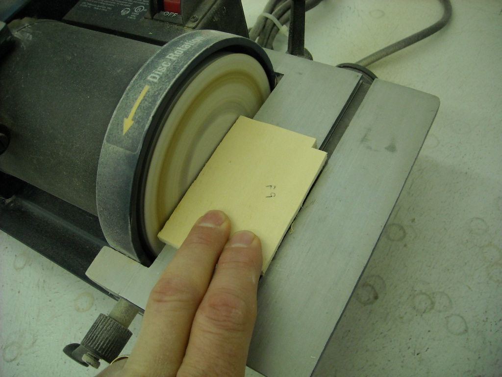

    Picture number 5 shows me doing a little pose here demonstrating some clean up of some of the internal fuse parts to get the correct size and knock off any rough edges aquired during cutting.

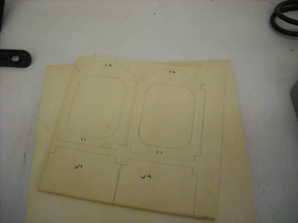

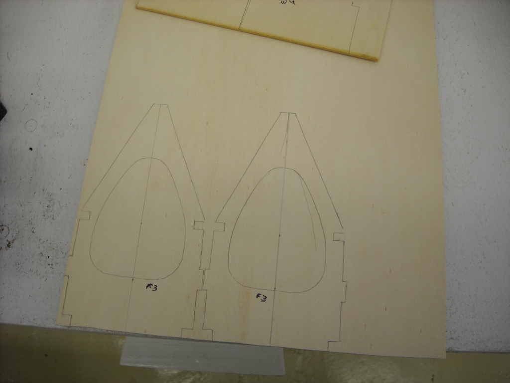

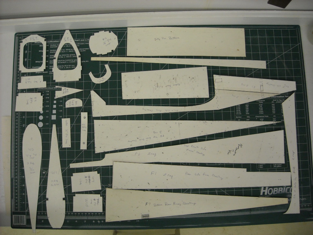

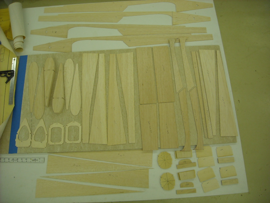

    The first three pictures are of all the parts cut and laid out to build two Hot Hots. The last picture is where I realized I didn't have the right size balsa for the trailing edge of the wing. As a result I grabbed up a 3/8 " X 4" X 48" balsa plank and used a balsa stripper to cut my own stick. Had to finish with very little plaining and a little clean up sanding. No big deal, it took about fifteen minutes.

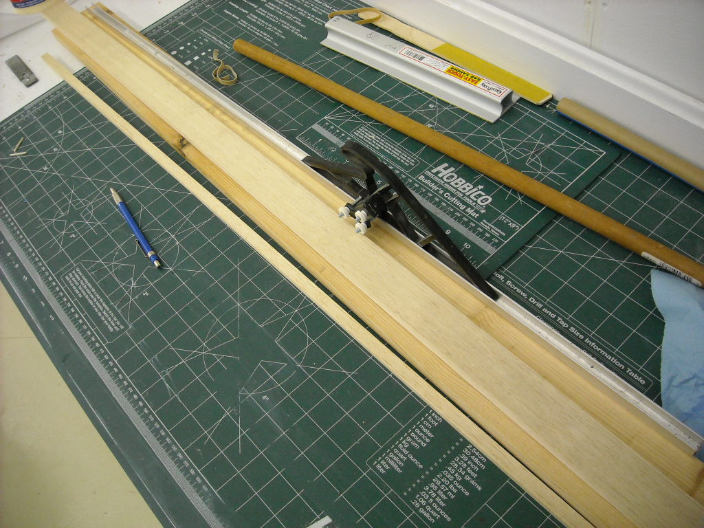

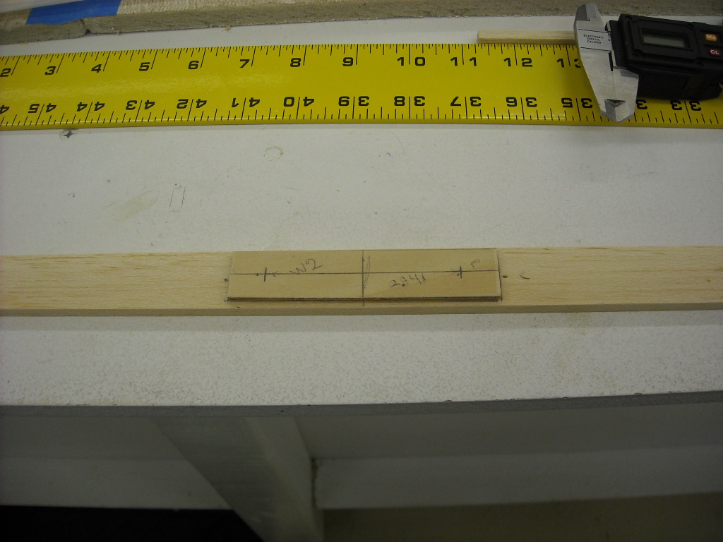

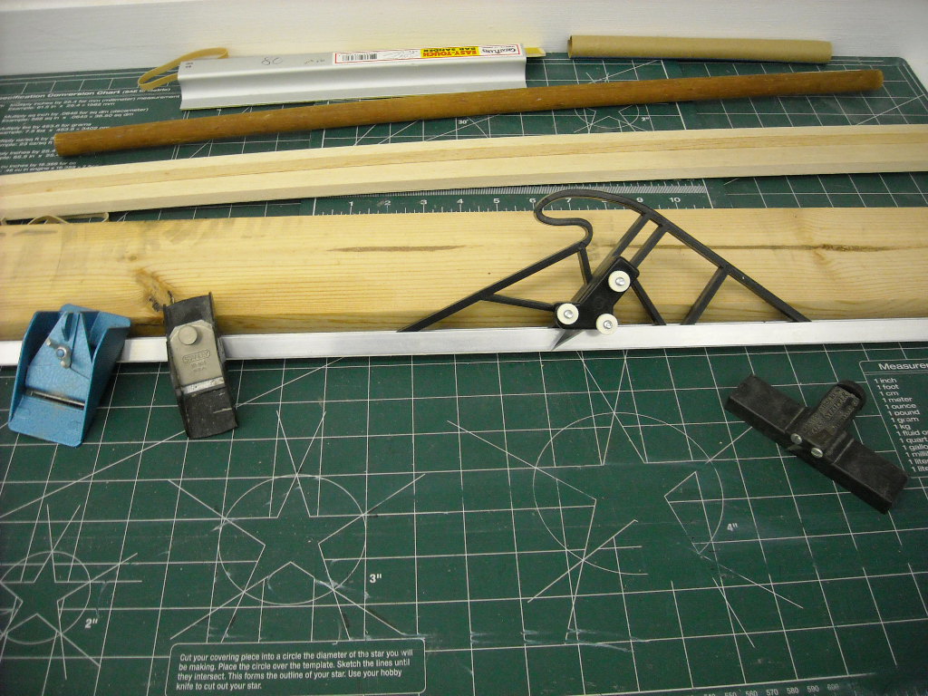

    ********Knight,
    The first picture is of the two balsa strippers and planers I use. I haven't found where I might have purchased the large one, my wife thinks she may have bought for me at micromark but I'm not sure. I will research some of my old magazines and try to locate the source if your interested.
    The 2nd picture is where I decided not to hollow out the ribs. I have done this on past Hots but weight savings was so minimal I decided not to cut them out on this one. as you can see the rib as a whole on weighs .1 oz.

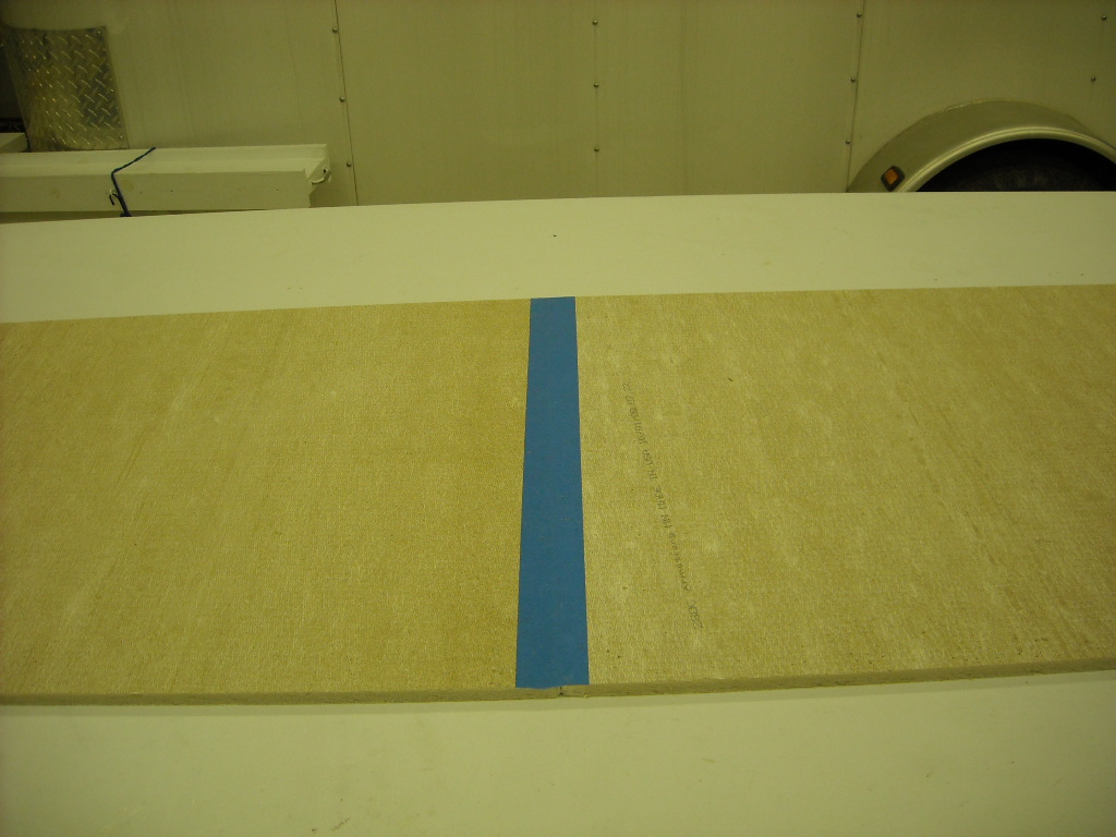

    The 3rd picture is where I covered my plans. At one time I used wax paper but it seems the wax is much thinner than it used to be. A more experienced builder on RCU suggested baking parchment paper from the grocery store as it has more wax and is more robust. I tried it a few years ago and haven't looked back.

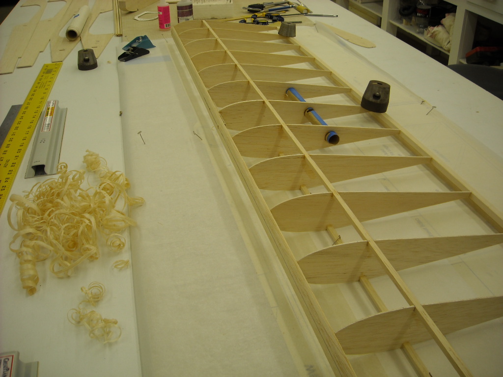

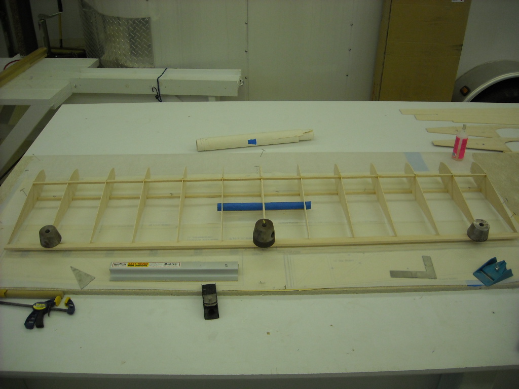

    Wing construction at various stages.

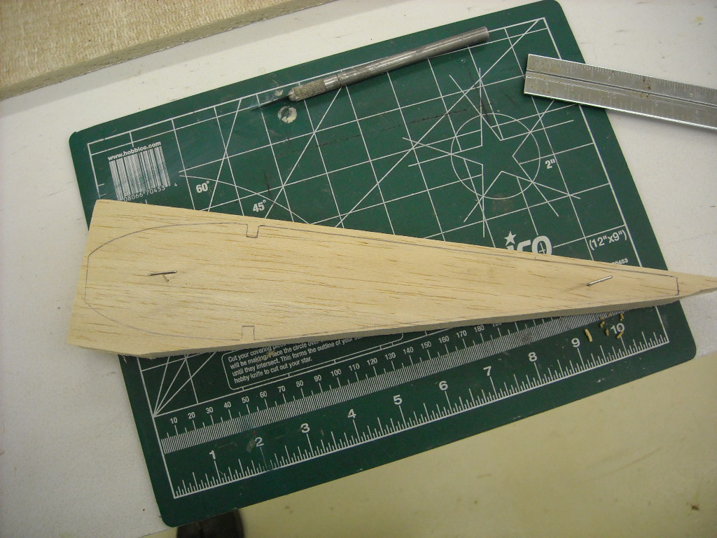

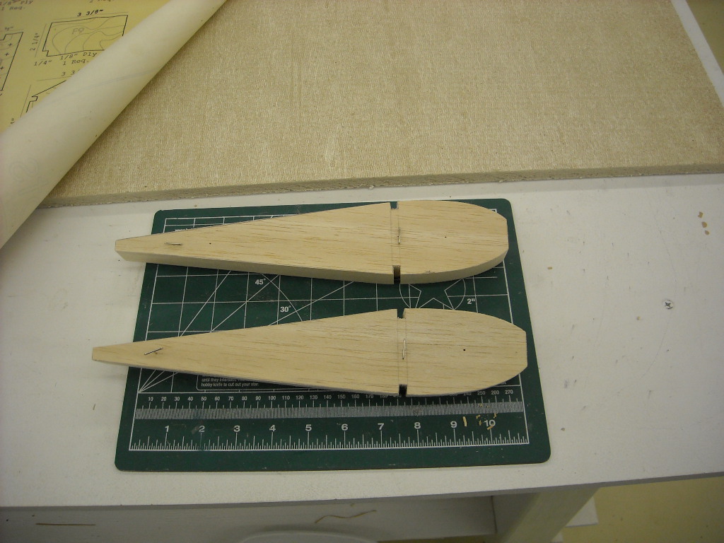

    Here is where it can get tricky if you skip a step or don't examin the plans close prior to gluing the ribs. (Picture 1) I took the center two ribs which end up being glued together, (I used CA) but, some people use Tite bond, "which is perfectly okay", here in case they need additional sanding. these two ribs must be cut 1/8 inch shorter than the rest at the leading edge. The reason is to make room for the Aircraft grade 1/8 inch ply that will anchor the wing hold down dowels. I do this before gluing the ribs to the spar. It can be done after by sanding but is a little more difficult and you run the risk of breaking a rib if your not careful.
    Pictures 2 through 5 show the plate, the dowels that are anchored, the plate that will be in the fuse that the wing will slip into.
    Picture 6 shows the plate as it looks with the leading edge attached to the front of the ribs. I should have poked the dowels in the leading edge on this pic so you would see them sticking out but, forgot to. You'll see them on future pictures.

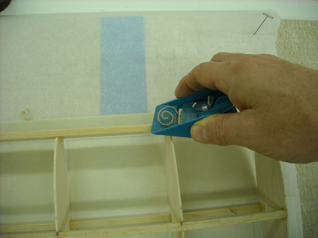

    The 1st picture is showing one of the razor planes and the process of planeing some wood off the LE.
    The 2nd picture is showing the top of the LE as it is being rounded. It is not finished as I still need to do more on the top then flip the wing over and plane and sand the bottom to get a rounded LE.
    The last pic is where I rolled a tube out of brown paper and glued it into the wing to act as a servo wire conduit.
    I'm thinking of putting in 1 degree of washout and would like know what some of you think. I have built these planes with zero washout and although they fly great have had a tendency to tip stall to the left at very slow flight, (slower than intended flight I might add). The last one I did I put two degrees in it and feel it was definitely too much although it flew okay. One degeree of washout out would mean spacing the wing tips at the trailing edge up 1/8 of an inch to get the one degree on the chord.

    The balsa stripper shown seems to be the SLEC one that is sold in England http://www.slecuk.com/catalogue/Building-Aids.html An excellent gadget. The channel section is 39 inches long so I am not sure if they would export them but it might be practical to buy one together with one of their kits or buy several at once for your friends. If you do buy get some spare blades in case you cannot get them locally, although I am still using the same blade after many years. The SLEC rubber band clamps are great too.
  19. #19
    mikem99's Avatar
    Join Date
    May 2004
    Kippens, NL, CANADA
    85
    Gallery
    My Gallery
    Models
    My Models
    Ratings
    My Feedback
    RE: Hot Hots Plans Build Thread
    The balsa stripper with the 39in. channel is a Sltec that was carried by Hobby-Lobby. I went down to my shop and dug out the paperwork for mine. My stripper is about 25 years old and it is still listed by Hobby-Lobby as "HLH 625" http://www.hobby-lobby.com/balsa_stripper_2482_prd1.htm
    I have only used mine a few times, but they sure make a job easier.
    Mike
    \"One-Piece Landings are a Bonus\"
    http://www.bsgflyers.org/

    MikeM99, Thanks for the info on the Balsa Stripper! I just ordered one and spare blades. I've been using a cheap balsa strip tool for years and the blade holder is worn out.
    Willy, I got out my plans for the Hot Hots, OH MAN... I wonder if I have focus enough to build two planes at once? (This and the Super Decathlon)
    I'll keep watching your progress, and remembering my enjoyment from previous Hot Hots days.

    My buddy and I both bought magnum XLS 46s from Hobbypeople.net. They recently had a sale on them. I have run magnum for years and really like the power they generate for their size. However, I'm thinking about saving my Magnum for another project I'm thinking about down the road and useing a Tower Hobbies 46 that I took off the Carnage of my previous Hots. It looks and feels okay so I may just put it on this one and save my Magnum for a rainy day. BTW: red, I got some lead to balance my Super Decath, probly break away for an hour and finish the balance on ot next weekend. Actually, I need to correct that statement, I had installed the TH and removed it almost immediately to try out an OS 55 when I built a cowl for it. The 55 was the engine on it when it crashed. The TH was better.
    Mikem and KDC,
    You are correct in that the stripper is a Slec. Even though I don't remember where it came from for sure, it must have been Hobby Lobby as there is a store about 20 miles from where I live. I'm still useing my original blade however, I need to get a spare. I thought you had to go to a medical supply store to get it as it is a surgical blade but after reading the post where red_jeepster bought his and a spare blade I'm going to run by Hobby Lobby and see if they have them.
    I didn't get to work on the Hots last night as I had a pretty full day by the time I got home and fed the horses. Not sure about today either as the family may have some festivities planned for my BD. Hopefully, I'll get out to the shop later tonight and tinker with them a little. However, I'm off all day tomorrow and plan to work on the Hots.

    The correct name is SLEC which stands for Sun Lane Engineering Company. They are one of the very best manufacturers of modelling items in England with a large range of really useful gadgets and model fittings at reasonable prices. I think someone imports them into USA and maybe sells them under their own brand. They also sell kits in Britain which were branded as Precedent and also Balsacraft. Not many of these kits are still available but they have recently brought back the Limbo Dancer, Funfly and T240 due to popular demand.
    The blades used are marked Swann Morton who are the leading British maker of scalpels etc, they have an agent in Cinncinati. I think its this blade http://www.craftknives.co.uk/products/supatool.html Its V on this USA site http://www.cincinnatisurgical.com/li...s&item=crblade
    Also for normal model work check out Swann Morton's retractable scalpel called Retractaway which is superb, holds the blade very firmly ( no wobbling around ), quite cheap at about 3 pounds here in England ( 7 dollars in USA it seems ) and uses standard medical blades which are easily obtainable. http://www.cincinnatisurgical.com/li...&item=crhandle
