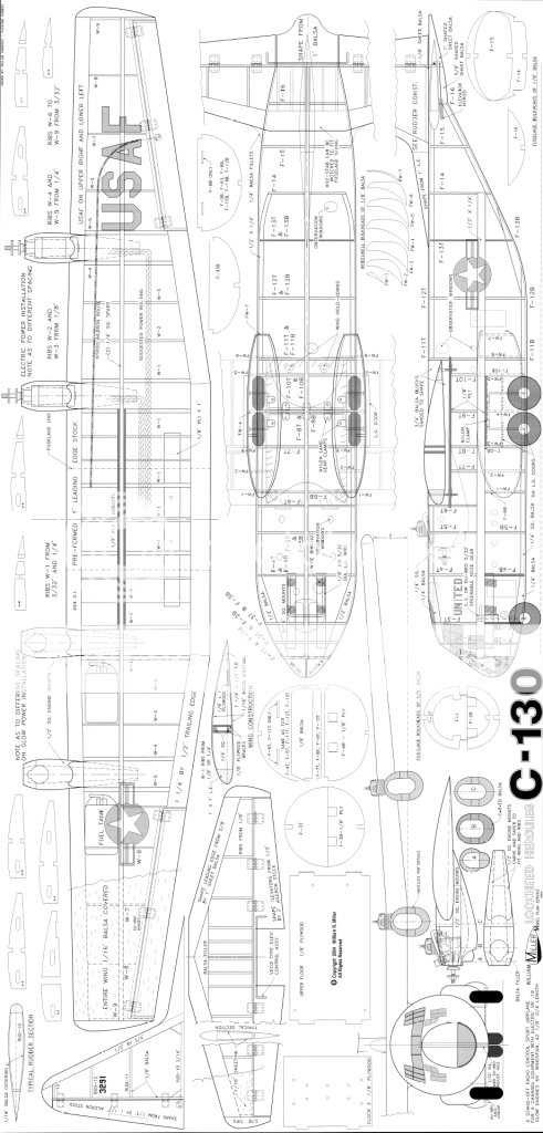

In the process of building aUncle Willies C-130 from scratch. It hasplansbut no instructions, CAD drawings. Ithas a 65" wing span andcan be electric or gas,4 engines. Its my first build, which wasn't a smart choice on my part and unfortunitely I dont have any power tools except a dremel so all of my parts are being cut by a exacto knife.
Has anyone ever built one of these, I could use some advise.
Oh forgot to mention all balsa build, no foam but thinking fiberglass covering

ok first question: it states elavator "Nyrod"  and aileron "Nyrod" route. What the heck is a Nyrod? second what kind of control setups do you guys recommend? Second: Veco type elev control assembly... whats that? sorry I'm new at this.
Picture of plan will be uploaded soon once I figure it out..

Nyrod was nylon tubing in a tubing similar to the Sullivan plastic pushrods material now available. It is very old. Veco horns were a wire bent in a U shape with a metal horn welded on. Usually used on the elevator but sometimes the ailerons. You can still get an equivalent from Brodak's.

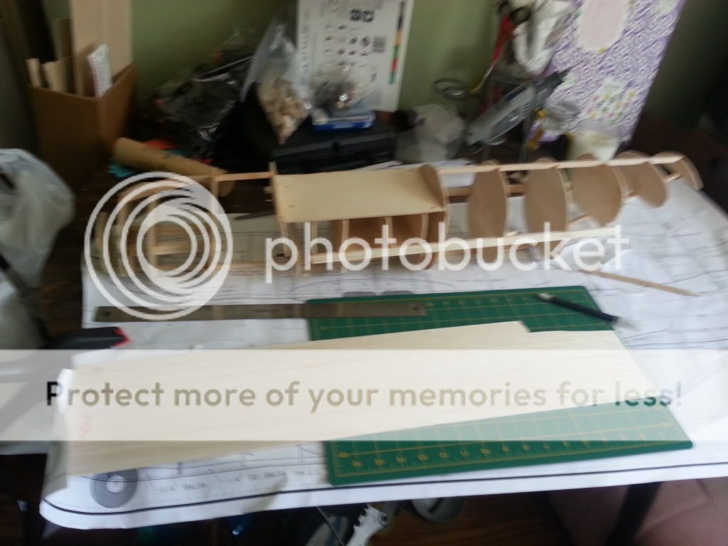

Well the fuslage is coming together..... I have to buy the components for it... I'm using ca glue, bulkheads made of 1/8" balsa and1/8" lite ply. bulheads are mostly solid pieces with guides 2 on each side cut to fit 1/2" x 1/4" balsa sticks and 1 on top or bottom to fit 1/4" sq. balsa stick. bulkheads are seperate pieces for top and bottom... dunno if I like that makes glueing them difficult. I noticed I'm not a very neat cutter with an exacto knife or mini hand saw have to buy a mini scroll saw when funds are raised.
Have another question... what component makes the plane steardy? the bulkheads are basically free floating so where does it get its strength?

Sometimes a good mom and pop hardware store will have a wire selection.
You're going to need to sheet the fuse at least partially to give it strength

When I cut balsa or ply pieces I will always leave a little material, then use sanding blocks to finalize the part. this does not take long and does a superior job even to a scroll saw. Get yourself a couple of T-bar sanders, and not only glue sandpaper to the face but you can glue some to one side of the "upright" this way you can use it to keep your sanding at 90 degrees, especially if you are sanding stacked parts such as ribs or whatnot.
You can also get creative, glue sandpaper to a piece of pipe for inside jobs, wing fillets, etc. cut apiece of pipe in half, glue sandpaper to the inside and it is good for rounding leading edges of stabs etc. A lot of kits come with "jigs" made of light ply to sand the hing line of the control surfaces to a beveled edge, just three pieces of wood glued together. I have lost mine but maybe someone could post some plans for one.

lets see if this works... these are 2 pictures of the plans

OK now it worked. so this is what the plan looks like.... wont rotate sorry. First picture is what I'm building on.. second picture is attached to the right of plan with just required parts you need to cut out. Note anyone who might be building this. Not all the parts are on the right... No istruction book given alot of trial and error in building this. I have rebuilt the fuselage twice... best advise I can give to anyone... and take this for what it is from a new guy... build it in sections used the 1/4" ply floorings for connection points made it alittle easier. will take a pic of what I have built already when I get home.

Looking good Tristan, I see what you mean by the fuse needing some sheeting to tie it together.
Not sure what the plans mean by nylon gear clamps, but if it is similar to what would come in a kit, it is just a strip on nylon with a couple of holes for screws, the idea being you set your gear into a hardwood hole and slot then the nylon srap just holds it so it does not fall out.
You can buy a wire bender, or just use a vice. I have no experience with working with wire, just make sure you buy extra for "practice runs" we all learn from our mistakes(or at least I do, you may get it first try)
