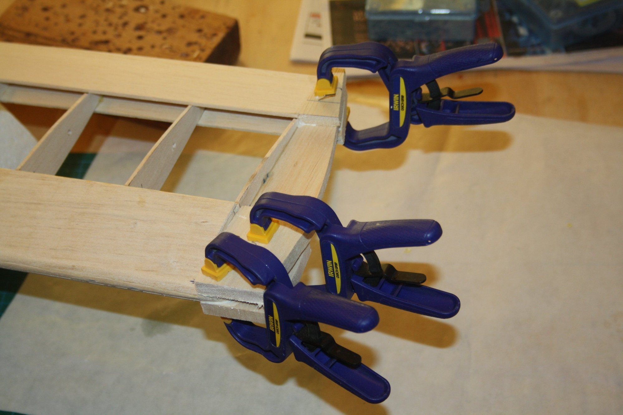

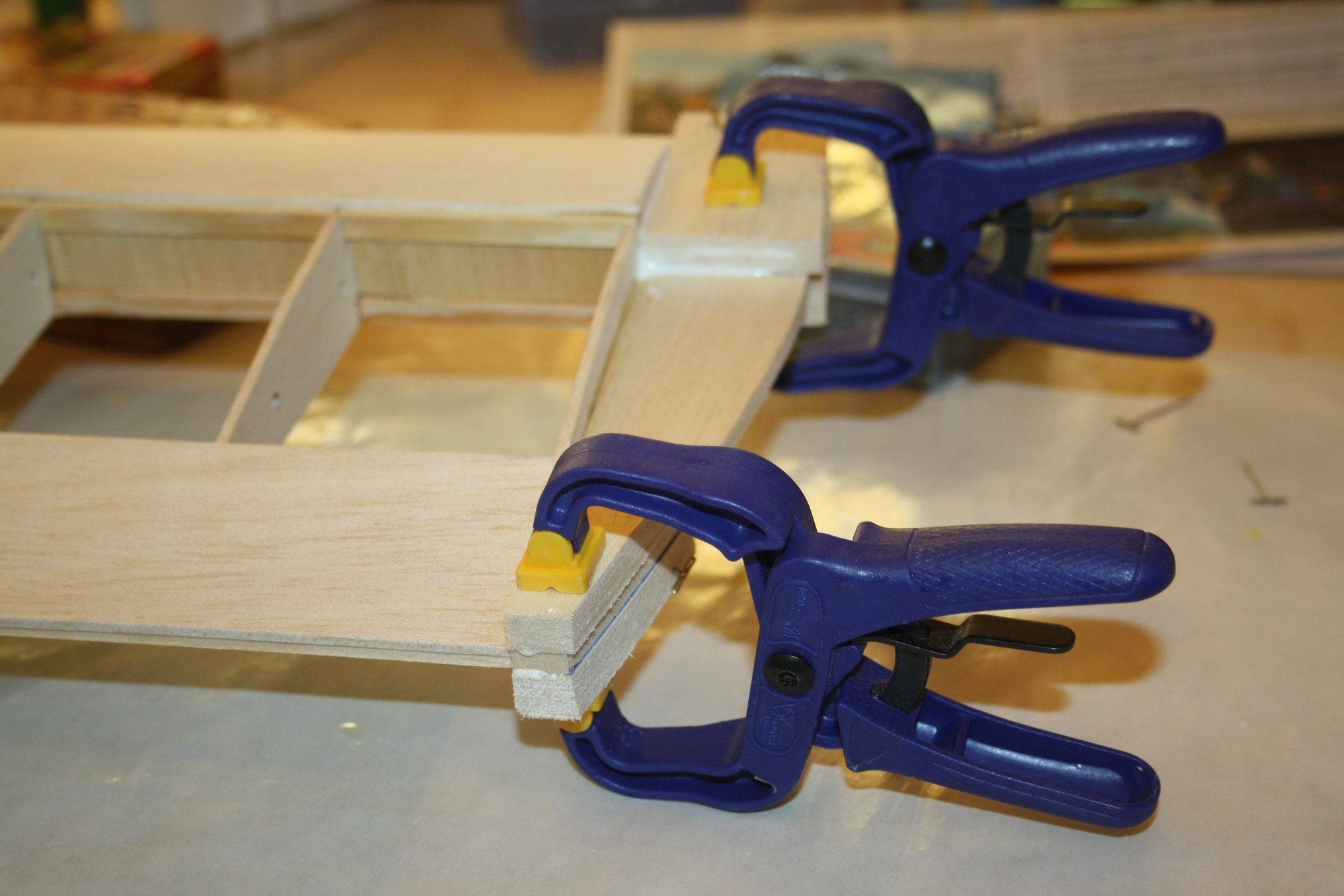

Very little progress today, I glued some balsa blocks for the wing tips.

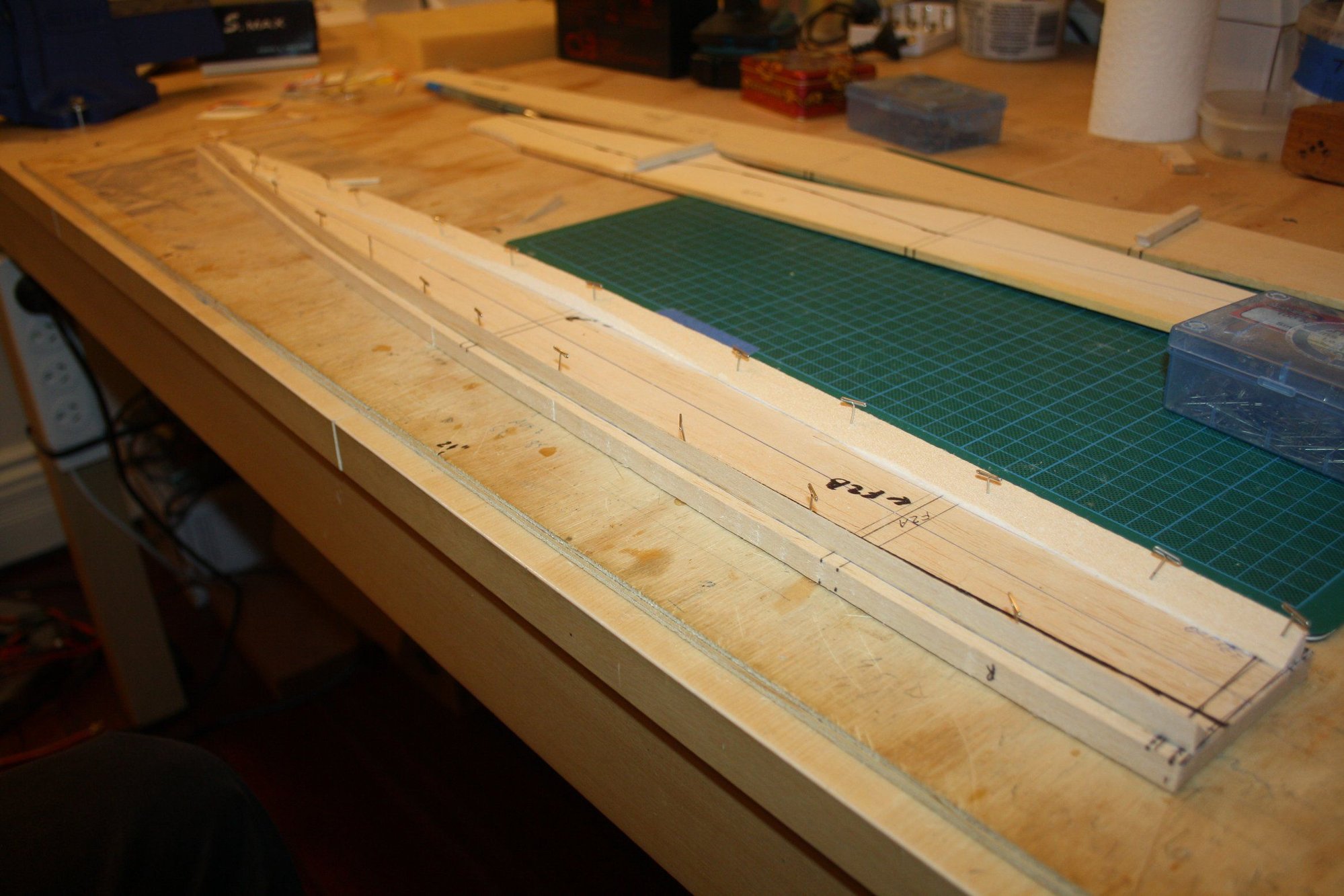

The wing tips now have all the balsa blocks in place ready for sanding.
I also cut and glued all the cup-strips.

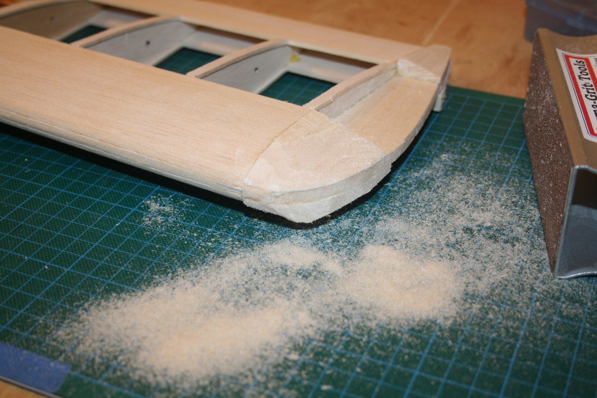

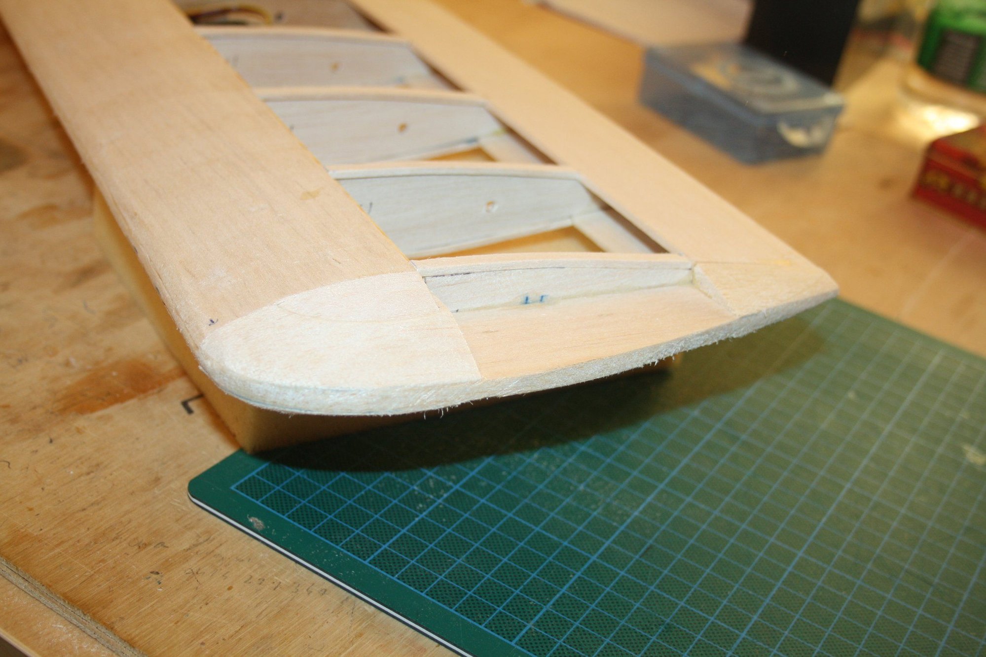

I sanded the wing tip balsa blocks to shape. I also glued some balsa strips nest to the servos so the covering will have something to hold into.
Next I sanded the whole wing as it is nearing completion.

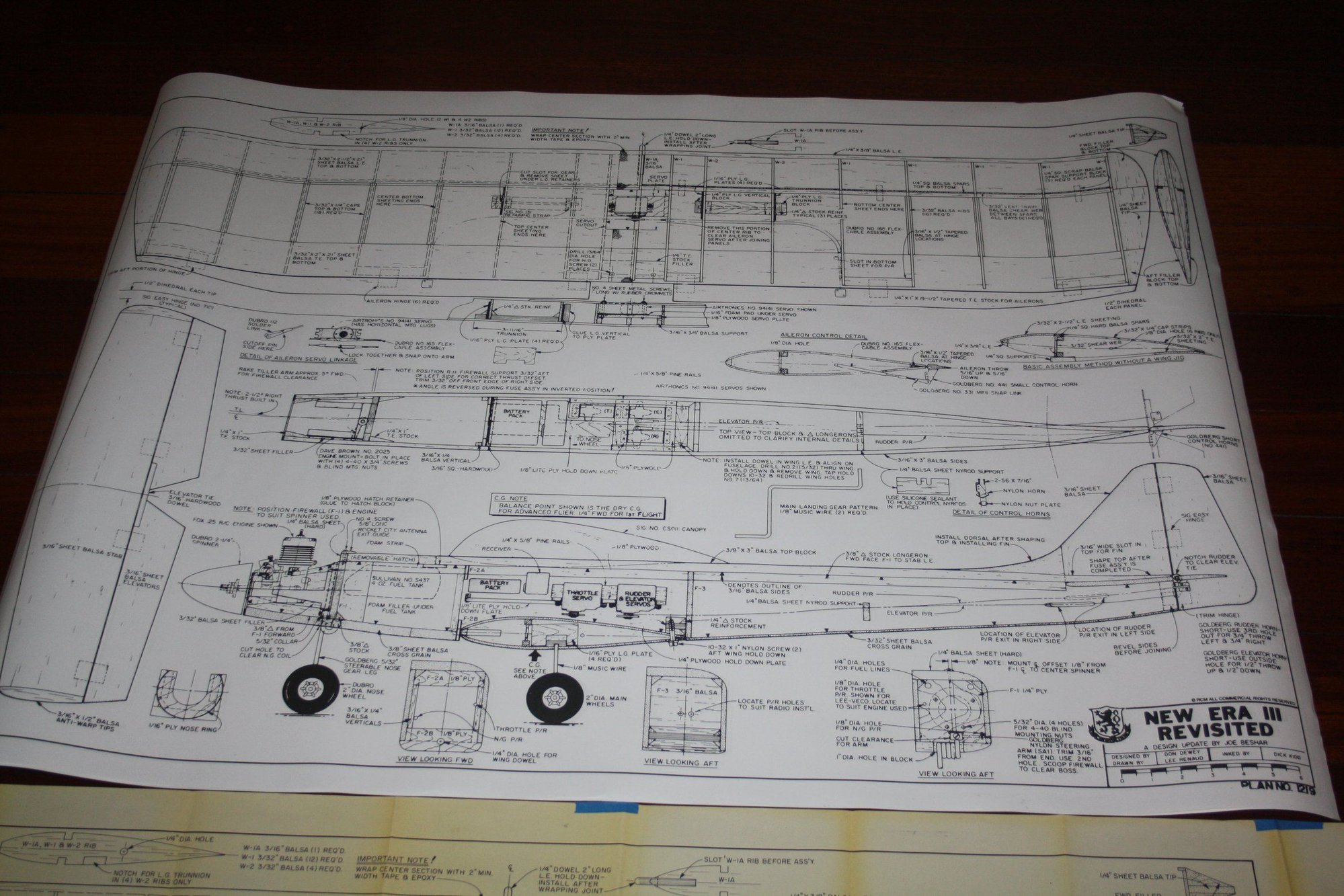

As I was studying the New Era III fuselage plans today, it became quite obvious that the O.S. 25FX (which I planned to use) will not be a good fit. The extension required to the nose will be excessive.I spent couple of hours searching the Internet for suitable replacement to the Lee-Vaco .19 and I am not yet sure if I have a solution. I decided to cut the sides with additional 10mm to have some leeway when a decision on engine is made.Then the fun of tracing and transferring the large sections onto the wood.
Cheers,

I'm curious as to what your search turned up, but I do have a couple of suggestions. The old OS Max 25 with the strap-on muffler was just as powerful with it's muffler as the Veco 19 without a muffler, and weighed about a half ounce more (w/muffler vs no muffler). It is short front to back, like the Veco. Of course, this is still much less power than the 25FX, but it is the power used at the time (when RC equipment was heavier).
Another choice that would give much more power (but still not as much as the 25FX) while keeping weight and size down would be the ASP 21 (8.2 oz w/muffler). I love that engine on the bench, but have not yet tried it in a plane. The old Irvine 25 (natural aluminum case) is quite compact and powerful (8.9 oz); the OS 25FP is the same weight, but less powerful. The Enya 30SS plain bearing is about 9 oz, VERY powerful (also very loud), pretty compact.
MA published a re-design of this model a few years back for the OS 25FX. Not only the nose, but the whole fuselage was lengthened.
Very nice work and a great project, thanks for posting.
Jim

Hi Jim
I was completely unaware that there was a re-design with the FOX 25 engine. This may be a game changer (I got the "revisited" RCM plans 1219 downloaded from Outerzone).
Since I didn't cut any of the fuselage parts yet, I may get the new plans printed and have a closer look.
My short research today established that the Veco 19 produced around ~0.35 HP, weight ~192gm. Length drown on my plans as 62mm and the engine mount width is drown as ~30mm.
I looked at both ASP 21 and the ASP 15. The 21 is too long at 69mm, the 15 length is good at 60mm and 145gm, however I could not easily find power figures for this engine.
Intriguing option is the Enya 15CX TN. It should be under 60mm long and is 26mm wide, Weight 155gm and is rated as producing 0.52 HP. I have someone at my club who has similar engine and I will ask for his advice hopefully on Sunday.
Again, thank you for making me aware of the "Revisited" version of the plans, it may just resolve my pain by building this version.

I got the "Revisited" plans printed so I can make an assessment of the changes.
The engine drawn is the FOX 25.
Distance from the firewall to the back-plate of the spinner is now 84mm compared with 74mm
Total length from back of spinner to rudder LE is 865mm compared with 858mm, which indicate shorter fuselage from behind the firewall?
I checked the wings to make sure it is not a distortion, and they are perfectly aligned.
Bottom line is that I already allowed for the 10mm extra with my side of fuselage traces. Tomorrow I will have an opportunity to have a chat with an Enya "expert" and hopefully he will clarify some of my questions regarding the use of an Enya 15 which I can purchase new and should fit.

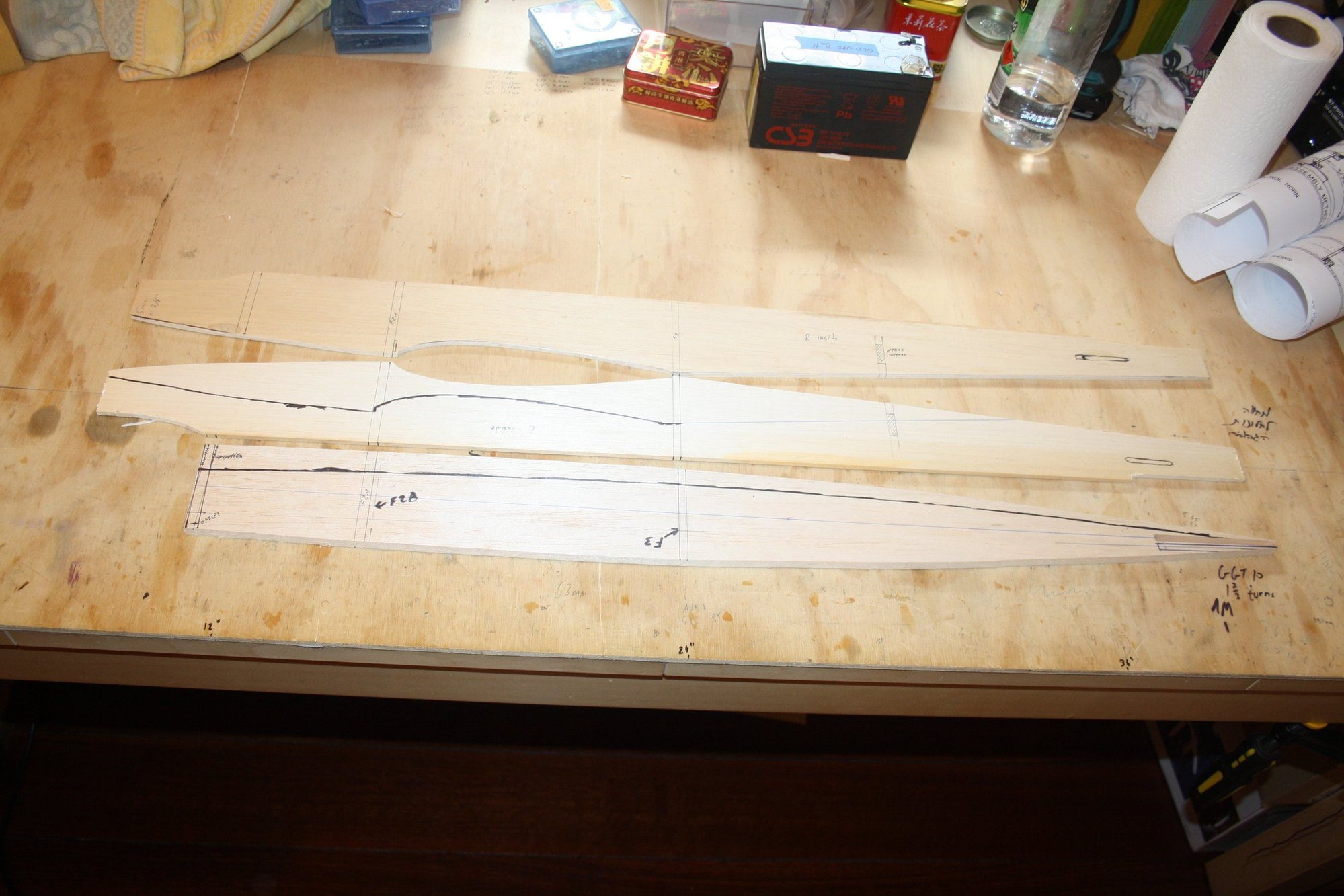

I decided to use the "Revisited" plan for the sides and top parts, taking advantage of the extra 10mm from the firewall already drown. I added below photos showing the difference.
Using the balsa I already traced when considering the original sides and top, I glued a cutting of the plan with a spray glue and made some dust in my Cave.

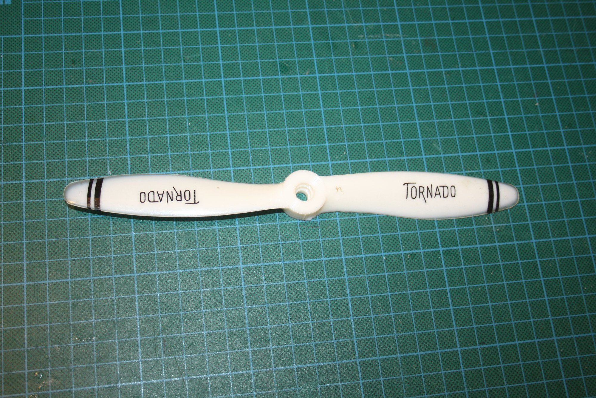

My friend Brian got me this Tornado 9x4 prop in its original package which he had in his shed for the last 20-30 years.
I kept with preparing a "kit" by cutting the formers. I made the firewall out of two plywood sheets to get the correct thickness.
I drilled all the holes and had to "make a start", so I glued the first couple of items (the supports for F2A and F2B) to the fuselage sides.

I got the blind nuts for the engine mount glued to the firewall, and trimmed the engine mount a bit to allow the engine to sit properly. In a hind site I took too much off...
I also drilled pilot holes for the "sheet metal" screws that will hold the engine to the mount.
I then tapered the top of the formers to accept the 3/8" triangles, and while at it, I cut a taper into the support for F2A and F2b which I glued into place yesterday. Oops...
Finally, I glued the 3/8" triangles to the top of the fuselage.
