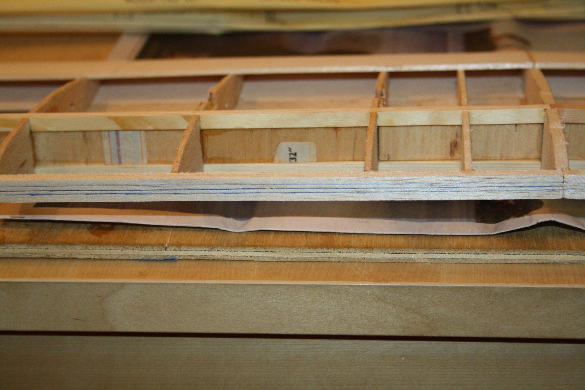

I made a plywood template for the ribs and went through my box of off-cuts to use what is available (and suitable).
Then I pulled a sheet of balsa from my pile. To my surprise it was a Keil Kraft branded sheet... Must be over 40 years old. I got some balsa from a friend couple of years ago and this must have been in his possession since.
All ribs are traced, I am ready to create some balsa dust.

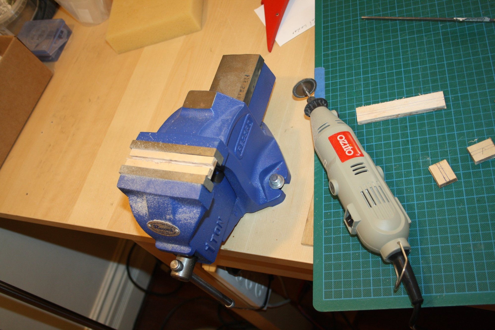

Cutting the ribs

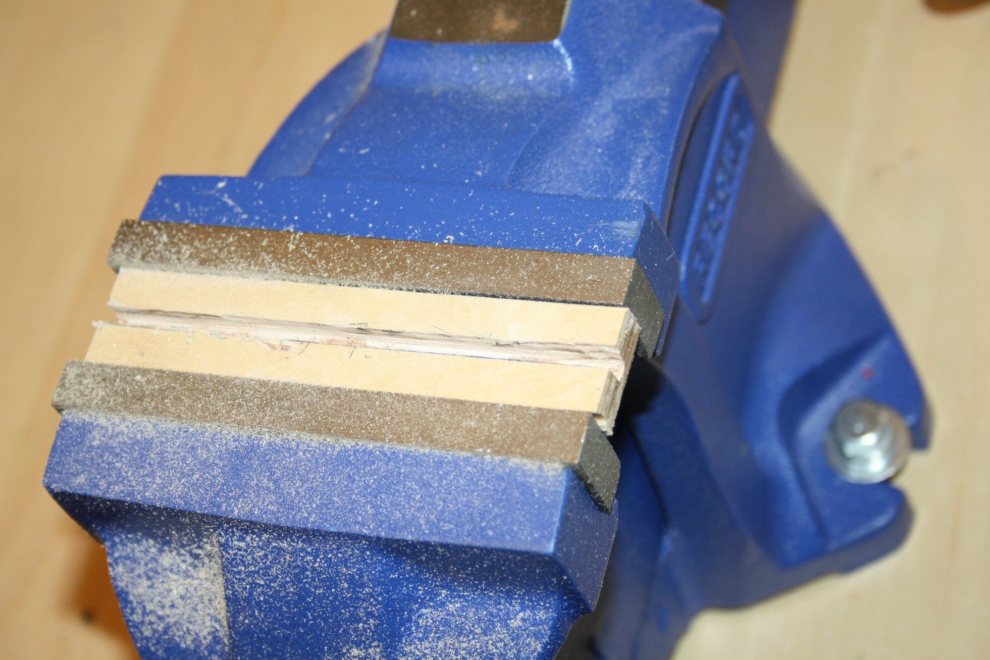

Since I do not have 1/4" plywood at the moment in my Cave, I cut the landing gear mounting plates from thinner plywood and will laminate them.
Eran

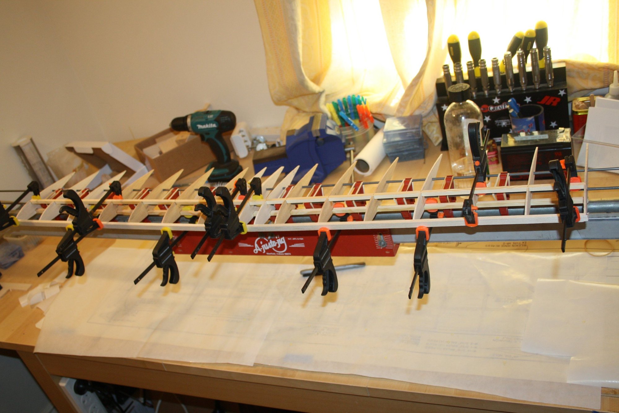

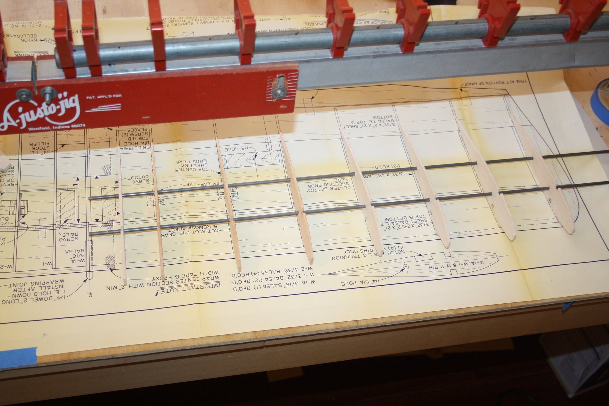

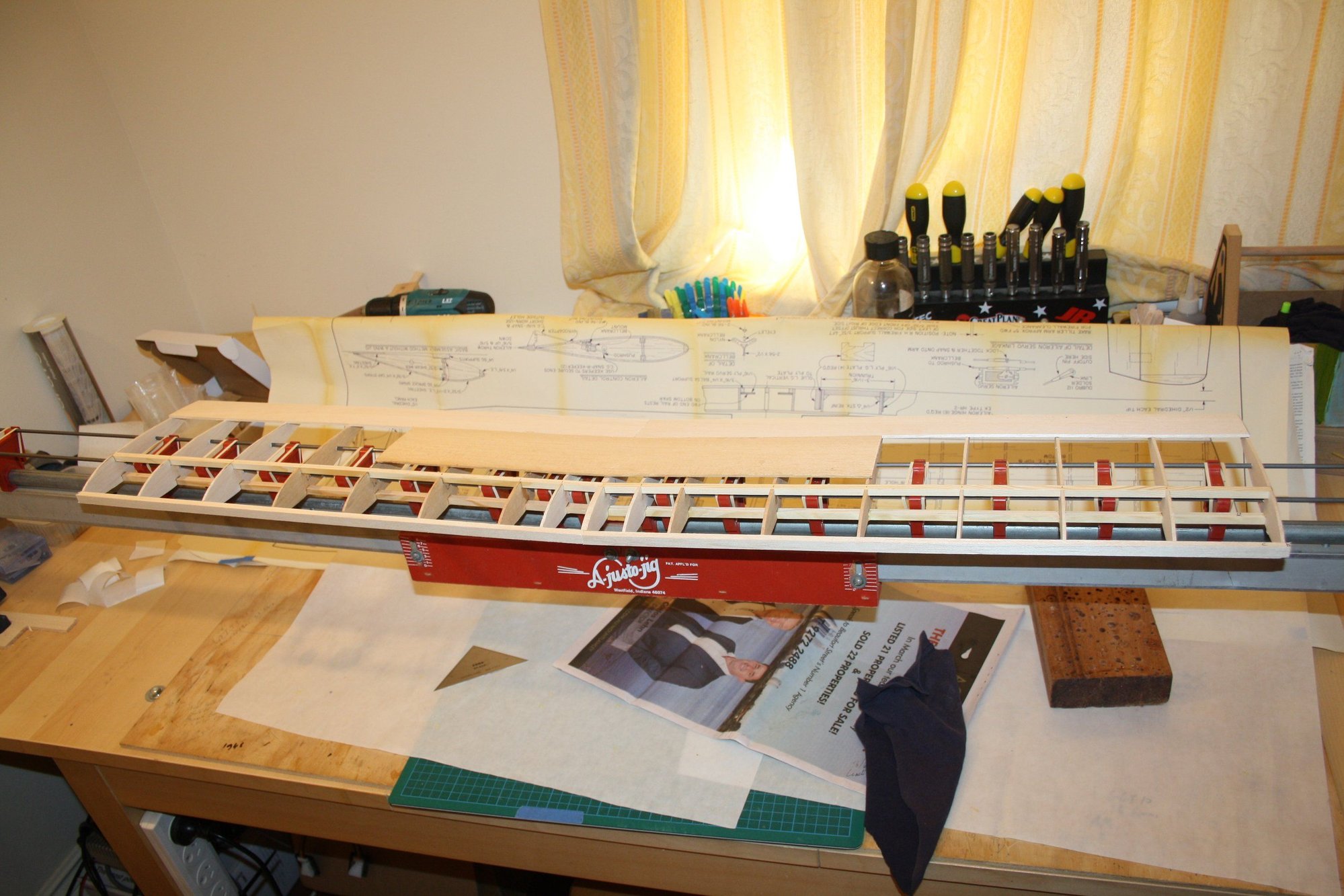

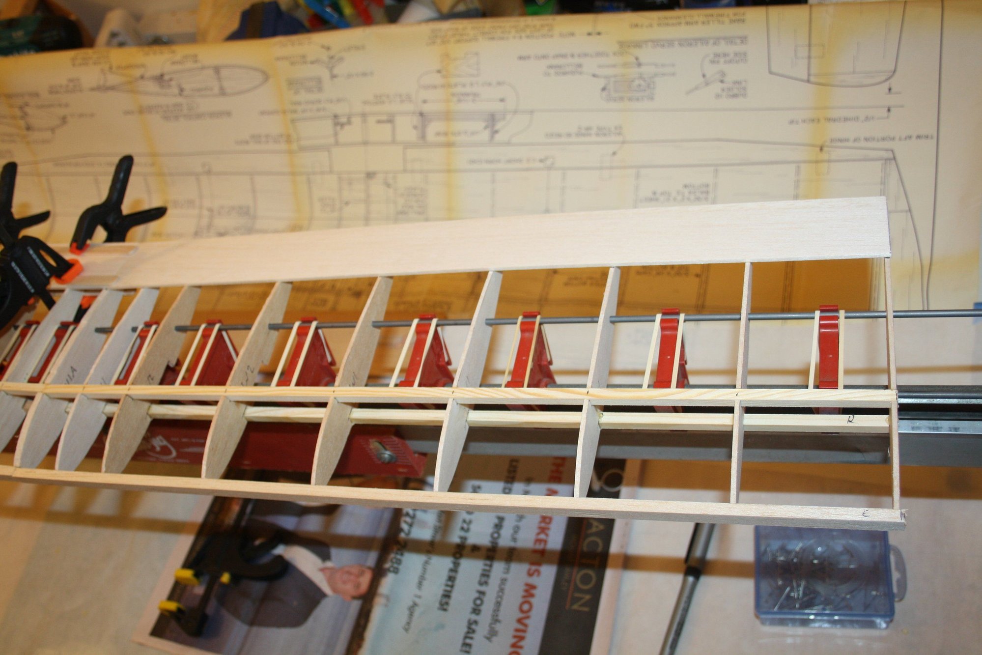

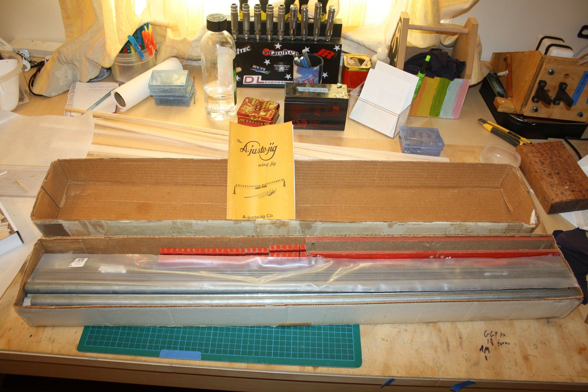

I set up the "A-Justo-Jig" on my table with the wingtip dihedral of 1/2" (always a pain in the backside to do).
The ribs were skewed onto the 5/32" rods and the rods were strapped into position with rubber bands. Then I was re- checking alignments and centre until was satisfied that all is as aligned as I can have it.
When all was done, the top spruce spars were glued into place.
I have some problems with posting photos at the moment, I will try again in few hours.
Eran.

Finally, the photos...

Bottom spar and Leading Edge glued into place.

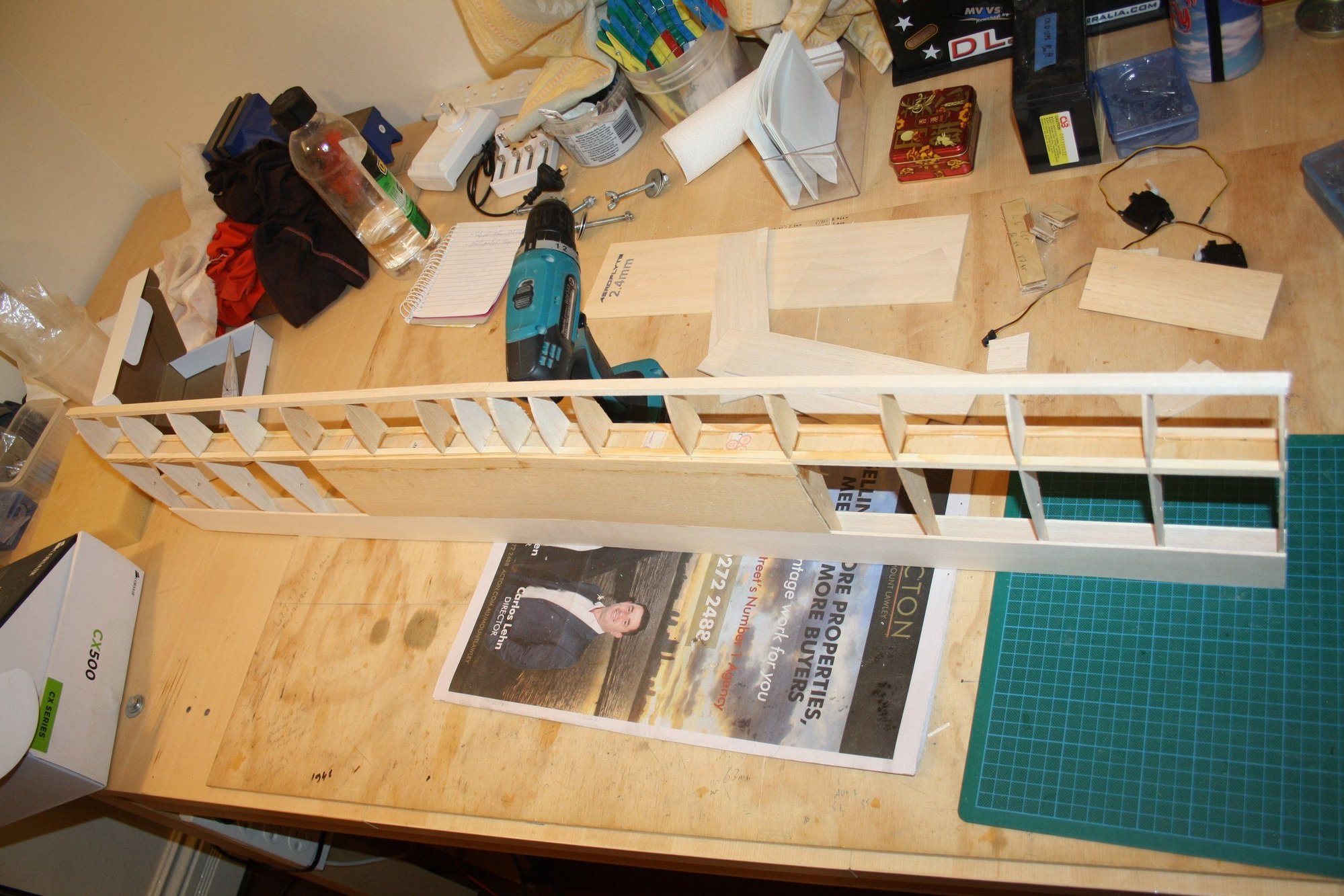

I had to get to get the jig off my build table due to some urgent work on another aeroplane, so I got the top TE sheeting and top centre section done and removed the wing off the jig.

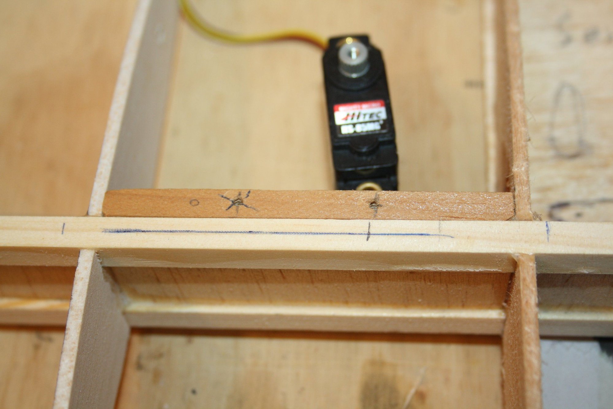

After much coffee and thinking, I think I have an idea how I want to mount the servos in the wing.
The servo will be mounted to couple of spruce rails with the top portion of the servo protruding under the wing from small section of extra sheeting.

I completed the installation of the ailerons servos.

buzzard bait - I used the A-Just-O-Jig one before on my Kwik Fli III build and was so impressed with the resulting wing that I had to borrow it again for this project. It is such a shame that no one makes a modern version of it, but with 3D printing becoming very affordable, making such jig should no be too difficult. It is on my "one day" projects to do.

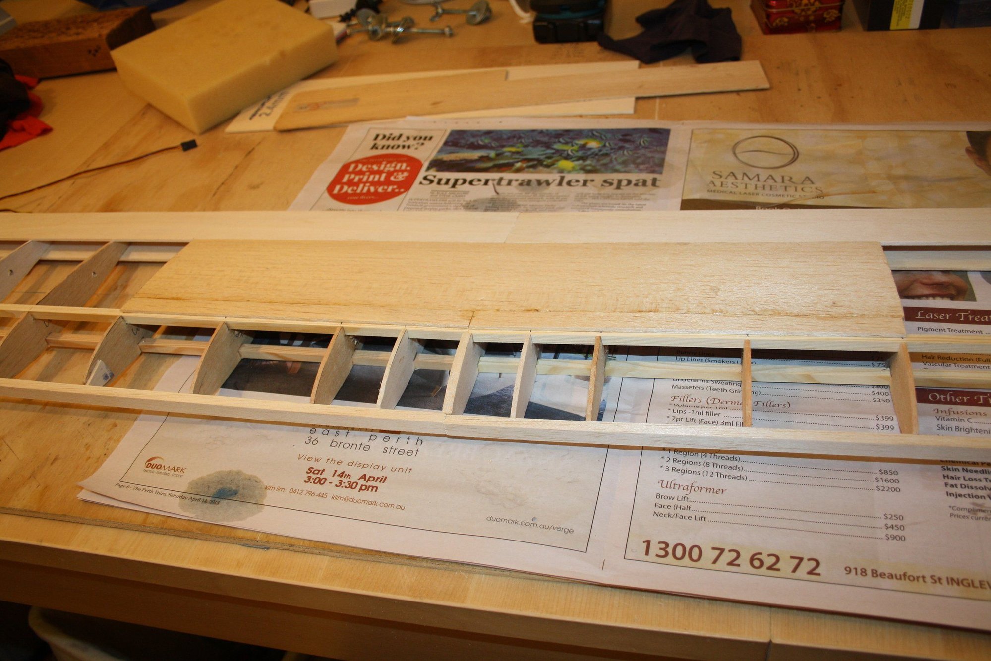

More progress and some setback.
I added here a photo of the complete centre section sheeting.
Today I sanded the D-Box sheeting at the leading edge. Then I opened the plans again to look at what else need to be done.
I suddenly realised that I didn't place the 1/4" sheet in the area where the wing bolts go through. I fixed this by cutting a square in the top sheeting and packing balsa sheets. I then sanded back to shape.
Eran
