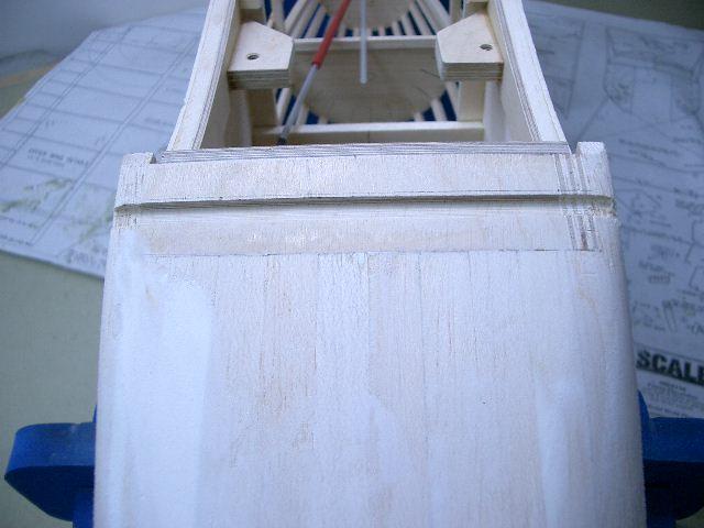

Default RE: Fairey Flycatcher
a channel was cut into the 1/4" ply landing gear plate to accept 2 1/8" wires. it would have been much easier to have created this channel during the build up phase but i just didn't think about. the plans call for homemade saddle clamps that clamp the wires down onto the ply but i thought it better to have them captured in the ply plate.
so the gear is down to the last wire. unfortunately, i ran out of 1/8" wire.[:@] the last piece will go where the balsa strips are in the photo. (the straight wire in the ply channel will actually be the axle, it's just there now to help hold the other wire in correct position.) so i'll continue when i scrounge up some 1/8" music wire.

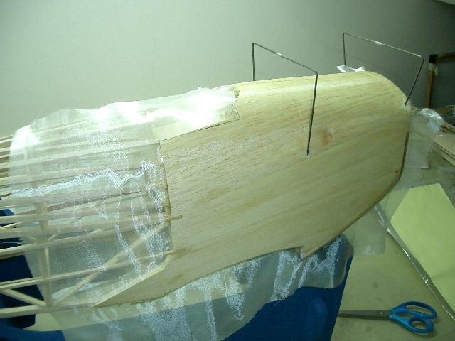

i've also started on fiberglassing the forward fuselage section in prep for covering with Flite-Metal. just the bottom for today.

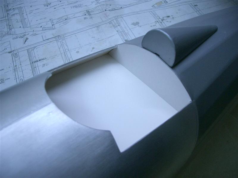

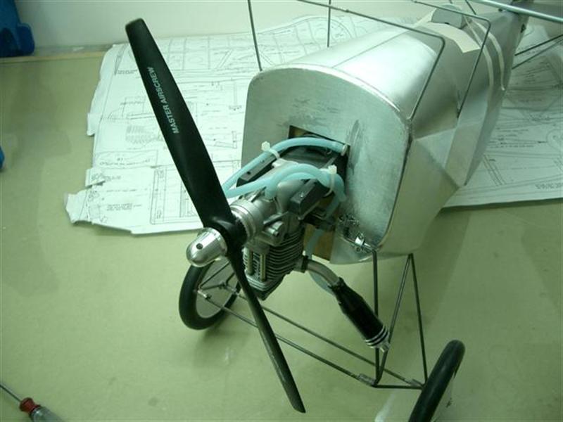

installed fuel tank and engine. pretty basic stuff but i thought i would show a little trick for those that may be interested. i cut the fuel lines pretty much the length i needed before passing them thought the firewall but then i had a difficult time reaching them. so i used a bamboo skewer inserted through the fuel line holes and into the fuel tubing. then i just had to slowly work them them through the holes with a slow rotating motion.
pic 2: OS52FS installed. yes, no dummy engine yet. i won't make that until after the maiden and i know she flies well enough to put the effort into it.
pic 3: added a smooth card paper cockpit floor and backrest. also, covered and glued in the headrest fairing.

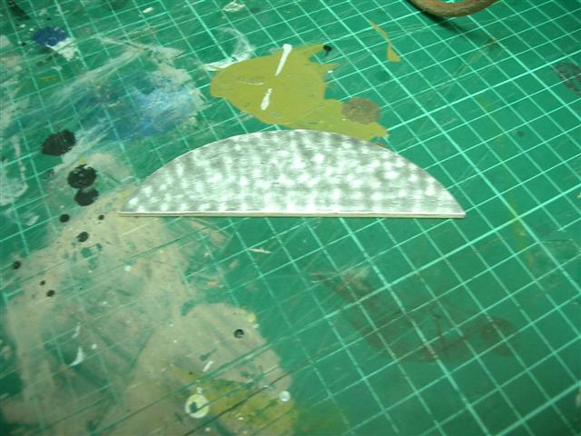

added a simple dash of flite-metal over a balsa base. then using a scrouring pad and pencil i made circular swirls trying to simulate the original. then used some store bought instruments that i just glued on. not much but better than nothing.

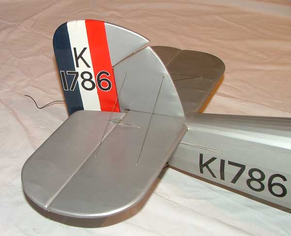

well, i think i have her as far as i'm going to take her until after the maiden. i think i'll still paint the N-struts and the cockpit. if i have some spare time not working on anything else i may add a few bits. if the maiden goes well i'll add the overall scheme, landing gear fairings, dummy engine and maybe a few other things i can find.
weighed her today and she came in right at 6 pounds (2.7 kgs). and almost right on cg. i'll still have to add a little less than .5 lb to get her to balance but i'm happy with it since she has a fairly short nose moment. when i do add more details i'll be sure to post.
