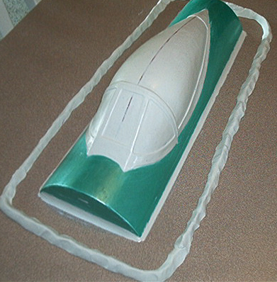

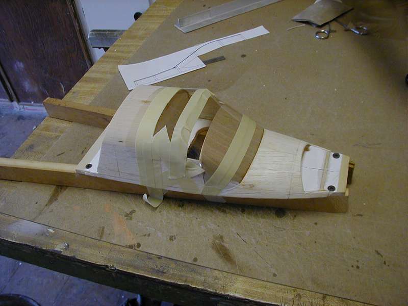

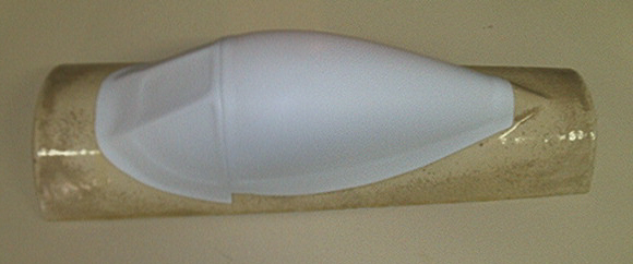

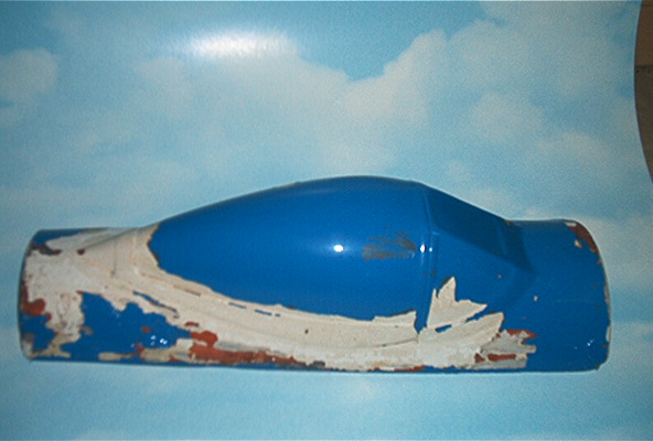

Saw some posts on forming a canopy, so I thought I would post my experiences in trying to form the perfect canopy! If any of you know me then you’ll know I am a perfectionist, it can be miserable because NOTHING is good enough! This may help some in their quest for a truly clear canopy. If you are happy with something that looks kind of clear then make a plug out of anything you want and get forming! For others that want to make a canopy that is of a commercial quality, it can be done in your kitchen. With some luck and paying strict attention to the details, you can do it. I needed a canopy for my current project, an F2G Corsair. I redrew the Royal Corsair plans with all the changes needed for the conversion.
I used PETG for this canopy, very strong and forms well and it can make a very clear shiny canopy if you have the proper plug. I have used .030 and .040 PETG, they both work well, use .030 for the smaller stuff. I get my plastic locally from Piedmont Plastics [link=http://WWW.piedmontplastics.com]Piedmont Plastics[/link], it comes in sheets .040x48x96 for $21.76 each. When you consider that Lone Star Models sells a 12”x24” sheet of this for $3.75, that would come to $60! I can make 16 canopies for $21, when you first start though you won’t make 16 usable canopies!

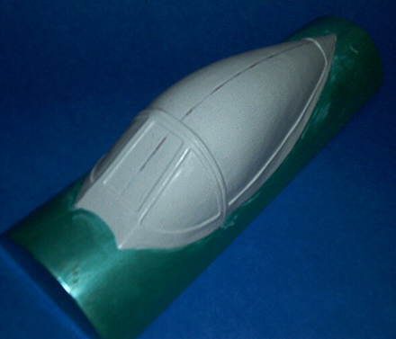

1. First we have to make the plug, I prefer plaster because it is easy to work with. Here is how I make mine. I first make the top of the fuselage with a 1/16” ply piece stuck in the top that has the profile shape of the canopy. It is then covered with Monokote and the canopy is sculpted in clay. This allows great freedom to make changes until I am satisfied with the final shape.

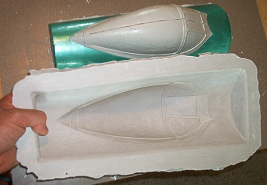

2. We need to make a mold from this clay plug to make our final plaster one. I made a small dam around the sculpture, sealed the base of the form to keep the plaster from going under it. Cover this with a thin coat of plaster, I like to brush on a thin coat and then dip paper towels in the plaster and lay them on to build it up quick.

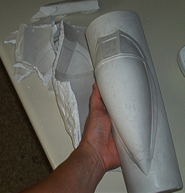

3. When you pull the plaster off of the clay form this is how it should look if you did it right. Grease the inside lightly but completely with Vaseline and fill it with plaster.
4. When that dries just break the mold off of the plug, that way it won’t get damaged.

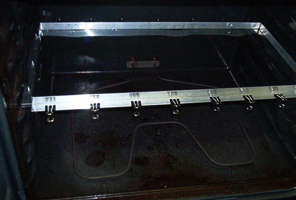

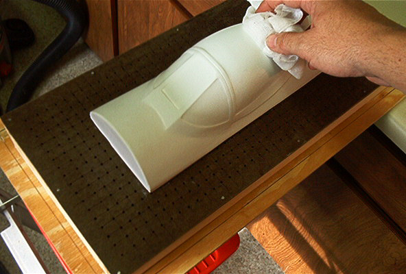

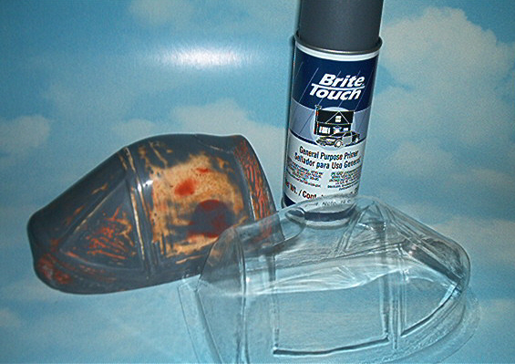

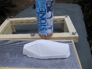

1. This is how my plug looks ready for forming, at first I covered the whole thing in styrene, but I like to have an edge for cutting that shows up well. This plug is covered in resin, but it is not necessary, you just need to form .040 styrene over your plug first, this is ONE of the keys to a totally clear canopy. Form it, cut it to shape then spray the back with 3M spray adhesive, then carefully stick it to the plug. Give it a good wet sanding with 600 grit sandpaper, this is a very important step, it has to be smooth.. NEVER use anything on the plug, don’t touch it with your greasy fingers either!!! Let it sit for an hour after sanding to make sure it is totally dry in the area where you will be forming your canopies. Don’t let it dry outside then bring it inside and start working on it, the temperature change could cause moisture to form. ANYTHING on the plug will cause it to be a bad pull.
2. You will need a tack cloth and have the wife do a good job on cleaning the stove, when you pull the protective backing off of the plastic you will be amazed at all the crud it will pull out of thin air! Or how the smallest piece of fly dung can totally ruin your otherwise perfect canopy! I wipe the plug down good and also the plastic.
3. When making things with white styrene the placement in the oven in relationship to the heat source is not an issue, but that’s not true with clear PETG! I use the broiler to heat the oven, turn it on and close it so that the oven will get heated up. Put the plastic in about the middle, if it’s to close to the heat it will melt to fast and holes will form very quickly. Keep a close eye on it and when it sags about 21/2 or 3” it’s ready to go.
4. I like to have my 6hp shop vac already running when I put the plastic on the plug.

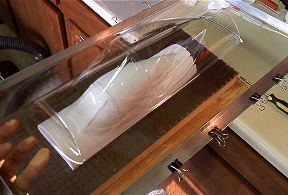

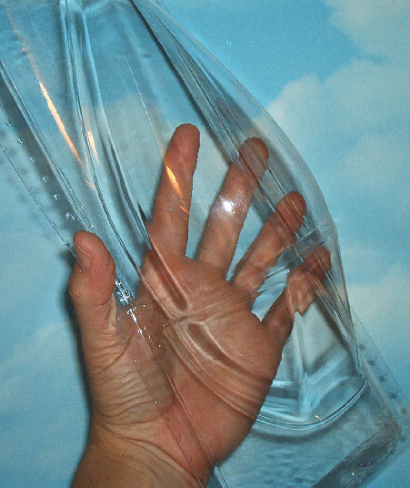

1. Let the vac run about 10 seconds or so but do not touch the plastic! It is still soft and you will leave fingerprints in it or make it uneven! I have not had it stick to anything at all, just pull on one side then the other, out away from the plug and it will pop right off.
2. It’s hard to demonstrate clarity in a picture, but this is a finished canopy. I’m very pleased with the results, good luck with your projects!
Dion

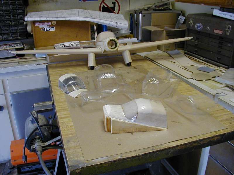

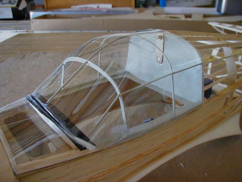

Dion. From the looks of your plastic frame and fasteners, we might have read the same book.
This was my first attempt at vacuum forming. The task was a challenge, but the results were gratifying. I glued up the flat pieces, turned it upside down, filled it with plaster, shaped the "dome" and pulled the plastic. Instead of molding the frame into the canopy, I pulled two canopies, cut out the "windows" in one, painted it and glued it in place.

Good question Kelvin, in my experiments if you pull .040 white styrene over the plug and sand it, then glue it on with 3M spray adhesive it will last for up to 3 or 4 pulls before it has a tendency to bubble. If you get the PETG to hot and over the 120 degree working temp then it could harm the styrene you have on the plug. If you use a lighter PETG like .030 and .040 white styrene on the plug then you can pull as many as you want, I never found the limit and I made a bunch of them. It's when you have the same thicknesses on the plug and clear that you will run into problems after a few pulls.
The frame to hold the plastic, is that just Aluminum angle?
Does the depth of the Vacuum Box make a difference in making a good pull (4" depth is better than 2"?)
What is black on the top of you vacuum box?
YAT-28E I got the frame idea from Chad here on RCU, it's just aluminum angle bent and pop riveted, works great.
You should not make a deep box, the less air your vacuum has to take out the quicker it will draw the plastic. In fact you don't need a box at all, just a board with a hole in the bottom. You will need to use small sticks or something to keep the canopy up so it won't block the vacuum hole. Use weather strip as a seal. My box is about an inch and a half deep and it works great.
The top is 1/8 inch tempered Masonite, I took the time to drill all the little holes! It's important to have enough holes in the top for a good pull, also it must be supported from the bottom with some small posts.

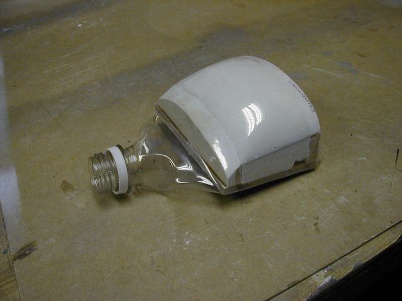

Speaking of Model Airplane News, there's an article on making cowls from transparent bottles. I was about to try this but I thought it better to look around before I did. The pics looked good, so after a while of open-cockpit flying I set it all up but, of course there's a "but", the bottle was too big. So instead I attempted to make a canopy for a P-40 (including the rear windows) using a method similar, in a way.
1. Utilizing a solid plug, any material, (the same plug I was about to use for the bottle thing) temporailly or permanantly attach it to a board that is about 2-3" wider on all sides of the plug (plug bottom fuz side down), lay a piece of plastic sheeting over the whole thing and clip it in place tightly.
2. With a heatgun on high, start melting the plastic over the plug, the plastic will shrink, the only real problem is that the corners overlap, I tried to fix it, but before I ruined it I stopped-still looked alright though. The less important problem was that the plastic was too thin, it broke before it ever got in the air.
3. Once the plastic cools unclip it and remove it from the plug. Trim excess and add frame lines. If anyone else uses this idea let me know if you get the folds out of it, also if someone uses the bottle idea either. Thankyou.

I didn't have any wrinkles, but I couldn't find a glue that would work reasonably, either.

Default RE: Vacuum form a clear canopy!
That "Radio Control Modeling in Nova Scotia" is a great site.
Also try "molding compound vacuum chamber" in Google.
I have used "Perma Stone" to make plugs. Available at local crafts store.
Is that stuff expensive and does it form a clear part? I have found that all that's needed is to use plaster and seal it with cheap primer. Make sure you wait a few days for the primer to completely dry, give it a 400 grit sanding. I can pull very clear parts using this method.
ORIGINAL: antonio104
diony:
Sorry I didn't read your first post closely enough. "...post my experiences in trying to form the perfect canopy!..."
The Perma stone is less than $10 a can to try, but looking at your finished canopy, not as good as your method.
I like it because it is a lot harder than plaster, ready to use the next day without coating and produces a not-bad result.
The missus is around so I have to wait awhile to use the oven to try to form a new canopy to take a picture of.
antonio104 is offline
