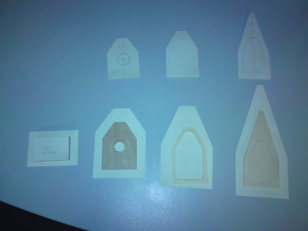

    Another 'HOTS' only bigger !
    I managed to build a 48" hots from an old crashed airframe at the end of last year, so a friend of mine has asked if i could build him a bigger one.
    After a short chat we decided to increase it by 50% which will take it to around 72" (maybe a bit bigger when you add the wingtips)
    I started off by cutting the scaled up size from thin card.
    When i built the small one i made a kit of parts for two, so all i`m doing here is scaling up from the second kit of parts of the small one, if that makes sense ?

    Used the card templates to mark out the front bulkhead and undercarriage plate. These are the only parts that are cut from 6mm birch ply, the others are from 3mm light ply.
    I was extra carefull with the front bulkhead being square as this is used as a template for the width of the rest of the formers including the undercarrige plate.
    Formers 2 and 3 roughly cut to shape using the card templates.

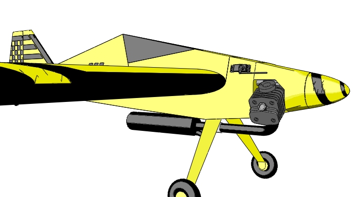

    Hi John.
    IΒ΄m also about to start building a Hots scaled up by 60%. Well, as soon as I get the parts from a friend that has promised to lasercut them for me...:-)
    A 60% enlargement would mean a span of 76,8in, but I have decided to dump the curved wingtips and clip the wing at 70,9in instead. Power will be an old 35cc Webra Bully running gas.
    What do you plan on using for power, and what do you estimate the final weight to be?

    Pics of my modified plans and planned paint skeme in pose #2 here: http://www.rcuniverse.com/forum/m_92...tm.htm#9243384

    For power my plan is to use a 'piped' OS91, as for the all up weight, i`m not sure, if it comes in at around the 12lb mark i`ll be very happy. All i can say at the moment is that the wing is very, very light at the moment.

    What width is the front bulkhead when scaled up to 60% if your planning to use the big petrol engine ?

    The maximum width of the front bulkhead is 110mm at the bottom which doesnΒ΄t leave much room for the engine, but it looks like it will fit... just. :-)
    I was planning on using a tuned pipe too but a friend had a spare DA 50 canister which should work out nicely, and be quite a bit cheaper than buying a pipe.

    Granted, it IS quite a lot of engine to cram into the cowl.
