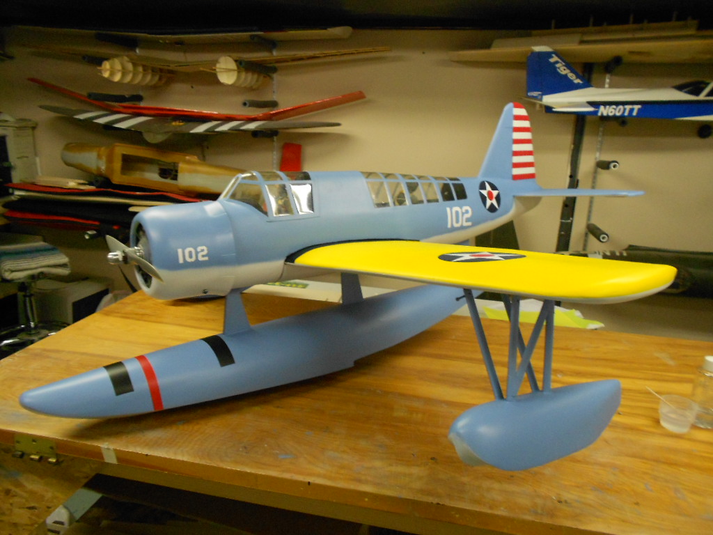

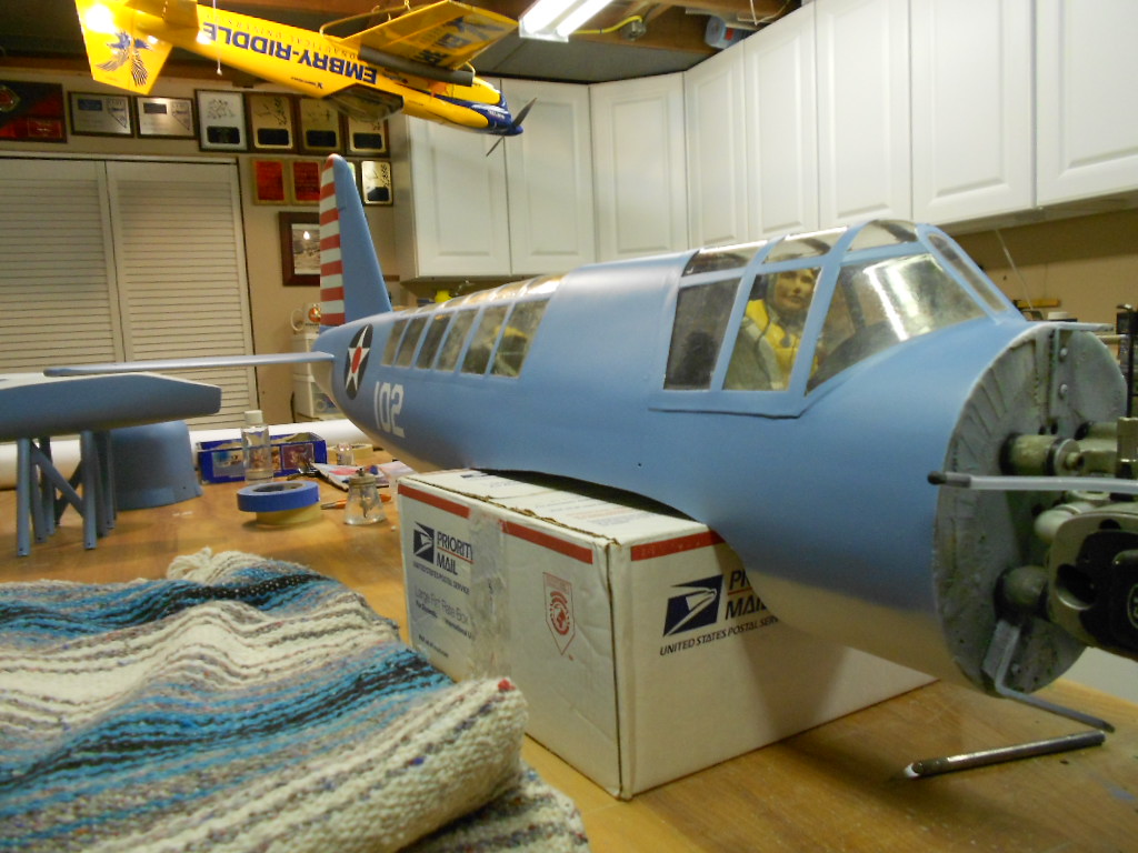

Shot a little bit of the clear on the tip floats and cowl this evening, this product sprays nicely out of the airbrush, and really grabs the flat and soaks in, you can tell it bonds well to the Behr flat, You just need to be careful to not over thin it, other wise it fish-eyes a little.
Also the Grey Paint I used was a Lowe's satin latex, not flat and it wanted to fish eye that too, but I experimented and knocked of the shine with some denatured alcohol when I shot the cowl,, it then went on fine. My conclusion is you want a flat or sanded surface, you wouldn't want to shoot this over a gloss finish without sanding first.
I plan to spray the rest of the plane tomorrow,, I like the satin sheen it produces,,
Edit: shot the wing, fuse and main float today while I was shooting some shelves and drawers in the garage, back and forth Lacquer to Water Borne..
I must say I'm really liking this water borne system material, it took a little getting used to to find the right amount of thinning, but I was able to spray the whole plane with the airbrush. Which is huge because you waste a lot less paint that way,, even with the touch up gun you loose a good percentage to over spray and what left in the cup. The whole job, which was 4-5 very light coats of clear only used a little over 2.5oz of paint.. a little goes a long way if you're careful.
I'll put it back together tomorrow for finial pics,, I want to let it dry over night

When I put the cowl on I realized I filled the hole the needle valve extension goes through,, LOL
Also, I my end up adding a couple more light coats of clear to top wing surface,, Look just a little thinner than I'd like.
She needs the muffler, fuel tank and a couple new servos installed, but she is close to RTF
I think she looks pretty good considering the quick/economical face lift I gave her,, I think I can be proud to bring her out to the float flys again.

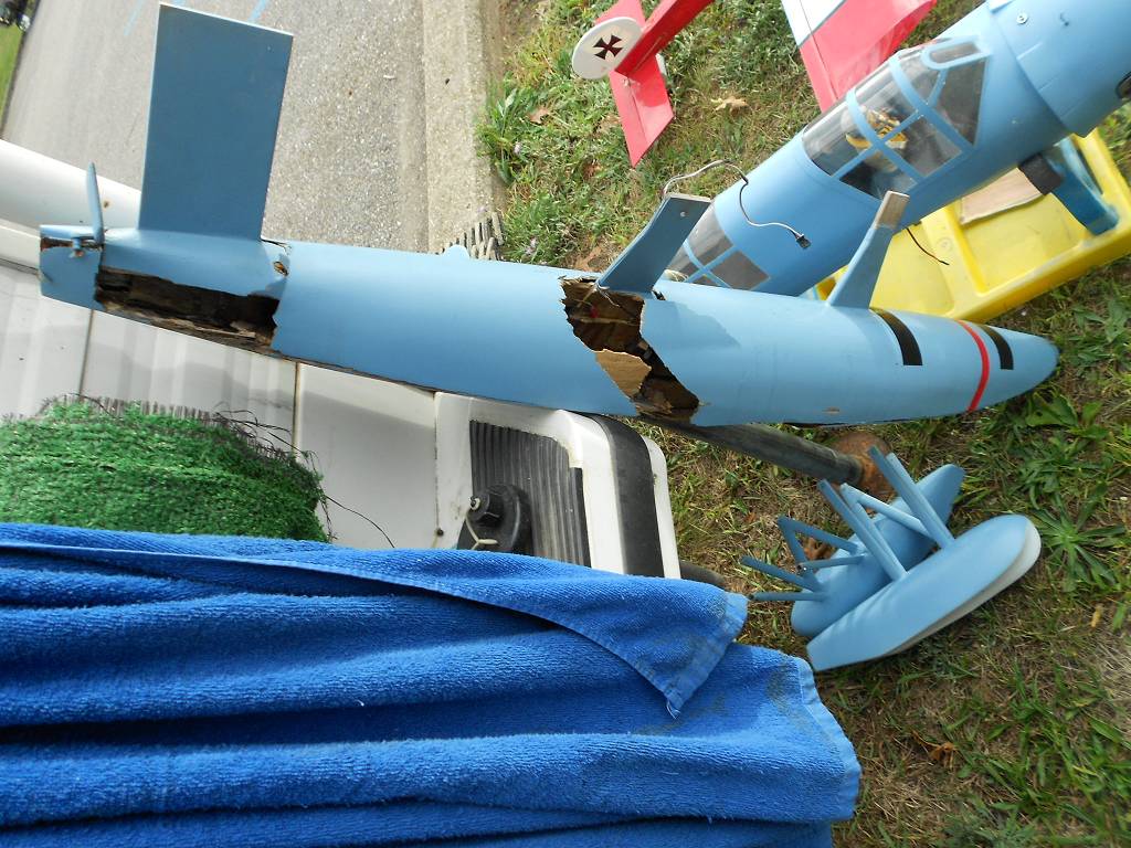

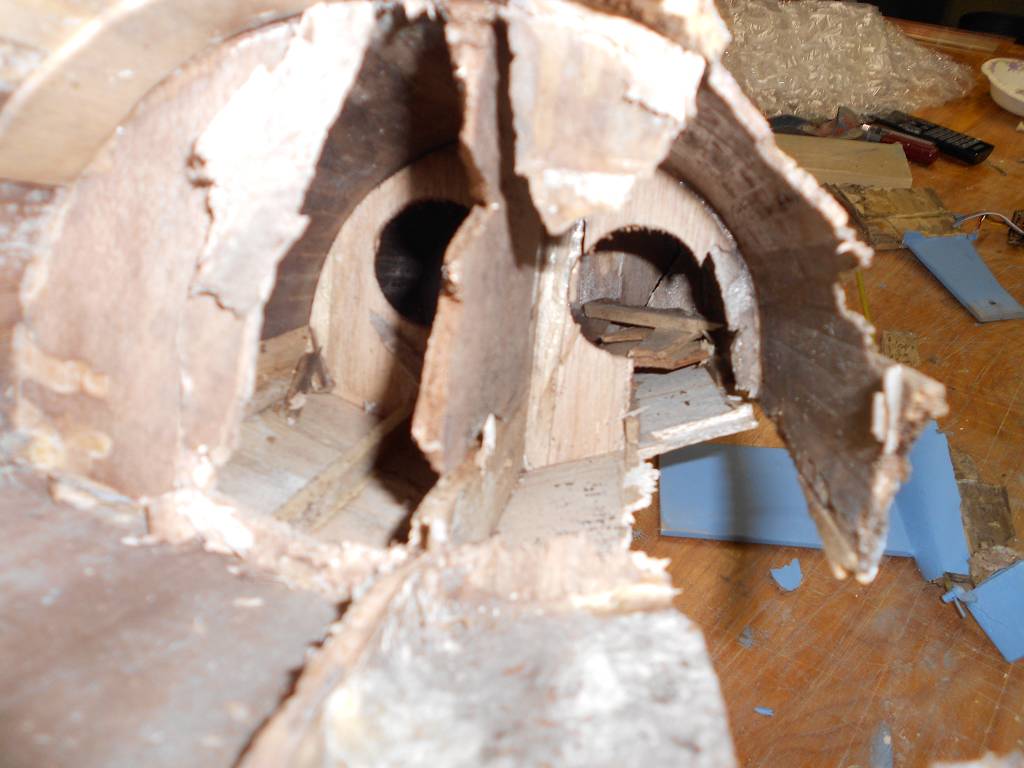

Engine out,, no airspeed [:@]
Exposed are the years of minor water damage adding up, The rest of the plane only had minor damage. The plane just won't die

That black rot sucks![:@] My H9 Super cub has the same issue on the floats I made. Was it just the float damaged? If so, I'm sure you're going to make a new float. Maybe you can make the water rudder work on the idea that mine does down through the rear strut with a torque rod. Every float with a servo in it seems to do this eventually. Hope you get it back up.

Yeah, I think the years of rot really weakened it,, years ago it would have taken a hard landing like that one and laughed..
We will see if it goes again,, but don't be surprised if another wild hare runs up my butt and I fix it

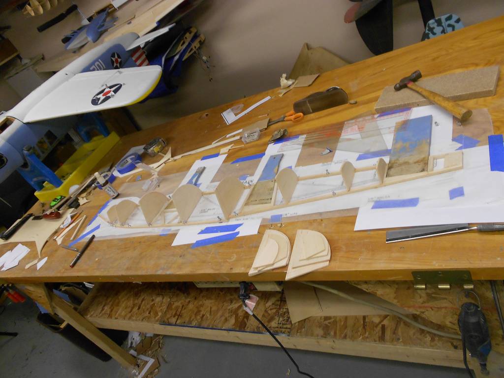

Couldn't leave it dead on the shelf,, Digging into to it reviels pretty bad dry rot
Bad news is after I tore it apart and cleaned up the ply parts I remembered I had thrown the plans I had drawn away 2 years ago because they were damaged in the basement flood,, I'll have to redraw the plans

Looks like a boat load of weight there! Is that mahogany you made it out of? Funny how that rot almost makes balsa like driftwood.

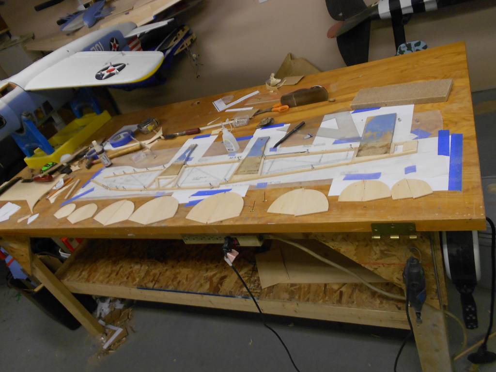

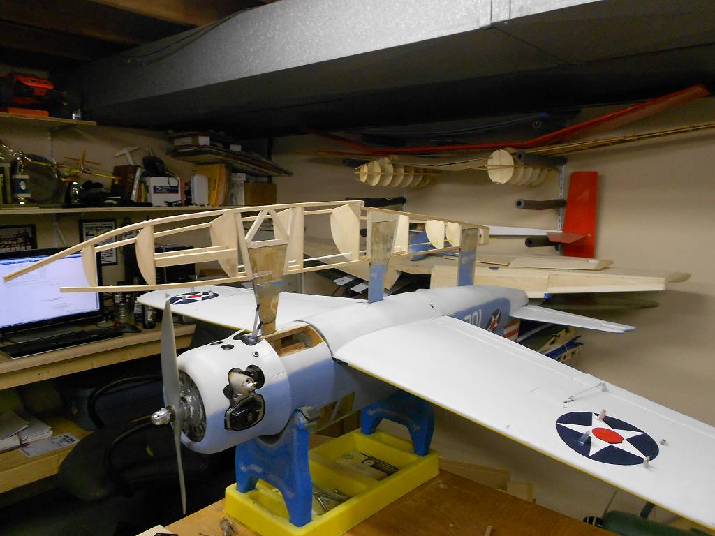

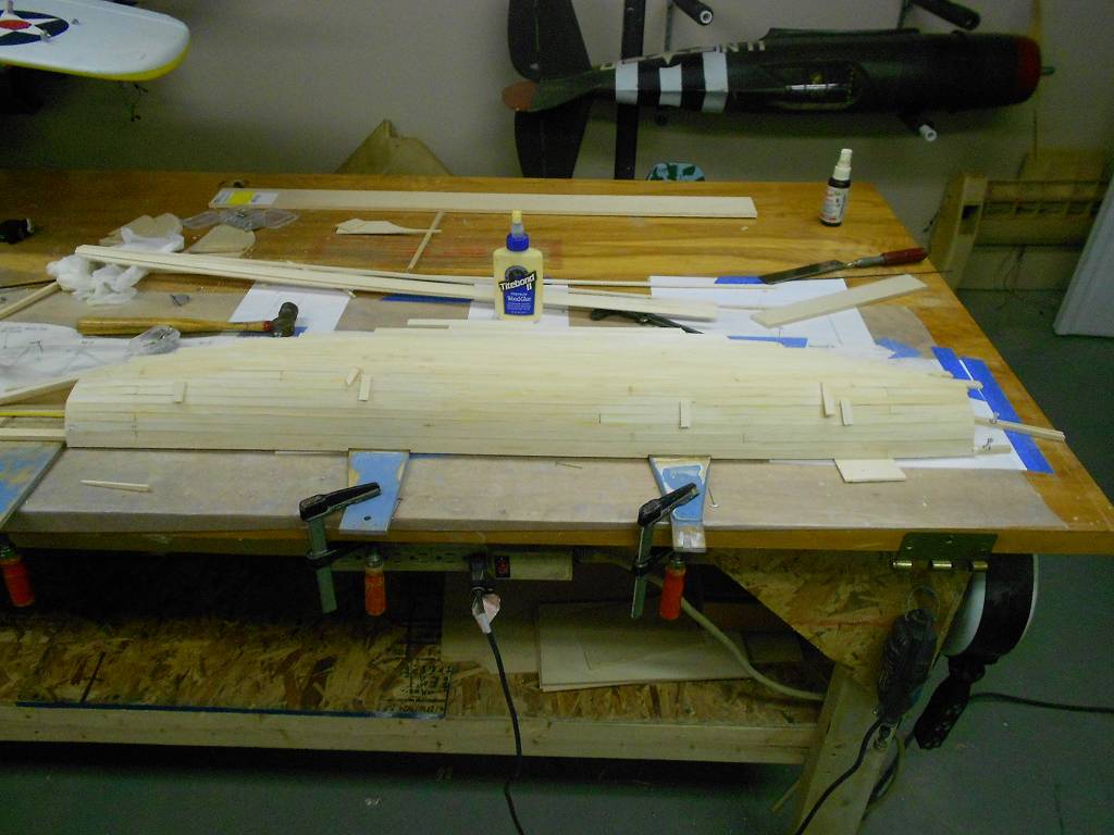

Started gluing it up
I used scrap to hole the support pieces aligned
The original float had a solid 1/4 keel, decided to use a framework this time,

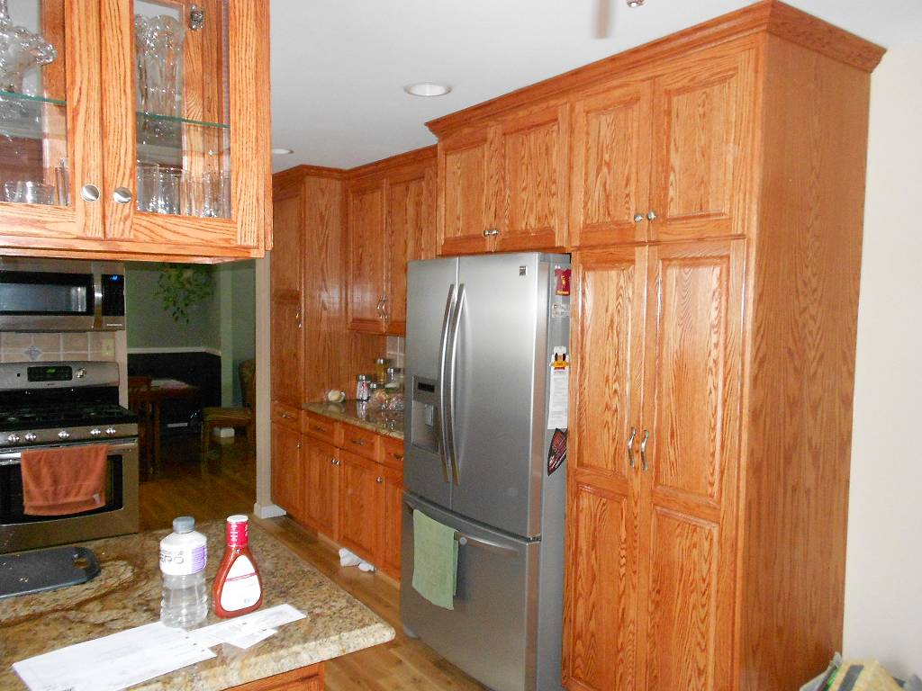

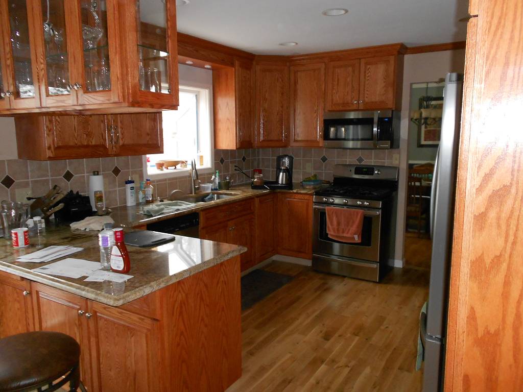

Thanks guys,,I just realized I never updated you on the kitchen,, I had a pretty stressful year, but did get it done,,, ok 99% done
Actually testing the changed resolution settings on the camera too,, uploads were ridiculously sluggish,, looks like it's working better

A little more work then took it off the table to make sure the legs were aligned still, after confirming that I pinned it back down and sheeted the bottom,, after the bottom was done, I flipped it around to make the top/side planking easier..
Taking a dinner break

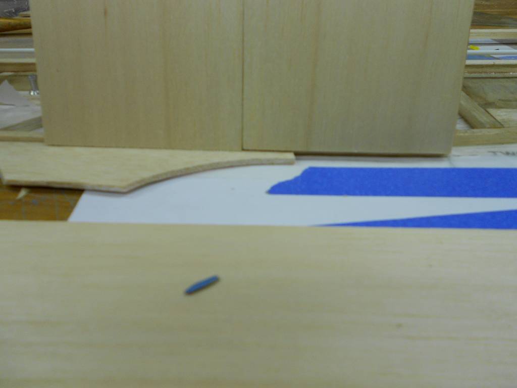

Using tightbond wood glue and CA at the formers for the planking, I'll have to let the planking dry overnight before I can start on the other side
