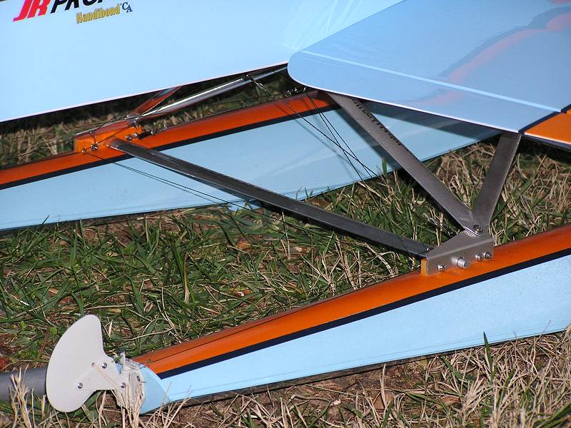

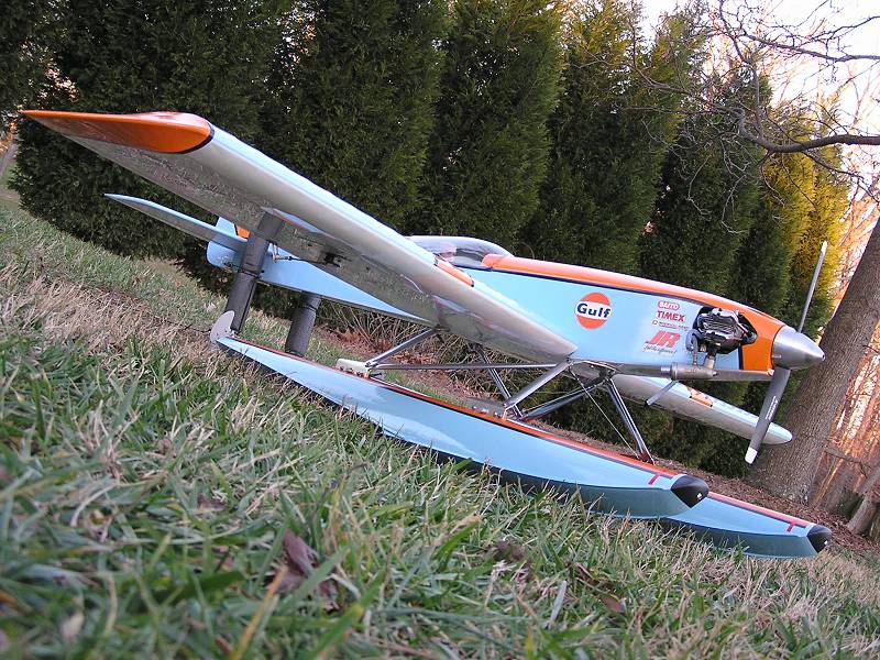

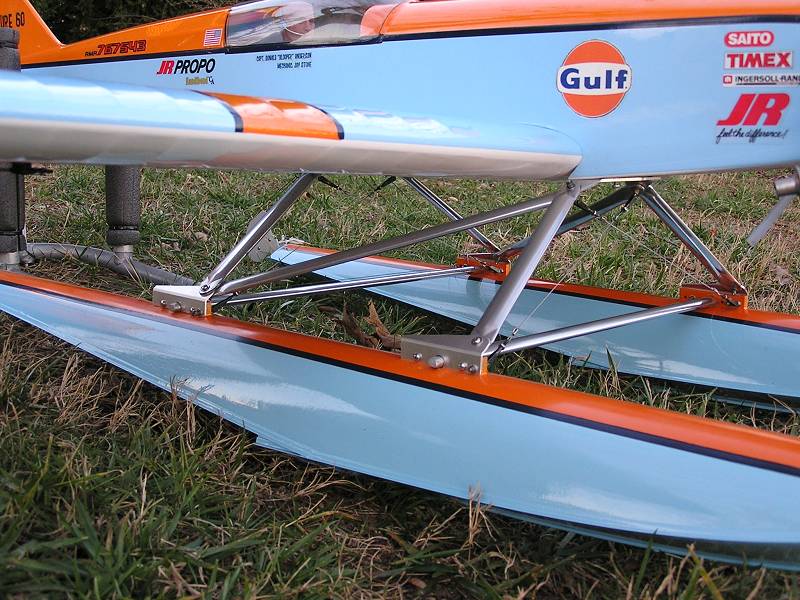

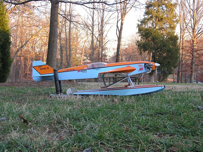

Here are a couple of pictures of my first float plane. I finished my Venture 60 in the spring of 2005 and put around 70 land based flights on it last summer. This past fall I purchased a foam core float kit from Niagra Custom Model Products and here is the result of my conversion. It has scratch built aluminum struts, retractable dual water rudders, and scale-like rudder rigging. Power is Saito .80. First flight off of water is to be tomorrow morning, Jan. 29.

Yee haaa! 2 Flights, no problems! 4 touch and go splashes. Floats and plane seem to be a perfect match. I can't wait for better weather. This morning the wind was 15-20 mph, starting to rain and 55 degrees, other than that it was perfect. At least the water was not real choppy. The dual water rudders made taxiing very easy even with the wind. Take off was effortless, no prop splash, just a very smooth and quick departure. Also used flaperons for the first time today. Set them about 30 degrees down and in the breeze we had today she would land at a walk light as a feather. Float flying- I'm hooked!!!

Thanks for the compliments. As for the floats I must disagree with your postion on the NCMP floats. I had never before done anything involving foam core construction so that was new to me. However, I followed the instructions and advice from the manufacturer to the letter- i.e. Use Titebond II glue for the sheeting! I also did the glassing with the Minwax Polycryl method described in the instructions. Again, I'd never attempted glassing a model before doing these floats and I am VERY pleased with the results. The foam cores were shaped from the manufacturer as you see them in the pictures I posted. I did have to sand the balsa bow blocks to a final shape ( they were already roughed out ). The angle strips along the bottom edge are simply Evergreen plastic angle CA'd onto the floats before painting. All in all I give the NCMP floats a 9.5 on a scale of 1 to 10. They look great and perform even better..This is my 2nd kit built plane. The first was a Sig Kadet- 25 years ago.
