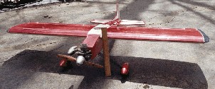

I have a Pica Rapier e/w a Fox .50, 3.5 lbs, a tail dragger, no dihedral, ws=57.5”, bow to stern..hehe = 48”, 753 sqin. , chord 11”, and a……
Royal Air 40T e/w an OS .40FP,5lbs, trike gear, 1.6% dihedral, ws = 63.5”, bow to stern = 48.5”, 803 sqin., chord=11.5”
I guess, I need size of floats, waterproof all electronics, decide if I want rudders on both floats, (could utilize 40T nose gear control with same servo as rudder, that is the setup now) ???
I have a question on floats, could they be mounted under wings, instead of attached to bottom of fuselage?
Both planes of course, would weigh less with the gear removed, then added back with the floats. How much, I don’t know yet.
Anyway, appreciate anyone’s help making my choice, etc. Thank You in advance.
Fly high be safe….bud
PIcs Pica Rapier color, Royal Air 40T b/w

I actually put some primitive homemade floats on a Royal 40T with an OS.40FP. It flew well. For a plane that size you'd need floats between 32 and 36 inches.
Other question: yes -you can mount floats under the wings. It is done mostly on low wing models. Imagine a GeeBee racer with floats instead of those big wheel pants. On high-wing models like you have, The struts would be long and either heavy or fragile (or both) and probably goofy. On the 40T, mount the floats to the main gear wires (two wheel collars will secure each float) and make a T-shaped piece of music wire to install in the nose-gear mount for the front float mount. You'll probably need a wire between the floats at the rear mount...it can be pushrod stuff-does not need to be heavy. On the Pica, get an identical aluminum set of gear legs and mount them at the rear of the cabin floor. You'll probably have to add a ply hardpoint to accept the load, but that's pretty easy.
The float steps go just a little behind the plane's balance point. example: If the 40T has a wing with 10" chord, the step would go at 4", or 40% of the chord.

Thanks for the info, I have picked the 40T.
I have made my choice based on the fact
that you placed floats on a 40T, with the same
OS .40FP, that was remarkable. Someone actually
did it. I like my PICA the way it flies now, so I will
now consider all the other good info you left me.
I "scraped the under the wing thing", and I know
they have to be big floats, 36" is 75% of 48.5" so
I guess that's my size.

Since you are scanning on the forum, look for the Chuck Cunningham article and also look for Plane Fun Floats.
The Cunningham article boils all the stuff you need to select and mount floats all into one place. Plane Fun floats are the benchmark by which other floats are measured.

Bud, go to geocities.com/planefunfloats . Although it makes finding the web site a little more difficult, I used the free web site service to keep the costs of the floats down. For your 40-T I'd suggest the 34" slim floats which would be a little lighter than the full size 34".

The nice thing about making your own is they are custom made to the application. They are easy to build, simple to design and the reward is great....
RE: Which Plane to convert to a seaplane?
The Cunningham article outlines floats that have a rectangular cross section. There is a table in the article that shows width vs weight.
Seaplane's floats have a v-bottom/tapered sides That makes the planing area wider and floatation closer to the bottom. So for a given size, they float higher and plane more easily. The slight V-Bottom adds stability and serves to cushion the plane in choppy water. The general consensus is that V-bottoms don't skip as much when landing.
I make my own floats. They look almost like Seaplane's. For the time I spend making a set of floats, and considering what Seaplane charges, Seaplane would make a lot more money working at McDonalds for minimum wage. I'm glad he does it. Foam floats are superior to other constructions, and there are precious few vendors offering them any more. I believe his are the best design offered.
