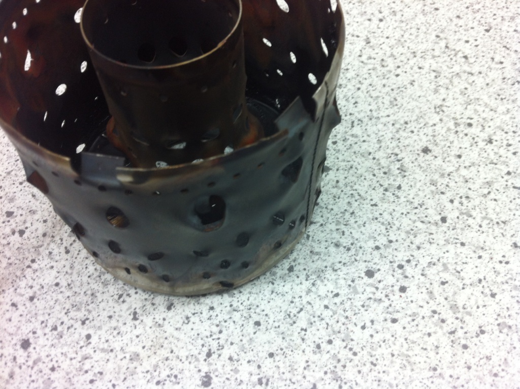

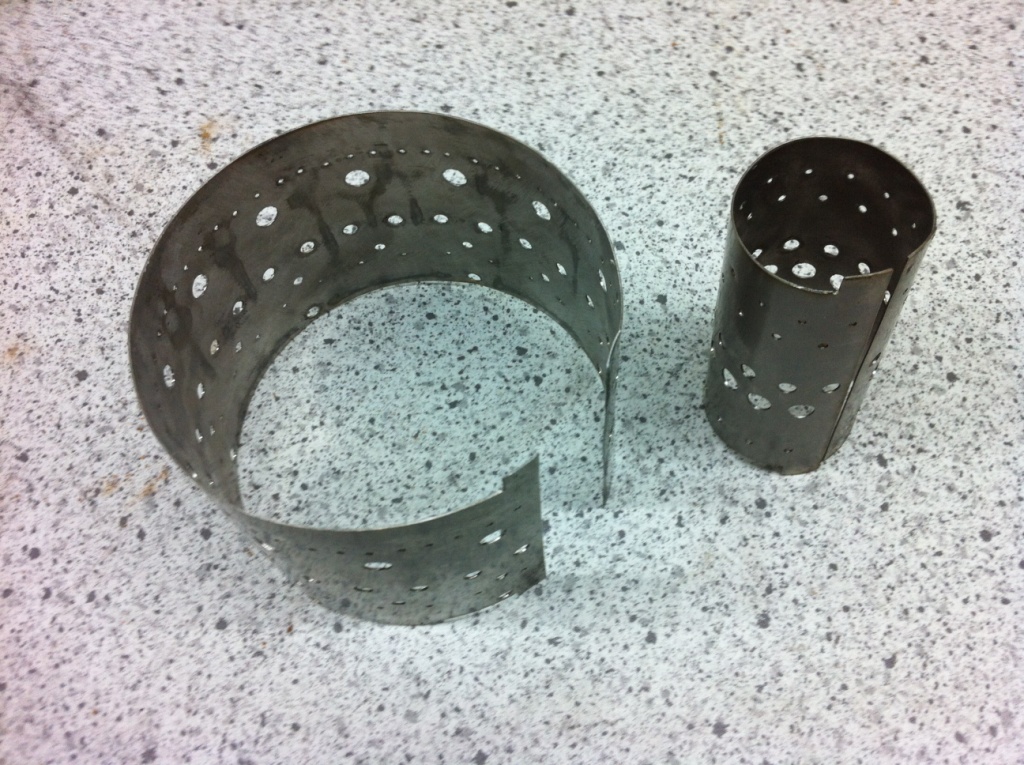

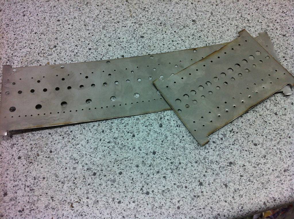

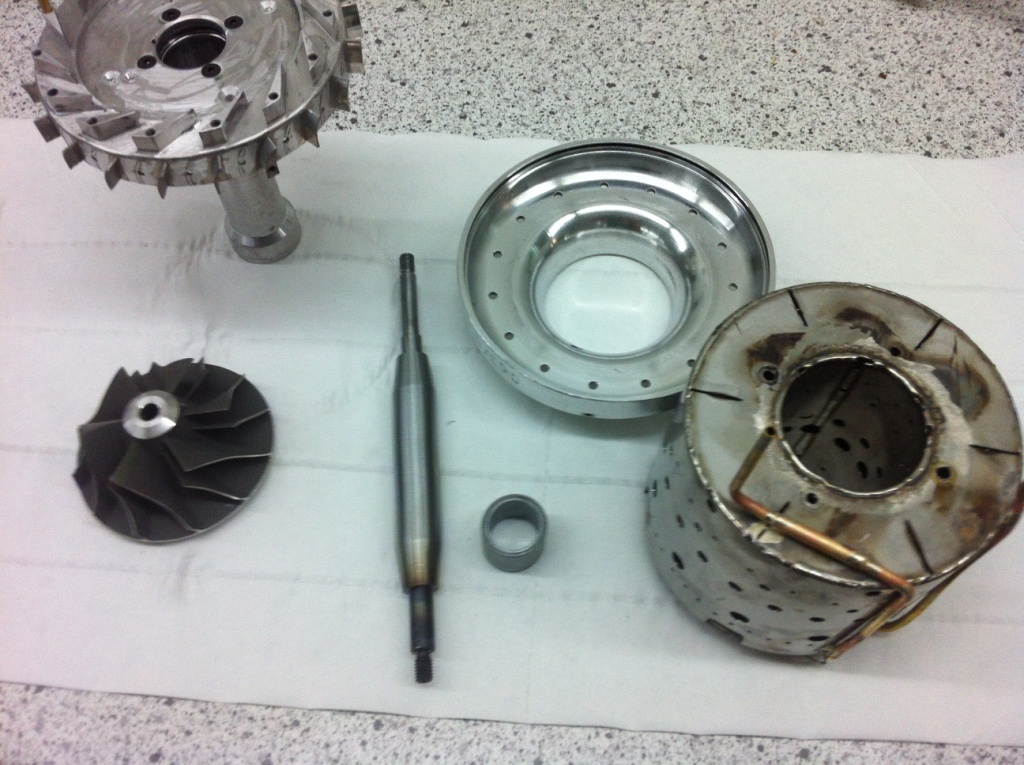

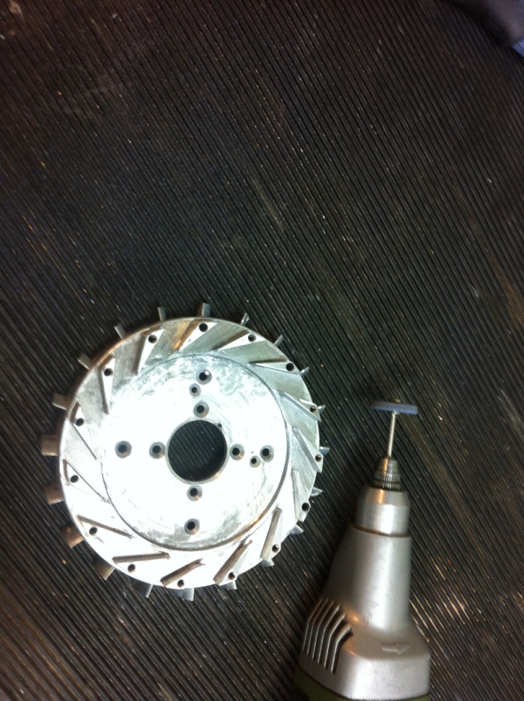

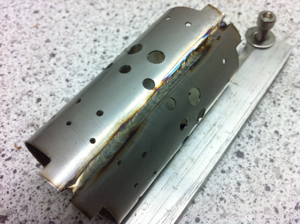

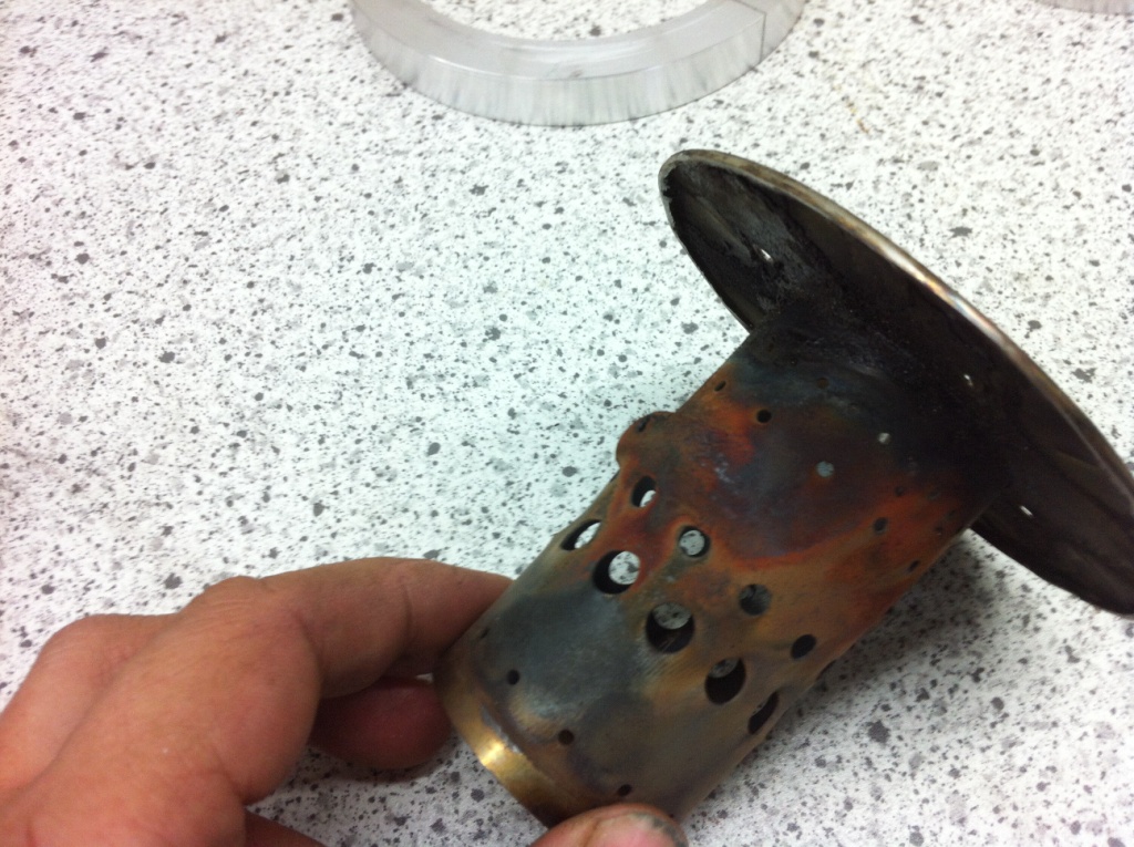

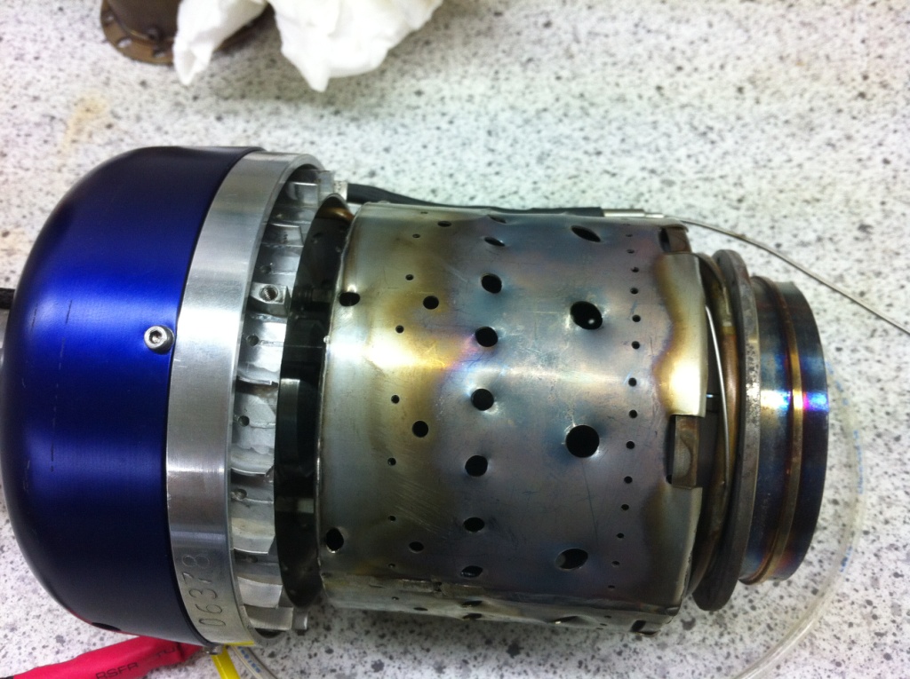

Last weekend I finished the repair and rebuild of a friend SimJet 3000. I did not have a data cable to connect the ecu to a pc. So I could not download the full software. But I saved the parameters that I had access to with the data terminal.
Start menu:
Pump Start Point AUTO +3
Pump Start Ramp 006
Glowplug Power 045 (using 2 cell lipo)
Gas Start Adjust 100%
Low Batt Volts 6,2V
Run menu:
Full Power Speed 110000 – 120000rpm (depends on what you had the engine running)
Idle Speed 32000rpm
Stop Speed 20000rpm
Start/min temp 100°C
Max Temperature 800°C
Acceleration delay 025
Deceleration delay 015
Stability delay 050
Pump Limit 1000
Hope you can use it
Some picture of the repair / rebuild
Best
Kim

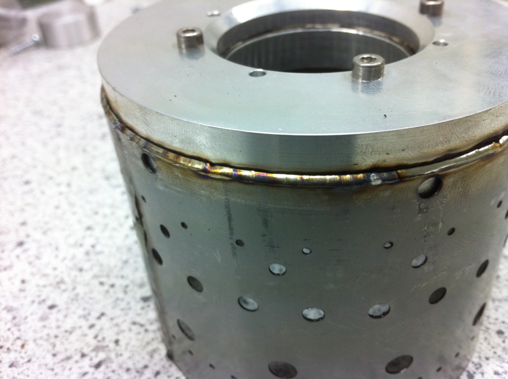

Looks like you have a full shop there. Do you make the new combustion chamber, or do you buy the sheets somewhere? When you weld it... what filler rod do you use?
I'll have to give my buddy a call today to see if he got his parts yet.
Old 11-17-2012, 11:08 AM
K Jorgensen
K Jorgensen's Avatar
Join Date: Jul 2003
Location: Ebeltoft, DENMARK
Posts: 318
Default RE: 1650 problems
I make the parts myself; I had to build this combustion chamber in stainless steel as I did not have access to Inconel sheets.
I don’t use any filler rod when I do the weld, with the right kind of welding jig you can but weld the .5mm sheet together.
Best
Kim

I have a TIG... so I understand. Good fitting parts don't always need filler rod.
