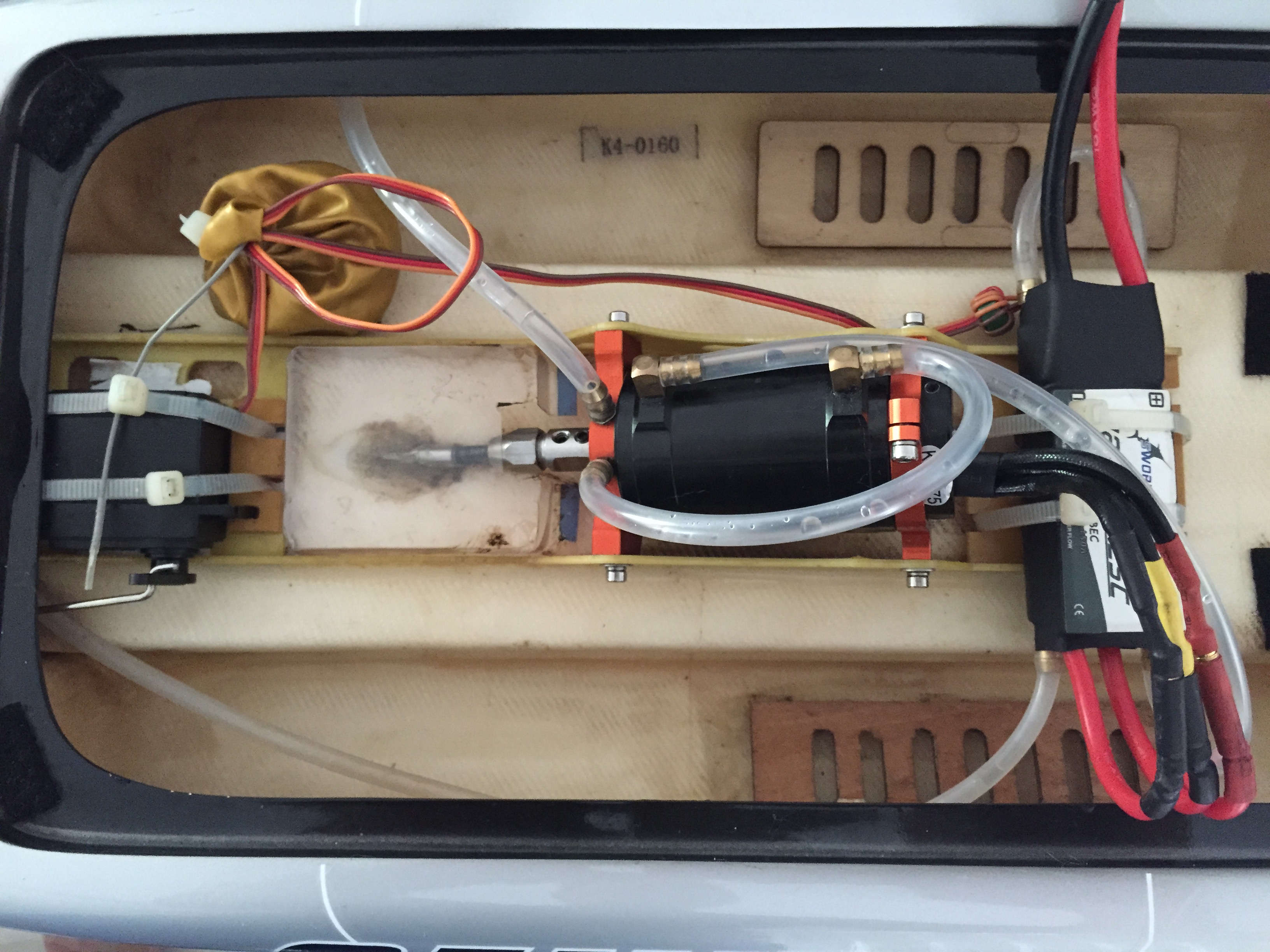

Hi guys,
hoping you might be able help? I recently bought a Himoto Genesis RTR and I seem to be going through ESC's lately? Im new to RC boats but have other RC's. If theres anything Im missing, please let me know.
Everything was going fine until I bought a new LiPo as I wanted to extend the running time (10 minutes was way too short for me). Basically - The initial set up was working fine for months and the only LiPo that I was using was a Turnigy (Nano-tech) 4s / 4500mAh / 35-70C
Boat was running standard internals:
125A ESC
2075Kv motor (not sure of brand) Water cooled
6Kg Himoto Servo
Himoto Rx and Tx
In the hope of extending my running time, I purchased a Zippy 4s / 30-40C "8000 mAh" (High discharge LiPo) and this is where the issues began. I ran it for the first time fine. New Batt lasted about 20 - 25 min. Brought it in after 10 Min to cool down and check temperatures, then sent it back out for the remaining 10 / 15min. Battery and ESC's get warm to touch but not burning hot.
Once Batt cut off, placed the original Turnigy back in and it ran for about 3 min then died. (Had to go for a swim)
Servo works, but no throttle. Again, not burning hot?
Brought it home and tested both the ESC and motor with another RC and narrowed it down to the ESC. Motor would throttle with a different ESC but boat ESC would not power any other motor.
Went out and bought a Swordfish Pro - 120 A - S BEC - as the guy at the hobby shop seemed to think the original, even though mentioned 125A, would be luckily to be a 60A (because it was a cheaper ESC) and mentioned that the Swordfish was a guaranteed 120A with 150A peak.
I found somewhere that the 2075kv motor would be about 100A so presumed that 120A was to be sufficient? not sure if this is correct.
I replaced and programmed up, took it out for the first time and it lasted about 15min with the 800mAh - and now - No throttle again, but servo movement.
Does anyone know if its the 8000mAh that is killing the ESC's or if there is something else that I may be missing? Is it in fact the ESC's failing as they dont seem to be burning hot? Well under 100 degrees Celsius.
Is there a simple fix to the no throttle that Im missing?
Thanks guys and appreciate any help

Thanks guys,
Hi flyinwalenda
Good read on the Lipo thread, so I can eliminate the mAh. How long do you guys run your boats for per run? Everywhere seems to be about 10 min per batt. Im trying to at least get about 30 - 40min through however many batteries
- Water cooling is free and working and I always run the boat past me to check the water outlets
- Prop - Im running the standard 2 Blade Nylon and the standard Flex Shaft. Have only re-greased everything
- Plug connectors are brand new Gold 4mm Bullets that I changed so I could easily mix match and test across my RC's
- No engine sound anymore. When ESC was working, normal beeps and start up tune were coming from motor. I did notice that loudness changed randomly. When I initially plugged the ESC in, it was loud beeps, but randomly would be real quiet then loud again?
Thanks Wholehog, Ill get some 5.5mm connectors and I do have a batt checker and all batts at full charge are about 4.2v per Cell. Cut offs all occur at the 3.3v - Maybe its the programming. Ive just been putting the options to (default) as per manuals

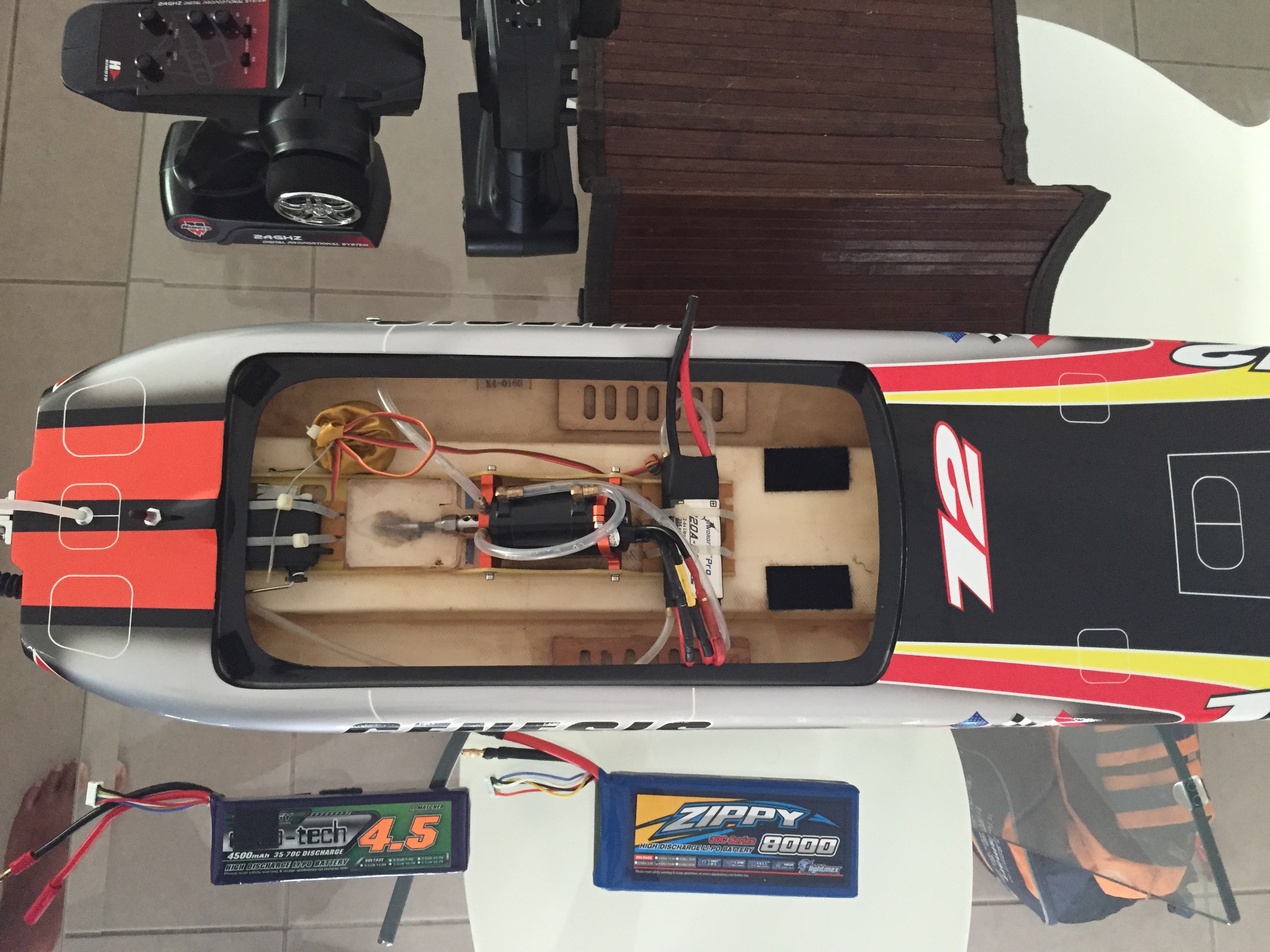

I have attached some pics if this helps?

Have you been running this to LiPo cut-off every time? Did the motor start to sputter or did the boat cease forward motion and you had to retrieve it?
What brand,model charger are you using? If it has a display, what have the voltage readings been on the pack and on each cell when you started a charge after running ?

Hi Brian,
Both times, yes engine sputtered out, then as I tried to bring it to shore, boat died and ceased to move forward. Unplugging the battery then plugging back in - No music tones from the engine.
Charger is just a 680AC Balance charger - no brand - 4 button - up to 6A charge. I only ever charge at 1c and both my battery tester and chargers generally show about 3.3 / 3.4v when I charge them and after runs. I have run Low voltage alarms set at 3.3v as well
Batteries are only a few months old and the 8000mAh is only a few weeks old. I store the batts at 3.8v and full charge to 4.2v only

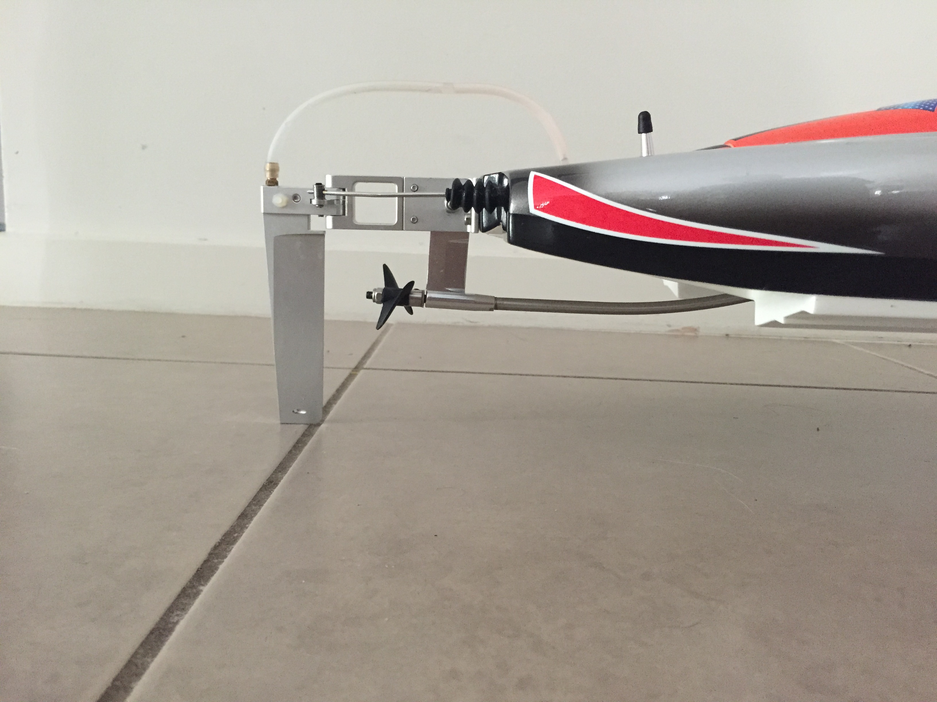

If I change the 4mm Bullet terminals to 5.5mm and get a 180 - 200A ESC, do you think this would eliminate the issues? Im happy with the speed that the 4s Lipo's produce.
Can you see any issues with the prop and its height at all?

All I can say at this point is that some condition or component is causing the esc's to fail. Either too much heat or too may amps. You can get a higher rated esc and install it but I would either buy or borrow a watt meter and test the set-up before running a battery through it again. It could be the connections, the prop, or it could be a failing motor. You really need to see how may amps,volts, watts, etc... the set-up is drawing at no-load and under-load Otherwise it is just a guessing game.
