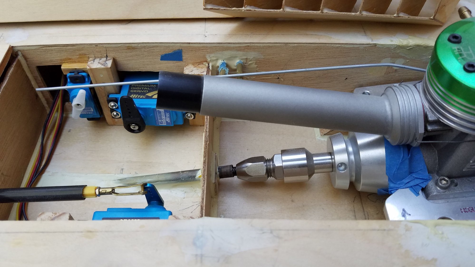

Okay, have a question and some thoughts for you:
1) What is that black thing in the end of the header? Is that a plug to keep crap out of the engine, as it appears to me?
2) Your vertical fins need to be more upright and the wing between them shorter. If you can find pictures of the full sized boats, you will see that the vertical fins are roughly at 90 degrees to the deck but not totally vertical. Here's a link to a shot that shows the angle of the fins:
3) Before you paint the boat, you need to fill in the excess slotting for the strut. I would tape over it for testing, just in case you need to either adjust the height or location of the strut. The holes on the left side of the transom need to be filled as well. I'd epoxy in dowels of the appropriate size.
4) You need to move the drive dog back from the strut to approximately one flex cable thickness. The cable will shorten under load and the result, with the present spacing, will be a broken cable and lost prop/stubshaft
5) If you're going to leave the CMB in the boat, you may need to add another tank, probably under the deck. I run 50% nitro fuel and use between 18 and 20 ounces of fuel during a roughly 5 minute run in competition.

THX Hydro,
1. Yes just a plug to keep krap out. When I got the engine, I sealed everything up.
2. Yes, I noticed that also, but as built to the plans. The fins will come in a wee bit when the top wing is actually installed, just sitting inbetween for photo op.
3. Yes, I know I have to pack out the strut mounting and make it "tighter", but still being able to make angle/depth adjustments. The "holes" are actually "ballast tubes" I put in there if I needed nose or inside right weight. I made sealing plugs for those if/when needed.
4. I left a bit of length for a thrust bearing on the drive dog, and I make a slip yoke for cable to engine connection will allow almost 1/2 " inch of cable wrapping due to torque.
But I know I can nestle in a 6s 5K MAH battery into the nose, but may have to go to 8s or 4s2p? and relocate battery location. Looking for info on the suggested components to go electric, Motor, (with applicable watercooling jacket or mount, waterproof ESC etc.
I don't know, that's why I am here asking you guys. And I have no issue with redoing the bottom pan if need be. Just need help in choosing the more correct motor/mount and ESC, then I can start to see what I have to do to go electric.

Here are a couple of images on the slip yoke" I made, the cable is not cut to final length yet, and I did take into account torque wrap:

Question for flycaster: What is the size of the cable that is in the boat? If it is 3/16" I have been told
that most of the modern day electric motors on 8-12 cells will break it very easily, as the torque is
instantaneous with brushless electric power versus the "wind-up" with nitro power. I have been told on
any 1/8th scale FE boat to go with 1/4" drive cable with the shaft stepped down to 3/16. Just an
FYI before you go much farther into the conversion.

Morning, it's a 1/4" cable. I actually don't remember if it's stepped down, but looking at the image, looks like it may be a full 1/4" all the way. Will have to look at it when I get home.
And yes, a very good point on the torque wrap, being almost instantaneous on FE vs. gradual on the nitro.
So starting the interweb search on motors,100mm? running around 850kv and a "waterproofed"/water cooled 130/150 amp esc, nominal 8s (or4s2p) with "headroom" for 10s.Now I realize I will need a water cooling jacket for the motor, but most of the motors I see are "open frame?", vs. a few that look like they are more "enclosed" i.e. Leopards? Any benefit over one or the other?
Thx
I can see cooling benefits for the open frame type, but any advantages of the more fully enclosed motors, i.e. water "resistance"?

Correction, 8S is not the same as 4S2P. The former is 29.6 volts, the latter is just 14.8 volts. They require completely different motors. You want 8S for your boat, 8S1P for less weight, 8S2P for longer run times (and twice the cost).
You want an inrunner motor, the “open frame” motors are outrunners. The former are much easier to cool, in years past a few 1/8 scale racers used outrunners, but today I’d use inrunners. A 40mm x 100 mm motor will work well with the ~850 Kv. I use OSE a lot, the owner supports hobbyists and racers.
