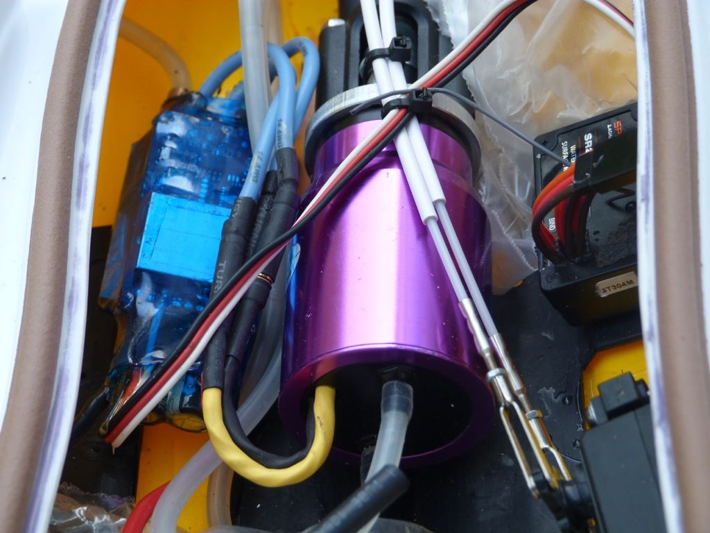

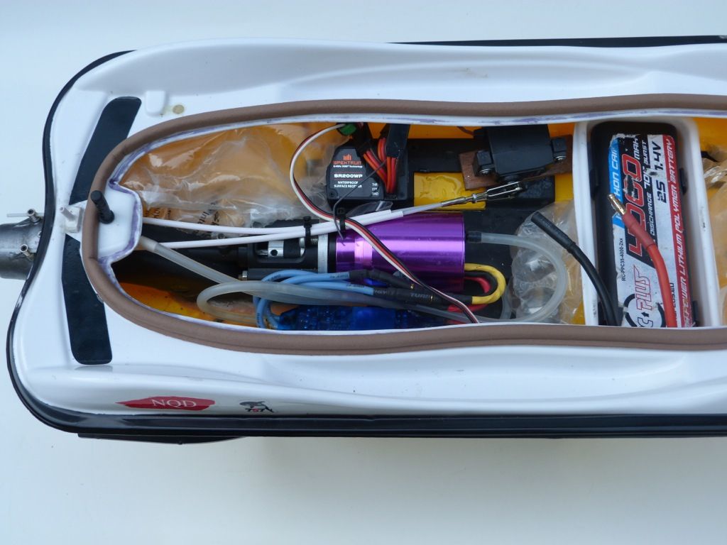

Old 10-05-2014, 02:54 PM
  #4974
89MIB
Join Date: Sep 2014
Location: Brisbane Australia
Posts: 6
Default My bits have arrived
My bits have arrived and this is the progress so far. that is the 3974 2200kw in the pic IT FITS even without the shaft extension.

Old 10-05-2014, 08:15 PM
  #4975
Jay-Em
Join Date: Mar 2011
Location: GroningenGroningen, NETHERLANDS
Posts: 104
Whooh! Clean! Shineyy... I always preferred anodised blue to purple.
Great news that it fits without the hassle of adapters and such. On 3s that thing's gonna fly! Keep us updated.
I'll try getting my hands on that 3974. It's out of stock at HK Europe for the moment... P.p.p.p.patience.... Grrmbll..
