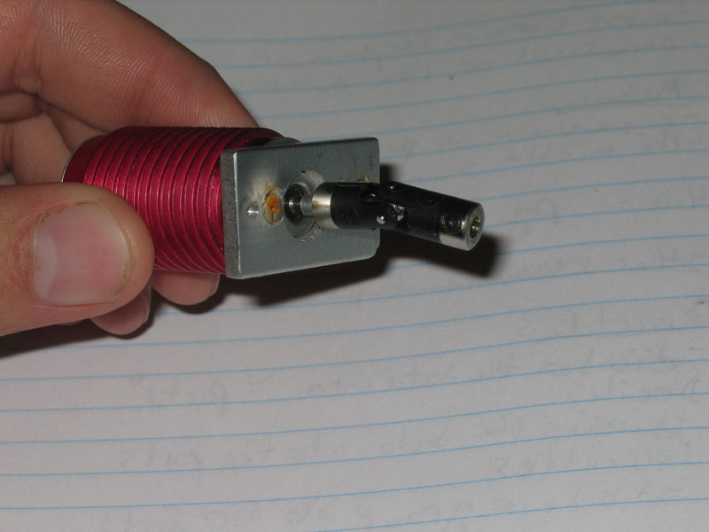

Well here's one of my builds, almost complete. I love the whole making process but absolutely hate the "I don't have any _________, damnit now I have to go get some." The thing is a bbyracing 12.5" abs boat. The boat came overly well packaged for the size, hell the shipping cost as much as the boat (20 bucks). I'm going to dump a bunch of photos on this thread because seeing is better than reading... well most of the time.
The jet drive is a graupner micro jet. The motor and Esc are from UH. The motor is a 1600rpm/kv outrunner, runs on 10 amps burst for 30 seconds at 15 amps. Esc supports 10 amps with burst to 12 amps.
The lipo's are 11.1v from RVM shop on ebay... love these guys good prices. It can unload at 12 amps and burst to 20 amps (hope I have that right... lists 12c and burst of 20c).

I guess... the original wires looked to be higher than 18g my guess would be 20g, it's 18 now, which can allow for 16 amp draw.
Anyways need some help on the inrunner motor. As bellow you can see the motor. Apparently the "hat"(term hobby shop guy used, not familiar with term) needs to be removed for me to stick on a prop (am using the prop as a fan to keep motor cool), but it does not appear to be removable. 2 questions, a. is it really removable? or is it part of the whole can (magnetic part). b. Cutting the cap off is possible with the motor running and the dremel, the question is is it wise, the two screws that were in the "hat" is that for keeping the magnet side of the can on the shaft or is the shaft just pressed in. Help would be appreaciated.
Other than this, retesting motor, heating heat shrink, possibly making little battery holders and gluing the top on, she appears to be done.

Ok well took her out, noticed a couple things, I would say the boat hits 20km more than likely max speed, was hoping for 25 min. Another thing is the boat seems to need more weight and obviously I need to reposition the batterys to stop the porpoising.
Take a look let me know what you think.
The other thing, because I'm disappointed with the speed I decided to slap in my old 3200/rpm v 25 amp brushless. I know this will more than likely burn out the lipo as its rate for 20 amps max. Will only half throttle it just to see.
http://www.youtube.com/watch?v=hh7-85hHbi4
