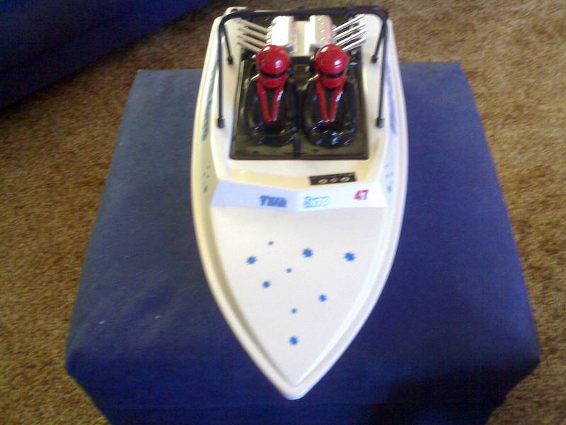

75 pages of jetdrive stuff, so i decided to start this for the guys modding the "nqd tear into" boats
My Setup :
Tear into boat
3500kv 400 size outrunner
3s 2200mah lipo
Hyperion Titan 30a esc
GWS micro 6ch receiver
Digital micro servo for steering.
Custom brass coupler
Modded jet pump : have sleeved the bearing surface where the shaft runs through the jet unit with 1/8 k&s brass tube, sharpened the stator fins.
First run stock was quite pathetic, stock electrics are junk.
2nd run with the above mods - quite quick until an un harmonious vibration arose. On further investigation it turned out to be the impellor sliding back on the shaft, so i drilled a 2.5mm hole and tapped a 3mm thread and put the 3mm set screw through onto a flat i filed on the shaft
3rd run - Just nuts, this wee thing does 45/50kmh now, excellent handling and acceleration.
All in all im well impressed.
Next mod will be to go to a lower KV motor and/or try the 3500kv Motor on 2s lipo.

Hey Simon
Yep some pics, i will take it for a run shortly and video it had it in my mates pool yesterday, since the brushless/lipo repower its way too crazy for the pool though... haha

The intake for the pump has this drop down plastic block that can be totally removed from the unit giving access to impeller and shaft without removing the jet, this hangs down as a water trap a little, but inside it also has a square step that cannot possibly be good for flow into the jet, it is only 3mm wide but none the less a step where water entering the unit will be hitting creating drag and thus rubbing me of speed.
Will take a vid of the little beastie after work tomorrow
