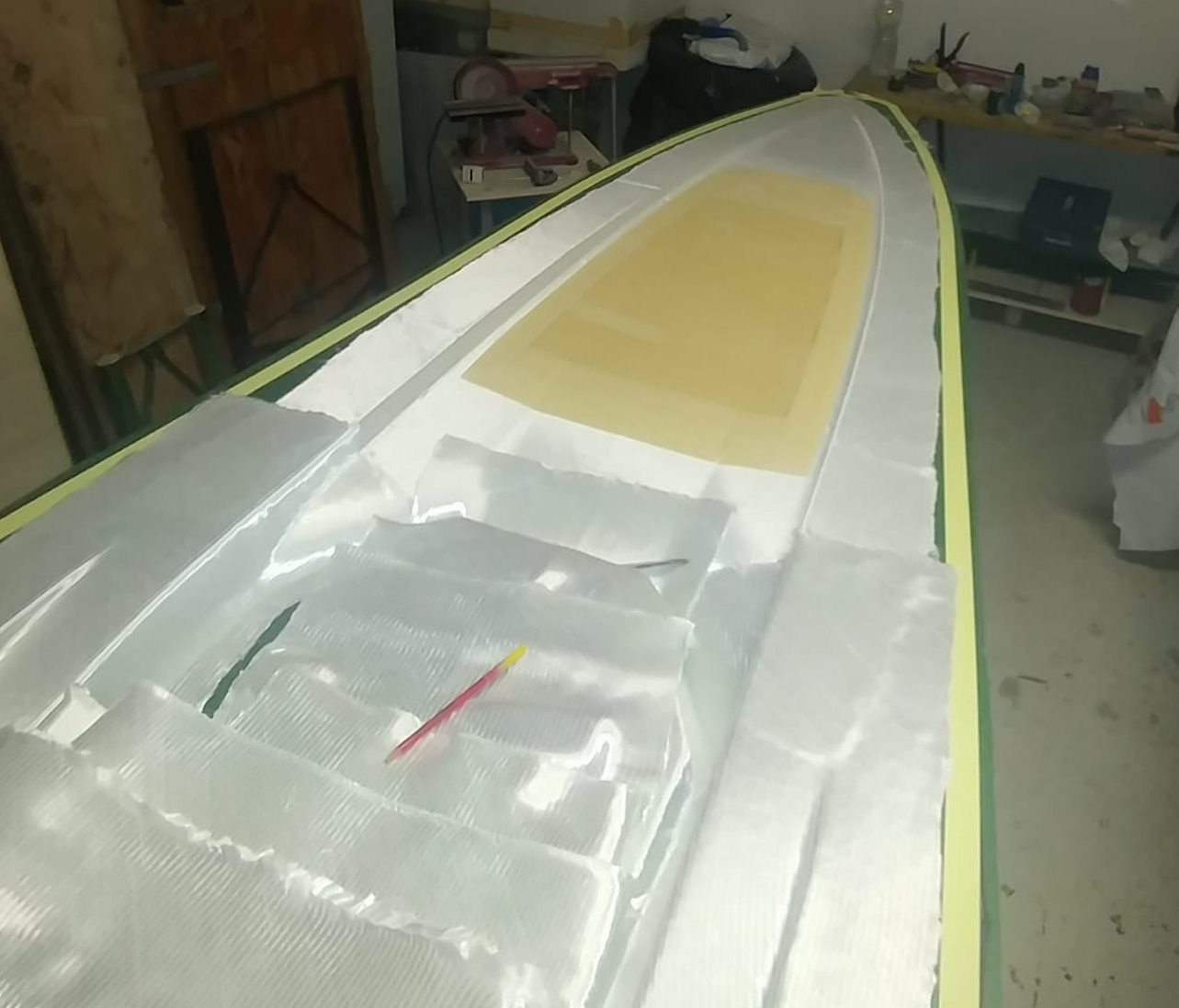

meanwhile we have had some progress. Because this is an international hobby project it costs some more time than expected, we have CAD designer in UK, Sitzerland and Germany, positive and mold producers in Australia and Italy, kit producer in Italy
121" version:
will be produced in Italy by a carbon fiber specialist who works in a company which produces wings of windmills.
The positive is ready to mill but during the design of the hardware we've found out that the stern pod must be changed.
This has been done by our CAD designer, we are waiting for the data.
Hardware has been concepted by me and transferred into CAD-data:
- drives
- trim tabs
- rudders (CAD work ongoing)
The first models will get 2 RAT HOUSEs each. To be able to perform an easy package study I have made 2 powertrain dummies.
You may check the pics in the attachment if you'd like
65" version:
Mick in Australia is working on the positive, see attachments. The hardware will be a bit more easy because we can scale that down from the bigger model.

update: now we have finished our design work of the big model, we are currently preparing alls 3D and 2D data to get all needed parts produced.
Attached you'll find an overview which shows the size of the Big CESA1882. All values are in millimeters, e.g. 3567mm = 140"
The work on the small model (165cm = 60") has been stopped because the plug-producer has some trouble. When we have done the work on the big one I will
take care of the small one

we had found out that there was a mistake at the stern pod. So we decided to make a new one. To save time we have printed that part, the pics show the result.
Hardware is completely designed now, more than 100 different parts
- 2 rudder sets
- 2 trimtabs
- 4 drives
- 1 rope box
- 2 prop safer for spare props
- 4 internal rails to fix engines, tanks, rc-box, battery box etc
- craning devices
- stanchions

First hull is in the production phase now, we use not the hand layer method, here we use the infusion method, which is usual in the aircraft industry. Reason: the result is less weight at better durability and stiffness. That means the layers will be put dry into the mold, then this will be covered and sealed by a plastic sheet, then a vacuum pump starts. The result is very low pressure - nerby zero - and this sucks the resin into the layers, This ensures 100% saturation of the layers.
The pics show a bit how it works.
tbc
