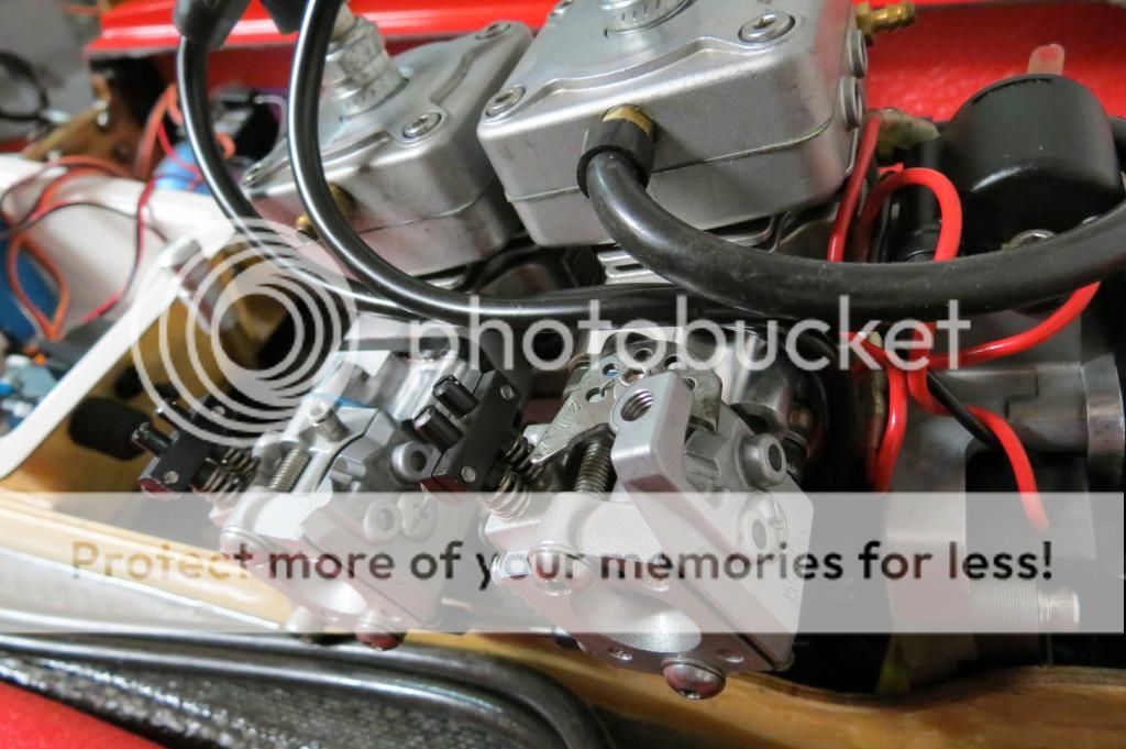

im new to this forum,,, I bought a rio with a Fuji... could not get it to stay running. so I called up gizmo and got a rcmk, mounts, torqemaster pipe and 7/8 header,flexcable tube aluminum support brace with grease fitting, and there universal throttle kit.. im wondering if someone has some pictures of throttle setups on there rios with the rcmk. I have addressed the issuses with this boat since reading all the stuff on here about the Fuji.exhaust cracking and other stuff. thanks for the help, I also got he grim racer 3blade prop, and will be running another water pickup and more water exit ports. hoping to get it on the water soon!!!!

Just by looking at the pictures from the AquaCraft site it shouldn't be too hard to do. Unless you need the ignition shut-off, replace the throttle servo arm with a stock Futaba arm. From there run a 2-56 or 4-40 threaded rod from the servo to the new Speedmaster linkage. You're going ot need a radio box seal for the rod but AquaCraft has them from some of their other boats that you can use or get one from someone like Du-Bro.
Remove the idle set screw if you already haven't so that you can shut the engine off from the transmitter.
You shouldn't need the throttle cable brace on the side of the radio box either.
I used this shot as my reference: http://www.aquacraftmodels.com/boats...1xxai12-lg.jpg

Do yourself a favour and get a carb block that rotates the carb to give you a direct straight run to your servo,this way no need for bellcranks just a straight rod,so simple.Im sure someone your side sells them but heres the one i used it also has a pulseline fitting but you can get them without.
I for one will never use a belcrank system ever again.

Speedmaster throttle assembly is one of the better ways. Forget about friction style bell crank style throttles with the nylon bellcrank directly pushing under the throttle arm.
Junk that throttle you have it is the friction type. They are the worst way possible. get a Speedmaster.

Dan, I use nothing but the Speedmaster's myself but there are some people that like them because they say that they can rev the engine with the radio system off. I can do the same thing! I've got a small pile of the Gizmo style that people have given me. They're sitting in a box that I started for stuff to unload at a swap meet.

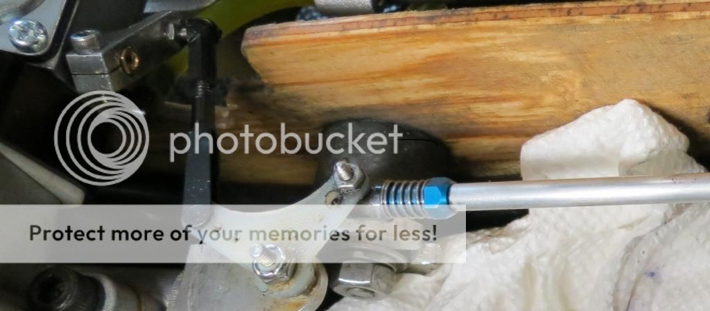

thanks for all the replies,,.. ron I have the older radio system and servos, its the rio51,, that picture is the rio51z with the zen motor. here are a few pics of my setup, I wanna keep the stock radio box, I have another radio box seal kit from gizmo and there universal throttle kit, pic of it posted, the bracket is already bolted to the rear mount. the ball link is off the Fuji carb.this carb on the rcmk is mounted diffent than the Fuji, so the linkage is swapped. the rcmk comes with a 929 carb, the Fuji has a 883 I think. another question is the exhaust. witch pipe to use..2inch or 3inch 90degree, how much header pipe should be sticking in the tuned pipe?

Sory to burst your bubble guys but any bellcrank setup is inferior to one straight rod directly coupled to the throttle arm its just one less thing to go wrong and so simple to setup its a no brainer.
Not only are you eliminating un needed linkages in your throttle setup you are gaining an alloy carb block,all this for what it would cost for your belcranks and extra linkages.
After trying this setup i will never use a belcrank system ever again.

No bubbles busted here. LOL. I am very familiar with straight directly connected carb linkage. I use to sell the aluminum intake blocks that rotate the carb. I could certainly be running them that way if I liked it better. Been there done that and ain't going back. Lol.
It is whatever you like.
Direct is less parts and cleaner I suppose.
To each his own and have nothing against direct really but I will share why I prefer the Speedmaster nylon bellcrank style throttle setup -versus- direct because the nylon can flex if you should overrun in either direction accidentily. Instead of it trying to rip the shaft off the carb or a linkage apart it simply flexes you see it and realize you need to either get the radio set on the right model because you screwed up(especially if the other model had the throttle channel reversed)or adjust your endpoints again. But even while setting endpoints it is nice not to have it locking solid before you get it backed off where it belongs. The nylon is like a servo saver it flexes only if you should need it too. Same reason I would never run the metal bellcranks they sell. Defeats the purpose of having the bellcrank. The flexible bellcrank even though it doesn't flex in normal use much at all I think it isolates the pounding of the engine and vibration from going to the servo, mount and radio box.
I also don't like the carb arm up underneath where you can't get to it much. I realize you put it on before with the arm swung reward halfway but even the linkage connection down in between the engine and rail is not easy to get to should you need to. The Speedmaster linkage is 100% bullet proof. Must own 30 and no part of any have ever failed.

I use both types - both have advantages and disadvantages
The two I have with straight pull have their own complete radio systems - and I check endpoints before I run - it is something u have to pay attention too. Also having stiff rubber mounts as well (rocking motors with no play in throttle are hard on carb shafts - that one I learned hard way)
The latest 90 iso I have is from Matho and is a work or art - and very thin as I was looking for upper end rev.
Both systems are good if set up right - I find reg Speed Master easier to take off for maintenance though.
