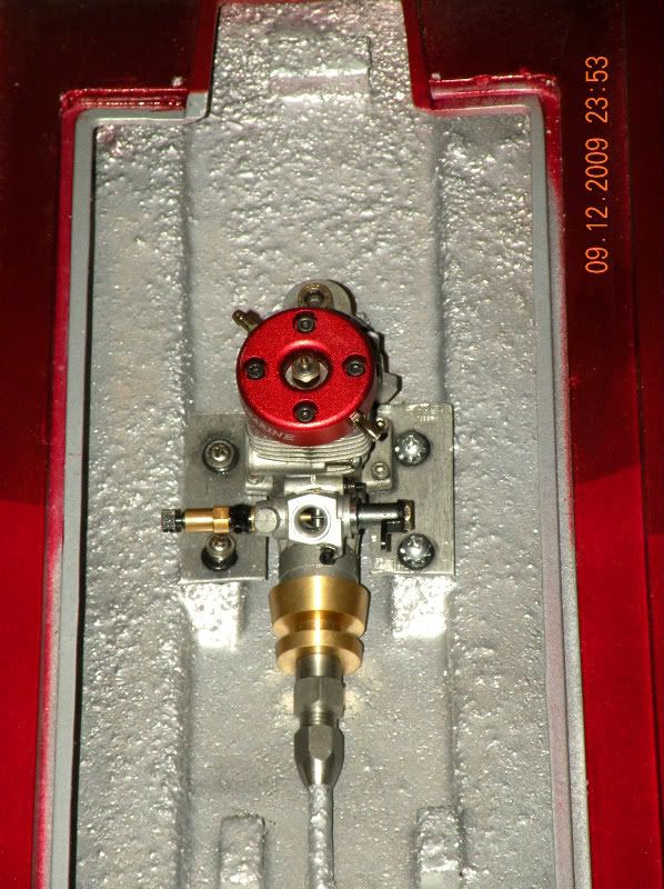

    Hey all, havn't been on the RCu for a while since my MVD .32 parted ways (literally). I have a couple new rides that I have been working on. Hopefully I can get both of them up to the speeds that I had my original 32. I am in the market for a Novarossi piranha to test out also if anyone knows anyone.
    New Paint Job:

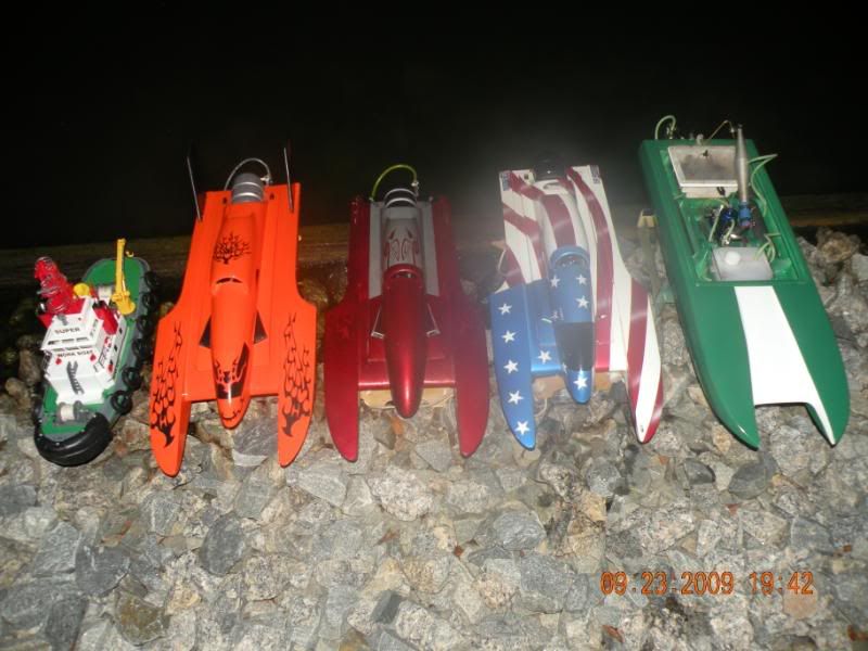

    Recovery Tug, Stock Vegas, .32, Liberty .32, and my buddies TC OS .21 VZ-M
    Liberty Vegas... sitting with a .32.. soon to be Rossi .21

    Hey bud in the picture the collet on the 32 (red one above) LOOKS like its a hair close to the stuffing tube, it may just be the picture angle

    RE: AquaCraft U-18 Miss Vegas Hydro Thread_Make it Fast!
    ORIGINAL: toyotatruckin
    no man.. i run it that way Actually, I was still setting up, found it easier to mount the motor then adjust the tube. Used collet to hit correct angle, epoxied the tube, moved the box back, and cut the tube perpendicular to box front for workability. Had to do some work with the Liberty tho.
