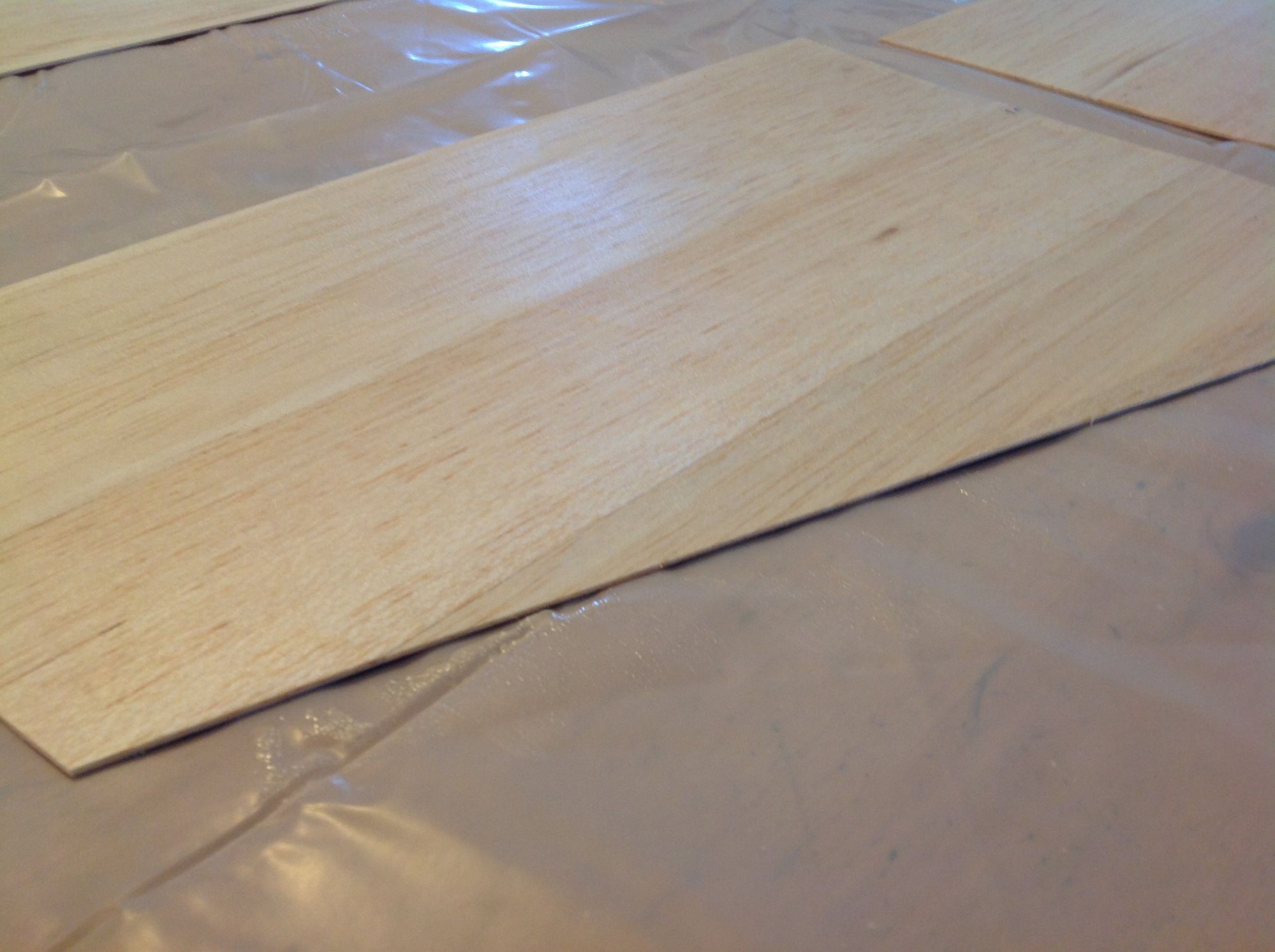

Although a stab is shown the same prep applies for a wing. Note that the joiner socket, root rib and servo box has been done prior to sheeting.
Application of epoxy laminating resin.
Use just enough to produce a sheen on the skins. This applies for epoxy and Gorilla Glue.

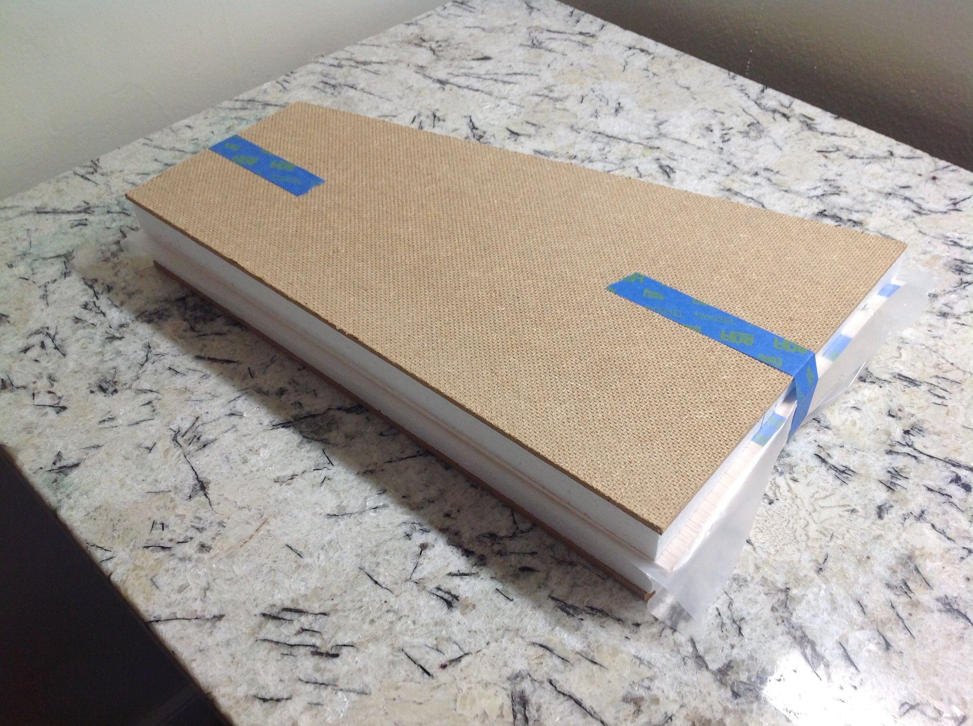

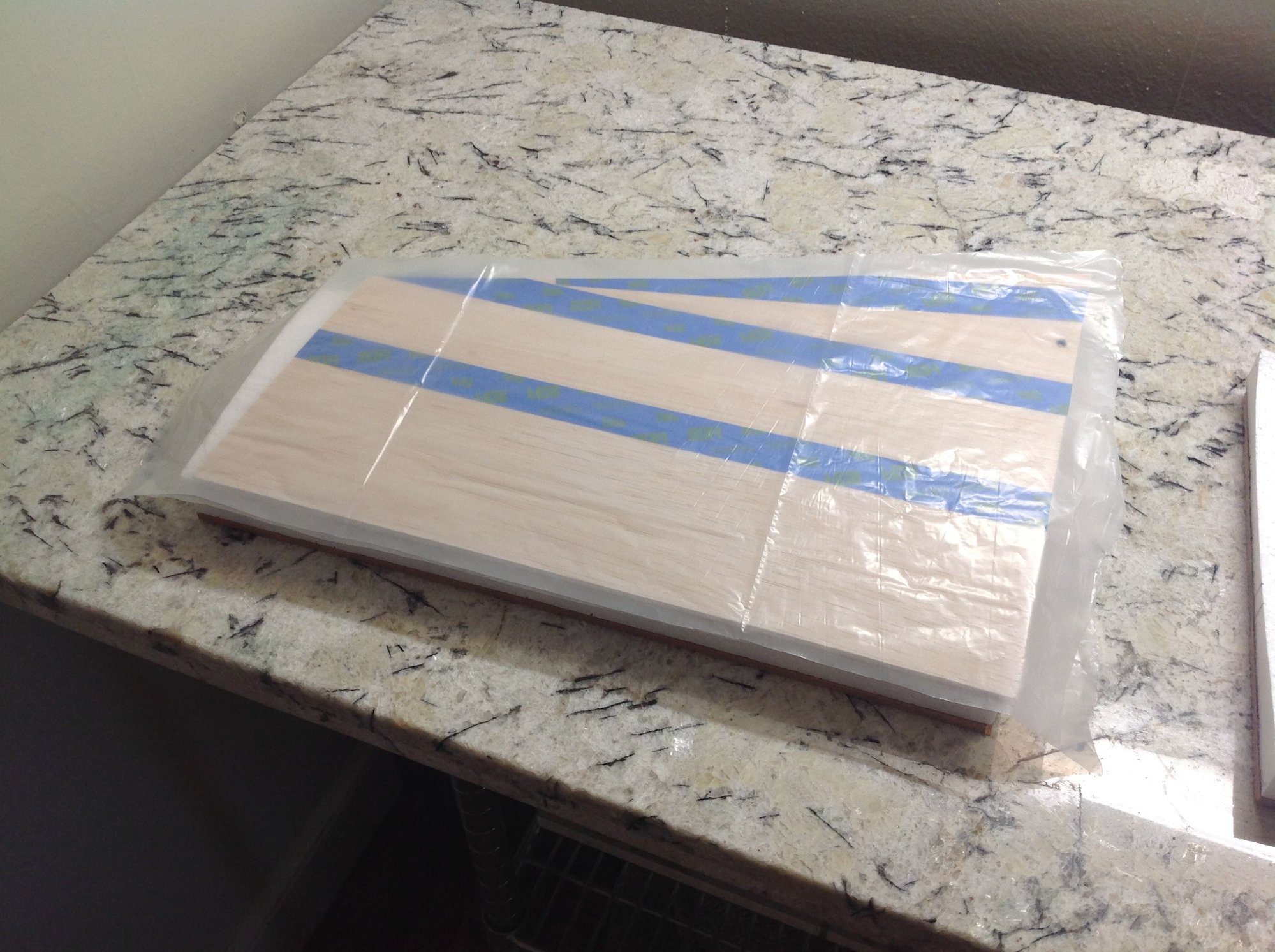

Skins taped into place on the core and placed into shucks.
Pressboard added top and bottom of shucks.
In a bag and under vacuum. Weights can be used as well.

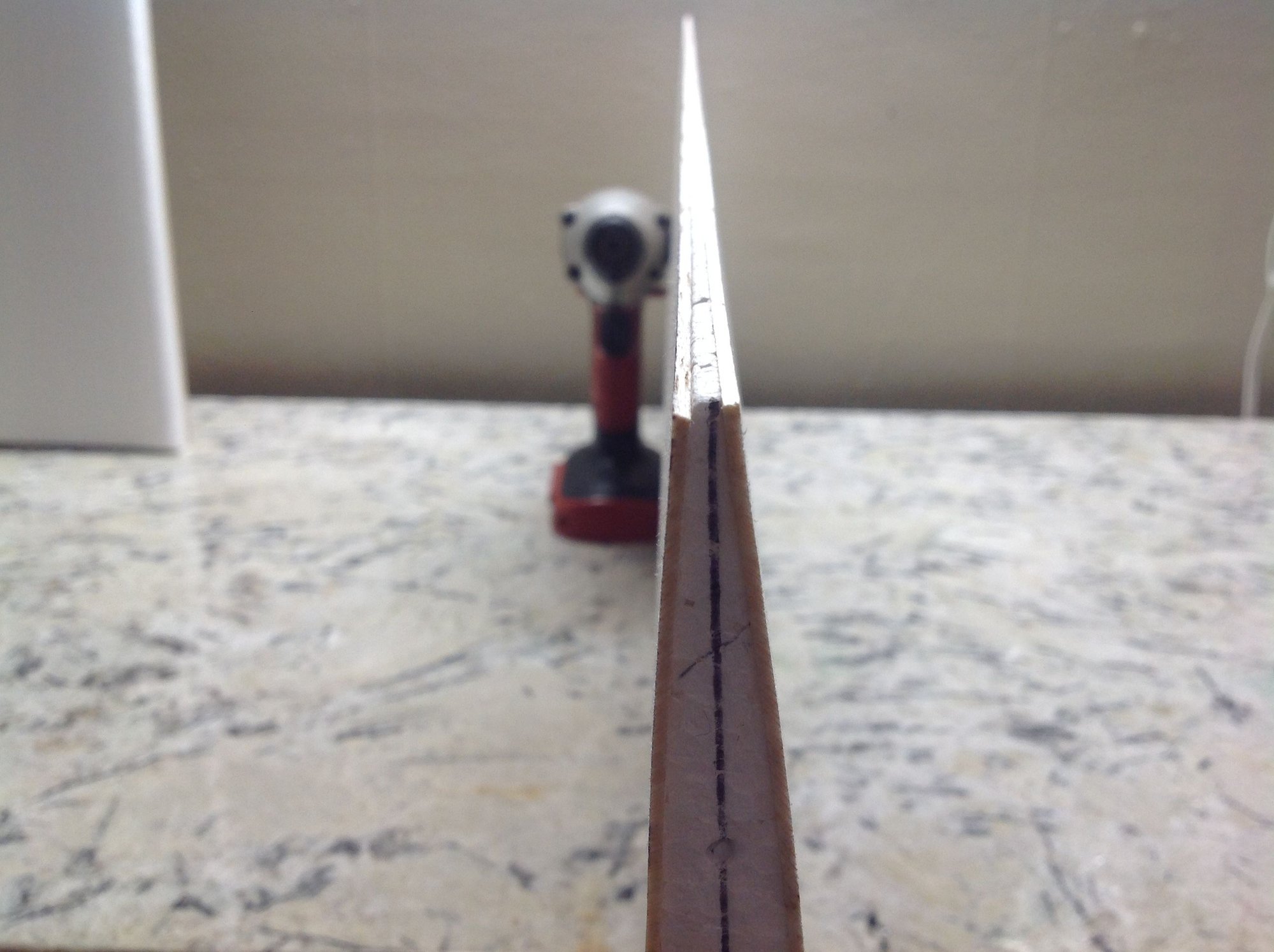

Default Last pictures
Pretty darned straight.
Sheeted stab complete with stab tube and incidence adjusters. 176 grams.

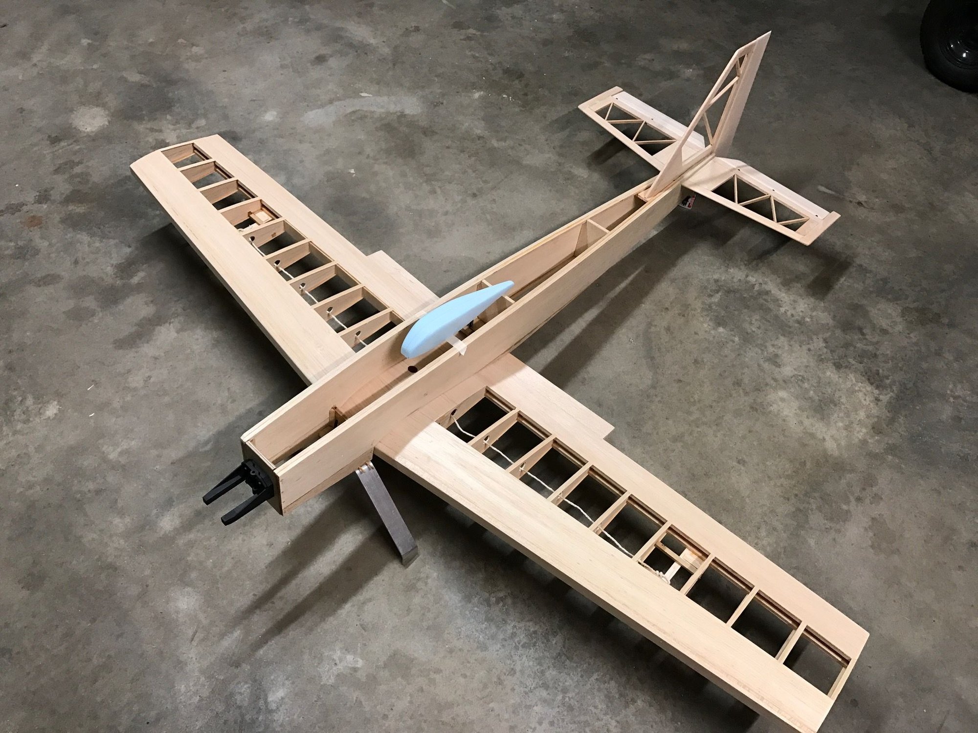

It all depends on which material you are comfortable with; foam or balsa. Iíve been comfortable with balsa. Iím now experimenting with cutting foam wings and building with foam.
As Appowner stated, a balsa wing is not hard to build. Here is a picture of what he states. My plan is just drawn lines on freezer paper. Shaped wing ribs and rib spacing. Tapered wings are best built in a jig, IMO. Even the jig is not hard to make. You just need to give it a try. The sooner you start the sooner you finish; balsa or foam.

I havenít seen the Kougar wing plan. Thought Iíd post these pictures. Wing has LE-TE sweep which may be what a Kougar has. So wing building is not too difficult. Just vary your technique a bit.
