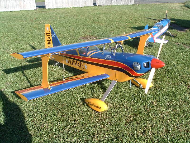

Have 5 or 6 flights on mine now. Flies very well, like an Ultimate is supposed to. The build quality is great, I have been happy with every seagull model I have had so far. Overall the hardware is pretty decent. The control horns are great, but the clevis and linkage are metric. I prefer a different style clevis, so had to change the control rods to inch dimensional....but that seems to be true of most arfs.
As far as assy at the field. It is a lot better than some of the bipes I have had.....but it is a bipe, so it takes a few minutes. The bottom wing slides on an aluminum tube and is held on with two plastic wings bolts on each side. The wing bolts are designed to be tightened by hand, no tool needed. Then the cockpit section goes on....two bolts there, allen wrench. The top wing also slides on an aluminum tube that goes through a permanent mounted center rib (like most of the large ultimates have now). The the two sides are held together with two more plastic wing bolts....same deal, finger style, no tools. The interplane struts require four bolt/nut each....but allen is same size as cockpit bolts. Then aileron interconnect linkage.
Overall, very impressed with plane. relatively easy to assy at field. Initial build is a piece of cake....I think this is the quickest I have put an ARF together in a long time. Quality is very good and finish is different than what you see on ultimates every day.
Also a great size, reasonably big but don't need a dedicated trailer for it. Mine has the Saito 1.25 on it, a perfect match. I have no problem recommending this plane.

I just test flew my Seagull Ultimate 90 today. I only put an OS 91FX in mine with a pitts muffler. I was afraid that it would be underpowered, so I set all the control throws to the recommended settings. I was very surprised at how it flew. On the first flight it was stable as a rock, but the recommended control throws were just not enough. I had to use throttle to land it because I ran out of elevator. I adjusted the throws and the second flight was perfect. It landed very easy with no stall attendances.
A .90 2 Stroke is fine just for sport flying, but you would need at least a 1.20 four stroke to 3D it.

The pull/pull is correct. All the book says is 6 digital servos. I used Futaba 70oz digitals on the aile. I used 2 stock Futabas on the elev. Each elev half has it's own servo mounted inboard. I used a 3305 Futaba on the rudder. It is a 99oz metal gear. And a stock servo for the throttle.

I have one with a Saito 125 16-6 apc running hitec hs645 all around running at 6 volts, standard on the throttle. I have 5 flights on mine and I would go with the recommended throws except the elevator it needs to be increased a bit more . plane flies wonderful and looks beautiful in the air. It is well built. I would buy another one. Busted Blade installed an electric setup on his and total weight came in about 12lbs. He said it had super unlimited vertical. With this info any 26 size gas engine should work great. Zenoahg26 or Brielli 26 .Several guys have installed the Zenoah g20 and it gives good sport performance. Aparantly this plane is capable of handeling the extra weight. As soon as it warms up I plan on installing the sulivan skywriter smoke pump and 10 oz of smoke oil. If you run 6 volts and the Saito 125 . if you place the battery under the front part of the canopy it should ballance about right. I had to add 1/2 oz of weight to the left side wing tip to lateral ballance the plane. If you use the stock motor mounts make sure you loctight all hardware. After 2 flights my motor was very loose. I liked all the hardware except the stock tank and the hardware for the ailerons. I recommend changing it to 4-40 wire and better clevices. my plane weighs about 10 lb ish with bath room scales.

A few things I ran into. The stock plastic pieces that thread onto the control horn bolts were a problem. The holes were to big. They are long enough I was able to cut off the factory hole and re-drill them.
The top center rib that stays on the cabanes. Is hard to get straight. After you bolt it up. Lay a yard stick on it and adjust it until the yard stick centers with the fin. The holes in the interplane struts are in the wrong place. I had to slot them to get them in without twisting the wings. The holes in the metal pins that go through the ailes are to big. The clevises and the rods for the top ailes will have a lot of play. That's all I can think of for now. I have mine sold. The 1.25 is to week to hover it. I would put a 1.50 or 1.80 on it if I was doing it again.
