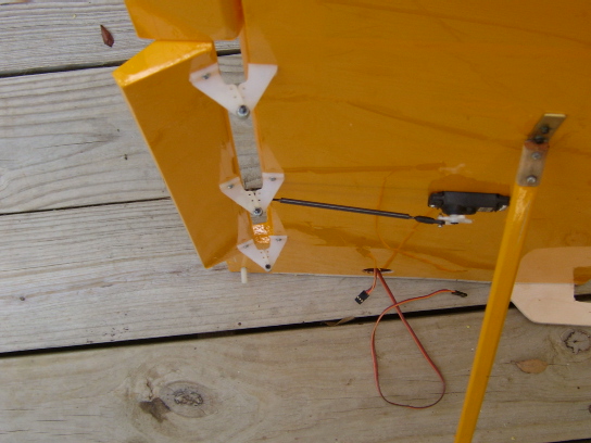

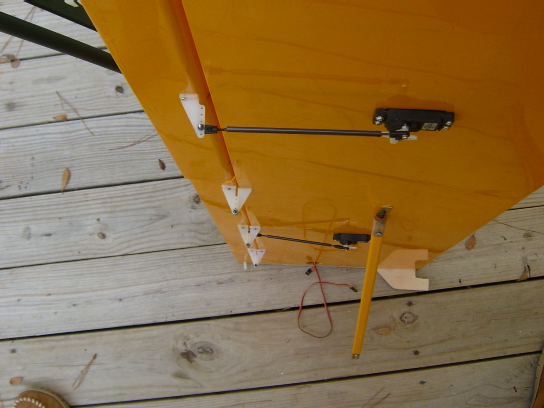

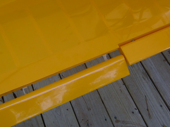

Here's my version of flaps on my Senior Telemaster. I scratch built a new set of wings for the Hobby Lobby arf. Fully extended they allow you to approach nose down at 45 deg. and then flare at about 3 feet altitude. By the way I'm running a gas Ryobi 31 cc in mine to tow gliders. All up weight is about 14 lbs. No flaps and she still floats into the next county. Flaps down...a 1 foot landing roll usually. They are well worth the effort to build. Hope the pics help.
