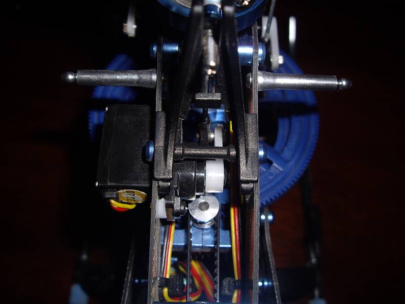

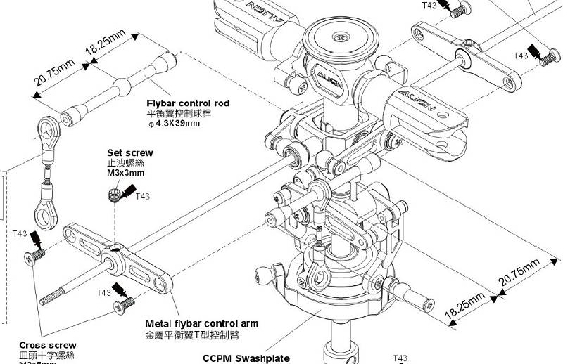

One of the guys on Helifreak just posted and said that he thought that the flybar control arms were reversed. Do any of you see that?
Join Date: Sep 2007
Location: Christchurch, NEW ZEALAND
Posts: 323
RE: TREX SE V2 Build Log
yes they are definitely reversed. In the manual they are called flybar control arm p/n hh4014. They need to be turned the otherway

From the manual and comparing it to the pix I took (Heli is at home <sigh> ) it looks like the Flybar Control ARM is correct on my bird.
But what about the Flybar Control ROD (see pic attached)?

ORIGINAL: BryFlyGuy67

Thanks! I can't tak all the credit. RussWisc has been a BIG TIME help on this build. He's helping me along via PM as I go through the build. It is VERY NICE to have someone help you when you do this for the first time. The nice part is that since I built it from a kit, I will have a lot more confidence in repairing it when the inevitable crash happens.
I am going to check the orientation of the flybar control rod when I get home to make sure that the short side is aligned with the ball link it attached to below. I do not know for sure that this is correct.

Its not right...... If you look at the diagram you will see 2 dimensions on the flybar control arm, 1 is 18.25 and the other 20.75. Note that the pic shows the short side is leading while the long is trailing. What it appears in the fist pic (when you first asked this) and the last pic from you last post is you have one installed the wrong way round. One is correct while the other appear not to be.
I hope you understand what im trying to say.

Yes, I believe that I do. However, since I am new to this, I am working with the terminology from the manual. My read is that the Flybar ARM is installed correct, whereas the ROD is backwards on one side.
I think that we're talking about the same thing.

Good. I will fix that when I get home.

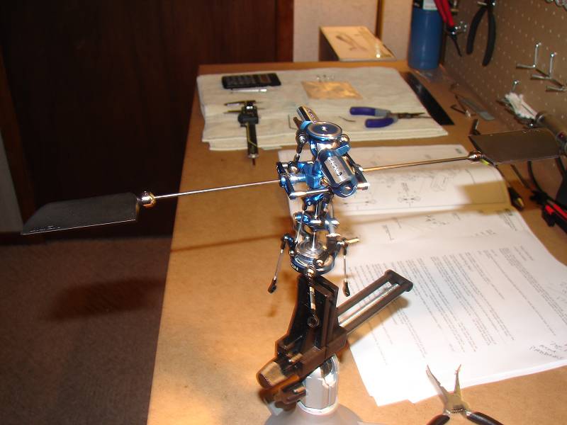

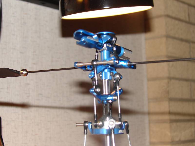

You guys (and my recent experiences) have convinced me: Friday morning I am headed to LHS to get a good set of tools. Before I started on this part of the kit, I did not realize how much the TREX uses hex screws. I have a great set of phillips and flat-head drivers. The little allen that came with the kit is just not cutting it and the set of metric allen wrenches I have seems to be too loose/soft of a fit.
No worries! I got everything apart no problem. Only one rod was backwards. I fixed it easily. I got the frame halves thread locked (I don't have the bottle in front of me, but it's the blue commercial brand) and got the skids attached. I think that I'm ready for the next step, which according to the manual is assembling the tail section.
Here is a link to a slideshow with three new pix:
http://s215.photobucket.com/albums/c...t=1b05009f.pbw
