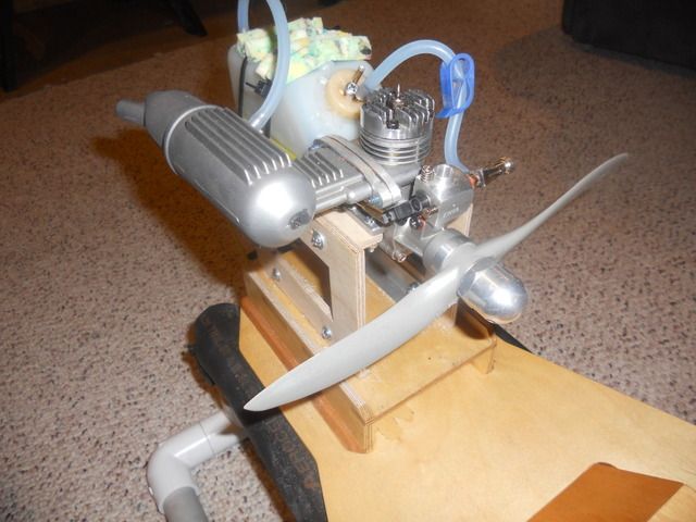

    I dusted the ss30 off, and ran it a little bit. It ran really well as I expected it to.. This is a very nice little engine.
    TT .46 Pro stock muffler
    5% nitro / 20% castor
    McCoy MC59 plug/2 washers
    APC 9x5 sport prop
    70°F air temp, humidity 90%, dewpoint 65°F
    Muffler baffle installed - 14,800rpm peaked
    Muffler baffle removed - 15,210rpm peaked
    Idle speed was reliable at 2700rpm or so, but the engine isnt broke in all the way yet. It has about 3/4 gallon through it on the test stand. I wouldnt be surprised if this engine will idle down to 2400-2500rpm when it breaks in good. Off the shelf I didnt touch the airbleed and it transitioned like a dream.
    This engine doesnt have ideal pipe timing, but it definitely responds to a larger muffler. The baffle in this muffler has been slightly modified. I used a dremel and sharpened the edges of the "fins" of the baffle. They were blunt and square, I just sharpened the edges to improve flow. I'm not sure if it makes a difference or not, as I didnt test it before the modification. Fuel draw is good, and muffler pressure is adequate as it needles very well. At peak, it takes 5-6 clicks before rpm drops.

    What does it rev with no muffler?  I always check mine on the stand this way as a starting point because mufflers are so variable. I like your clip for shutting off the fuel.  I have one too and like it but can't find them anywhere.  I assume it is from a medical store.

    I haven't ran this one without a muffler yet. I venture to guess it will rev 14,000 or so open faced on the 9x5. The stock muffler is quite small, more for a .15-.20 sized engine. Its also quite loud. If I get some time tomorrow, I'll run it open faced to see what it revs on it. Comparing the Enya .30 muffler to the TT .46 muffler, there's a significant gain in power.
    The fuel shut-off clip is actually a part that came on my 1/8th scale R/C monster trucks and I have one on my 1/10th scale Jato stadium truck. I only use these clips to shut fuel off on the little engines because the tank ends up being a little above centerline of the spraybar. Initially, I was running a homemade bladder tank that the little Enya had a hard time drawing fuel once the bladder got down to 1/2 full. Running a normal tank with a felt clunk it runs fine but with a full tank, it will siphon into the carb some. One problem with this carburetor is even with the throttle barrel closed all the way, the engine will run off the air coming in through the airbleed hole. The airbleed hole is too close to the spinning prop to plug so shutting the fuel off works best to shut this one down.
    This engine is running in still, and I'm sure the rpm will pick up a little more. I ran 16oz through it today, so its almost at a gallon now. I forgot I had some 25% castor fuel mixed up so I switched to that fuel today and it ran a little better than it did on the 20% fuel.

    9x7 - 13,500rpm
    10x6 - 13,050rpm
    Compared to the numbers obtained using the stock Enya muffler, this engine has gained a lot of rpm from the various muffler changes. I'm impressed.
    9x5 - 2,390rpm gain
    9x6 - 2,230rpm gain
    9x7 - 1,830rpm gain
    10x6 - 1,940rpm gain
    I am really impressed with this engine. It is by far the most well-mannered engine I own.

    Amazing. The figure for the 10x6 would be very respectable for a sport .40. I guess it's like putting on a mousse can.

    Not bad for a 9oz engine (minus muffler)!
    I'm finding 2-strokes really like large volume exhaust. I'm sure there is a ceiling of how far it could go without going the tuned pipe route.

    Is it better than open exhaust?  That is the real test.  A pipe will do that.  Some mufflers do, but most don't.

    Stock muffler numbers are much less than open faced, about 1,500rpm less. The next time I get a chance, I'll try the same set of props all open faced.

    Enya SS 30bb Open Faced Exhaust-
    32°F, 5% nitro 25% castor, McCoy MC59 glow plug, APC props
    8x6 = 17,010
    9x5 = 15,780
    9x6 = 14,650
    9x7 = 13,830
    10x5 = 13,020
    10x6 = 12,290
    I have not run the 8x6 on this engine before, so when I get around to running it with the muffler, I'll try it.
    Gains favoring the Jett muffler, the loss favored the open faced exhaust.
    9x5 = +170rpm
    9x6 = +150rpm
    9x7 = -330rpm
    10x6 = +60rpm
    Conclusion: The Jett muffler gets very very close to open exhaust AND its a LOT cleaner.

    The 9-7 is slower with the Jett muffler, but in the air with less load it may come on the pipe as the load will be much less with the high pitch.

    That is certainly possible. I doubt this engine will be in the air anytime soon, I haven't earned my wings yet.. Thats okay though.. I have a few airboats I can run it on; that is when I have time.
