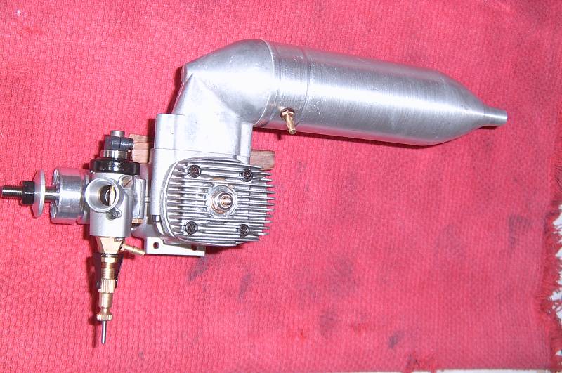

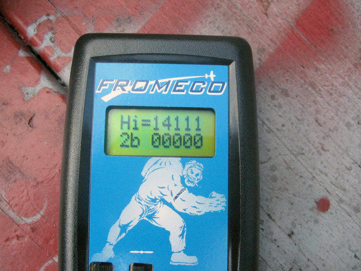

stg61abc, I ran the engine again with a new ST muffler.
Powermaster 5/22 GMA
Rev Up 10x6
14,111 peak
6.33lbs static thrust
1.24hp
Wow! I gained 622rpm. With an APC 10x6 it would probably rev a bit higher still (but, I don't have one).
Thanks for the muffler suggestion! I wonder what it would do on a pipe?

Hi Dave, good to know that the silent muffler worked well for you. I love the sound produced by this muffler, really nice. I have this muffler in my ST GS 40 as an OEM part and is really nice. Super Tigre also made some years ago a series of tuned mufflers called "tiger paw" that were telescopics tuned mufflers in a header, but they were taken out from production.
Also a hot muffler from ST is the tuned muffler specially made for the quickie 500 engine version of their .40, called the ST G-500 ABC. The engine is out of production now, but the muffler is still for sale in some places at the USA

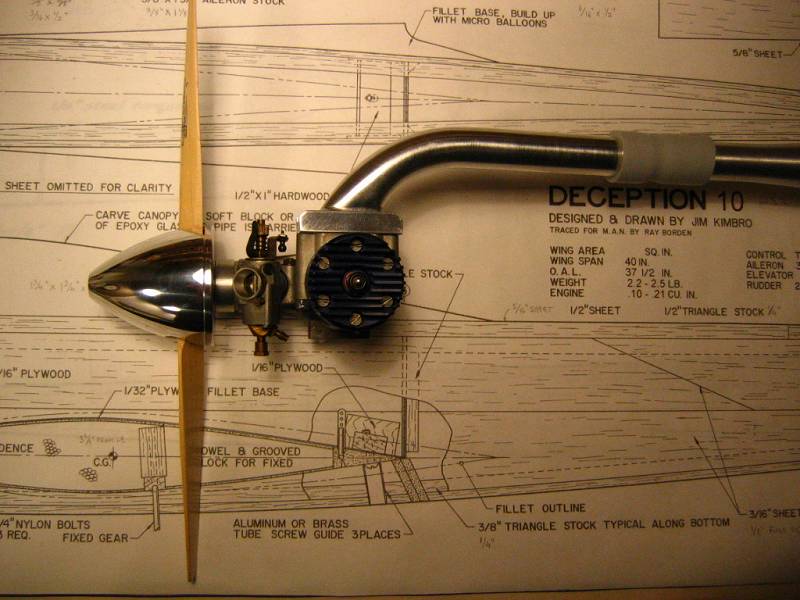

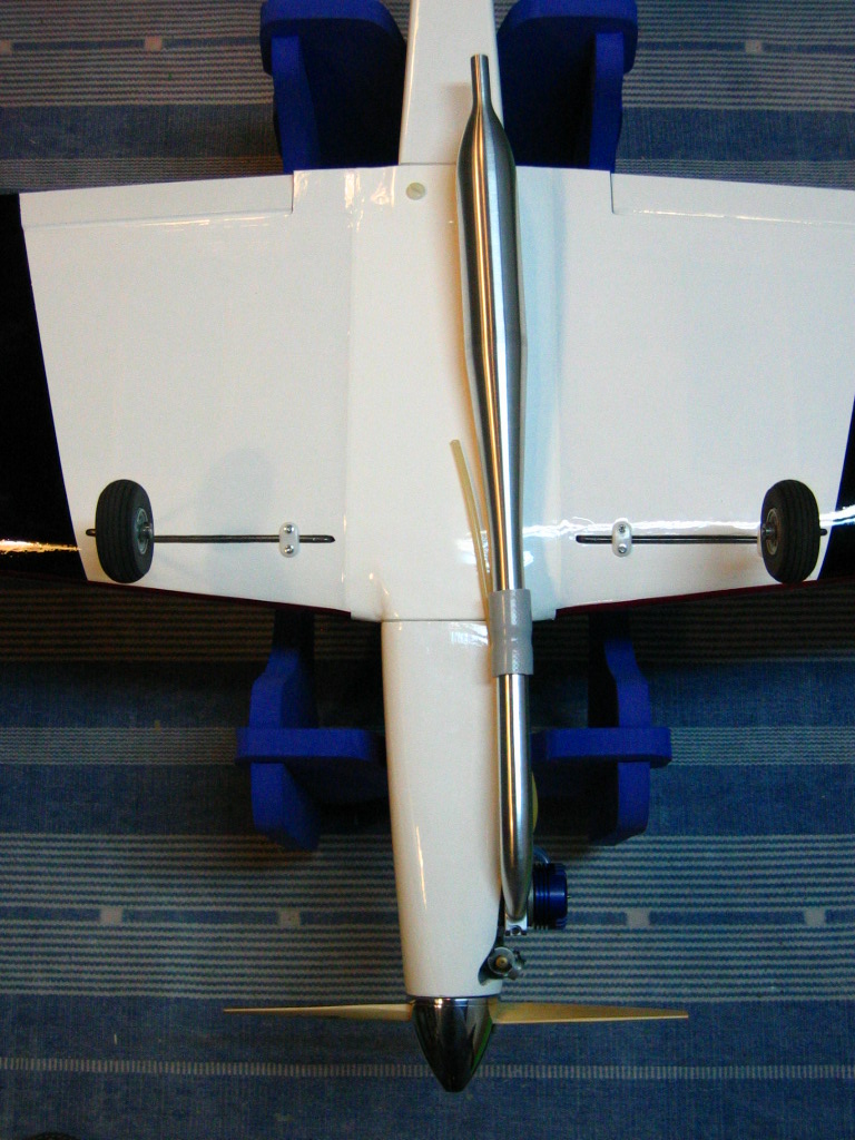

Hey David,
I plan to run this same engine with a Macs 6.5cc muffled pipe and 10x6 and 11x5 props in the spring. I'll report back with some results... 15K on a 10x6!? or maybe 14K on an 11x5?
Cheers, David.

David, your Tsunami looks great.. and very fast. I'm sure that engine will scream on the pipe. Maybe try a 9x8 for even more speed?

Thanks David. I'm fairly happy with how she turned out. As always, a few things that I wish I'd done differently but chalk it up to experience!
I'm looking forward to running that 25+ year old ST! I've never run it on a pipe! I should have some figures sometime in March-April.
The Tsunami is almost finished. I completed the radio installation today so I'll be able to finish up the linkages. More on that in my thread.

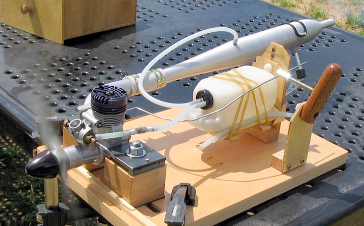

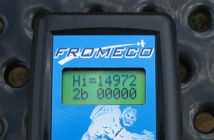

Ran it again today with a Mac's muffled pipe:
APC 10x6
14,972 peak
6.99lbs static thrust
1.26hp
73.9mph
I could cut another 1/2" off the header, go up to 15% nitro and break 15,000, but this is an old engine and I don't want to push it. Parts are hard to come by.

Dave sweet setup. Iam considering something similar on my MVVS 40. Just need to decide what airframe, (like i'm in a hurry)
Ijust need to get the header for it and Iwill make a tuned pipe.

rainedave,
Impressive numbers there.

Outstanding figures David!
15K it is!
From the stock muffler at ~13.5K gaining almost 1.5K on a pipe is impressive!
I'm glad I didn't decide to retrofit the Tsunami for a YS 45. Although speed is fun I'm also curious about how she'll stand up to higher loading - an 11x5. I think I'm going to do the final push on the Tsunami this week and get her ready for takeoff. Beforehand, some testing of the bluehead will be required. It'd be nice to have an APC 9x8, 10x6 and 11x5 on hand.
What's the length of your header at present? I'll cut mine 1/2" longer to try out the 11x5 for a starters.
BTW, do you have the conversion formulas for thrust, hp and pitch speed or does the Fromeco do all that for you? Iguess pitch speed is easy to convert from RPM.
