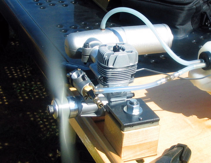

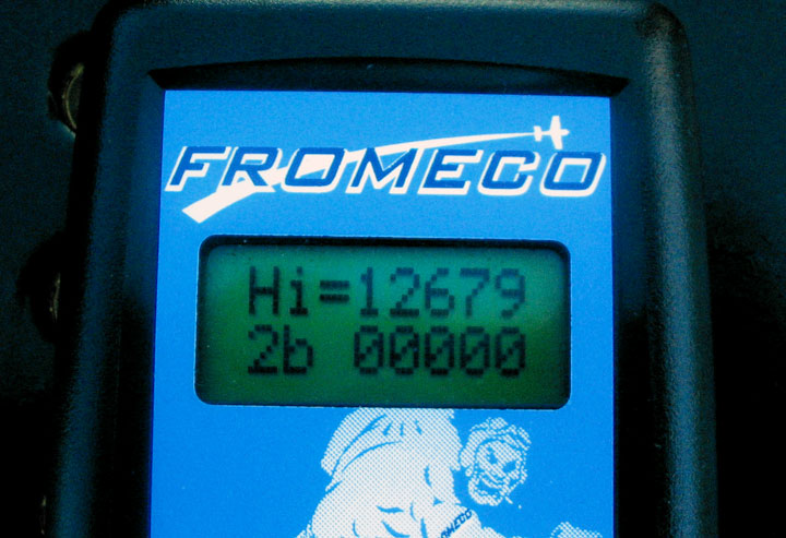

SR, I ran and tached my Italian G.51 today. Here's what I got:
temp: 77°
Powermaster GMA 5/22
K&B 1L plug
APC 11x6
12,679
6.35lbs. static thrust
1.13hp
For comparison's sake, here's what my ST G.45 did with the same prop and fuel:
12,853
6.52 lbs. static thrust
1.18hp
David

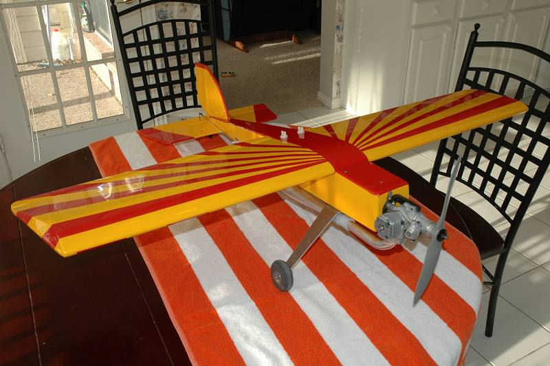

Final numbers are in. 72 degrees and 98% humidity - been raining off and on all day.
G-51 with about 96oz of fuel through it:
Stock muffler and APC 12.25x3.75: 12,200
Stock muffler and APC 11.5x6: 12,180
Macs 2961 header and an old disk type quiet tuned pipe:
APC 12.25x3.75 - 13,170
1 inch off the header:
APC 12.25x3.75 - 13,700
5/16" off the header:
APC 12.25x3.75 - 13,910
1/4" off header
APC 12.25x3.75 - 13,980 with a lean pinch just over 14,000
Geez, that is insane with close to 10lbs of thrust! I can pretty much swap the 11.5x6 with the 12.25x3.75. Numbers are close to identicle with the 11.5 being 150 to 180 behind the 12.25.
I may need to go back and do some re-enforcing on the firewall of my 4lb Das Little Stick!!!!
here is a pic of the Little stick with an OS46AX on it but I'm going to put this 51 on it.
Thoroughly impressed with this engine. Very good slow idle and a decent transition.

Very impressive numbers! Yeah, I would epoxy some triangle stock behind the firewall. And, go over all glue joints; make sure you have the wing center section wrapped with glass cloth, etc.

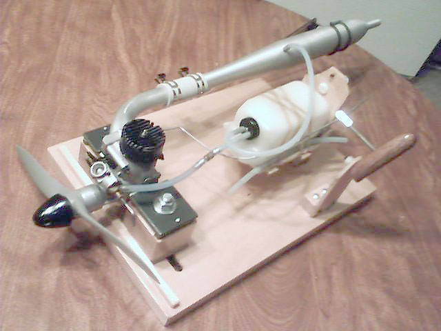

I put a pipe on my Super Tigre .40 Bluehead. It's already turning a 10x6 at 14,111 with a stock muffler:
http://www.rcuniverse.com/forum/fb.asp?m=8181884
With the pipe I expect to break 15,000. It might be interesting to lengthen the header and see what it does with an 11x6, too.
I had to send my Canon camera in for service, so this is a poor quality cell phone photo.

The plane already has a glassed center wing, glassed firewall with triangle stock and a slather of epoxy all in the fuel hatch so I'm hoping it is enough. I'm using an 8oz Kirklands water bottle for a fuel tank. They are short and fat and exactly what I needed after I cut 3/4" off the nose of the plane when I was building it. Can't wait to fly it.

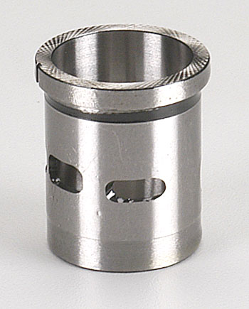

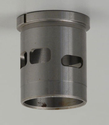

Thanks DU. Here are photos of the two parts, r/c on left, c/l on the right. They have different part numbers, too.
The exhaust ports look taller on the r/c sleeve.
David
