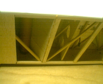

Over the course of the last 1 1/2 years, I put piece by piece together again. It took about 2 oz of CA to put back together a 46% Cap. I used every single piece that I could figure out how. It was the "expert" level 3 dimensional jigsaw puzzle. I mean everything from about mid-fuselage (from the elevator ) and forward was splinters and foam pieces. I used RC56 glue for the foam pieces, and CA (and acclerator) for the balsa and plywood pieces. Everything went back together again. The cowl and canopy were the only things that were not reasonable to try and repair. The cowl was in about 20 pieces but what was left was very helpful in terms of setting up a new cowl.
Where are we? Well, after assembling the rear fuselage from the back moving forward... and the front part of the fuselage, from the front bulkhead back, the final joining took place last Spring.
This winter, I've got the firewall box rebuilt (the engine box sides and firewall had do be made from new wood) and engine mounted so far. Things are starting to pick up. I also got the wing tube back in place. (see pictures).

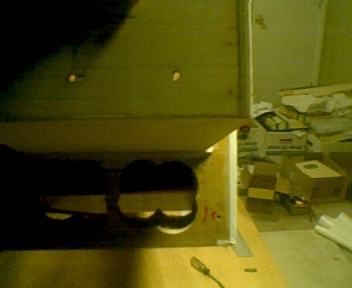

Put in cannister clearance holes. 10 of these through the thick, beefy front bulkhead and gear mount box saved about 4 oz. The key to this is using a hole drill. 4 holes for each cannister hole. Pipes are not an option becaues the wing tube is in the way. Cannisters will allow for quiet operation that is now required at many fields and competitions.
I took at least 3 oz out of the tail section from the servo mounts- 8 pieces of 1/4 x 1/2 x 7 inch spruce plus all the epoxy that was used to put them in. While going to three 8611 or 8711 servos for the rudder up under the canopy section rather than four 8411's in the back of the fuselage, plus the four servo extension wires back there. this should save about about 3/4 pound out of the tail. Since I plan a much lighter engine up front the CG should be close. I"m figuring that 3 Lb lighter engine/cannster setup over the engine that was set up originally, plus a half lb out of the tail. I'm going to go from a 48 Lb plane down to a 43-44 Lb plane which will make it fly very well at 3200 sq inches of wing area.
Got the white on both fuselage sides. Making progress.

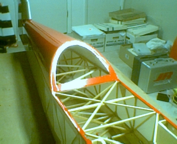

I'm flying a JR 10X radio. The servos will either be 8611A's or 8711 servos which will work very well. Top of fuselage covered. They layout took exactly one roll split (half roll left and half roll right) of white. one roll for the bottom and about 3/4 roll for the top deck. Ultracote red and white. The covering technique is to cut a template from paper, taped in place. The trace the edges and cut the slot for the rudder. Start with an iron (covered with a sock to prevent scratching) and go from the top center, front to back, then work your way down from the top to the sides, pressing out the air and getting a good bond between the covering and the balsa.

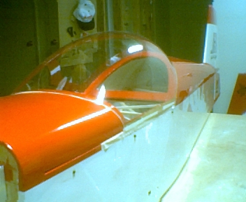

Default RE: Rebuilding a destroyed wood aircraft

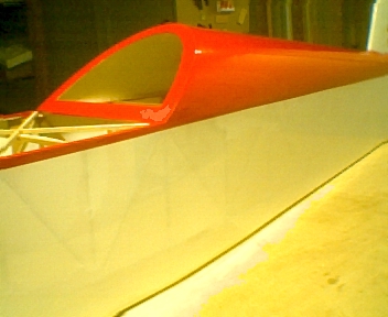

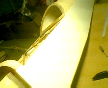

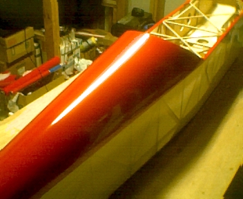

Canopy hatch finished sanding this and re-covered. Mounted a new canopy. It fit perfectly. Re covered top of rudder. A picture of the cowling. This one is too far gone to repair. Over 30 percent is missing. The replacement cowling fits perfectly. Its a one piece cowl and is about 4 oz lighter.

WOW...
That is an amazing amount of work to ressurect a gorgeous aircraft. Turned out beautifully, Don. Lots of sticks in that one.
One question - are the main rails running the length of the fuse 1/4" balsa as well as the bracing members? Or spruce for the rails?
