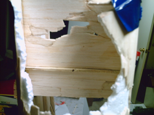

Default RE: Magic VF3 building thread

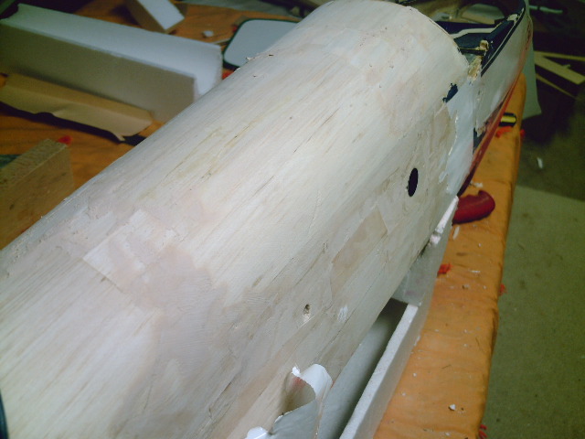

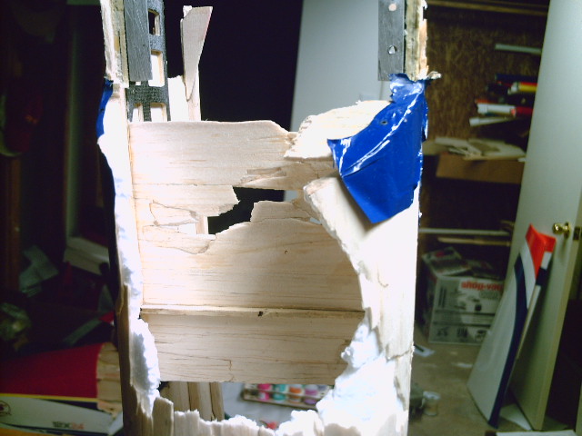

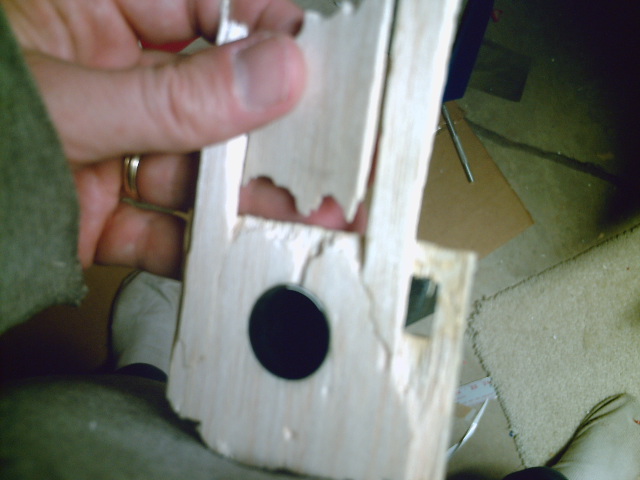

A piece of aluminum the size of a ball on the end of an ink pen- found its way into an unused port of the rx, shorting the pos and neg. That piece originated from one of two holes I drilled in angle bracket for the landing gear re-enforcement. I put this L bracket in because the field I was flying at was so rough, this worked well (held up in the crash too).

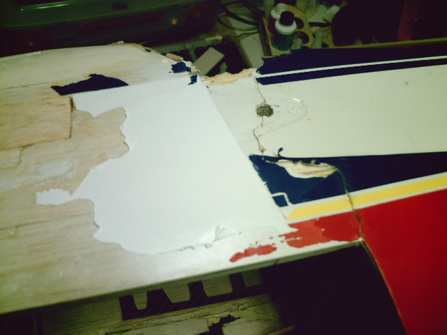

Pieces then go together. Each piece ranged from about 1/8 of an inch to several inches long, building larger sub-structure pieces. 1/3 of an ounce added from thick CA and some thin CA, and 1/4 ounce of foam safe CA. Average speed of re-assembly was 6 pieces per hour. I was never good a jigsaw puzzles. Average of one hour per evening. 3 weekends.

Smaller subassemblies fit into larger sub-assemblies.

Trial fit of larger pieces on fuselage sides. Patience, endurance, dedication, thinking about getting it back in the air, getting back in the race, back into competition. Thinking about getting motivated, picking yourself up, get back into the groove. Squint your eyes, get on the simulator, work at it. Glue some more pieces. Don't let up. Spring will be here. Flying season will be here. Its in the blood.

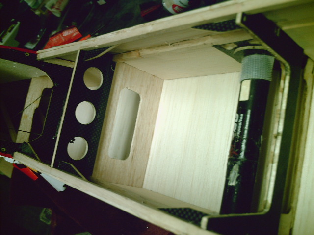

Inside refurbished with some new 1/16 and 1/32 light balsa... Looks like new.... Break Time with the girlfriend. Rest, relax and watch the 11 O'clock news. Love and kisses courtesy of daughter.

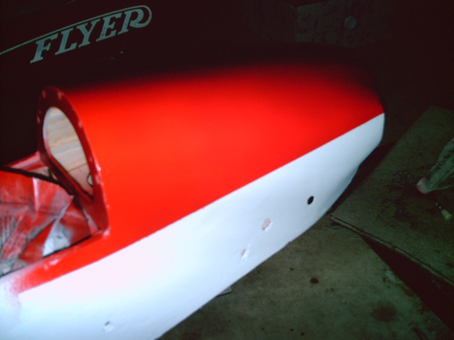

Couple coats of primer and a red coat.

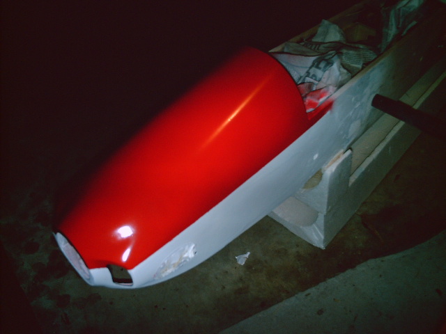

Fuselage covered, canopy fitted, ready for trim and clear coat.

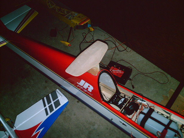

New Twist.

OK Don, gotta ask.  Why the T - canalyzer.  It does nothing on this plane.  The V3 has no use for it.  The T canalyzer only will hurt the performance on this plane.  I have flown the new F pattern as well as the current F pattern and there is nothing to be gained with a canalyzer.  Chip flew mine last week and even said it is as close to his passports as he has ever flown.  The canalyzer only helps planes that have rudder deficiencies or vertical fins that are too small.  Neither is a problem the V3 has.
Just curious as to the thought process,

Jim,
Yes, I actually put one on my Mantis 3 years ago right after CPLR went and played with it.  I made one for my Mantis like Chad Northeast did for his Enigma's.  I honestly could not tell a difference.
Arch

jim woodward
Join Date: Sep 2006
Location: boca raton, FL
Posts: 415
Mike,
It would be interesting to see Don's notes.  Here is my take on the effects of the T:
1.  Reduces rudder sensitivity around neutral
2.  Adds yaw aurhority
3.  Pushes/pulls/ all lock on a little better
4.  Gives "carve" in yaw instead of "skid"
5.  Small heading corrections easier to apply
6.  Adds positivie pitching moment with rudder application - how much seems dependant on how tall it is
7.  Doesn't affect roll mixing
8.  Plane will deviate less from the intended line during rolls or point rolls
9.  CG assessment - allows you to fly a nose-heavy plane as measured statically, but in flight it will  "roll" and maintain 45 lines like a more neutral plane
10. Elevator - maybe some more pitch authority but not a drastic difference
11. Stall Turns- some can feel a difference, It is barely noticeable for me
12. Spins/Snaps - uneffected for the conditions I fly (snaps high rate aileron, spins, full rudder/elevator, tiny aileron).
Abbra  -mid wing, Aggressor, mid/low wing, Osmose, mid/low wing, Passport, low wing.  The basic effect was the same for each of these planes.  For me, it just makes the FAI maneuvers easier and less work.  I've also flown the Passport with YS 170, now with CDI, Electric (with and with our SFGs).  T-can and no T-can, used the CA models T then made my own when I lost the original - even with small dimentional changes to the T nothing was changed as to the effect it provided the model.
It may be different for the VF3 though.  You've had a lot of input on the plane for the past couple years for sure, and congrats also on developing a new bird too.  Nothing to relax about here - airplane trimming and setup  is one of the best parts of pattern to me.
Jim

Don Szczur
Don Szczur's Avatar
Join Date: Jan 2002
Location: Chantilly, VA
Posts: 2,159
Received 14 Likes on 13 Posts
Jim,
Here are my comments I'll build on your's
Absoultely 1.  Reduces rudder sensitivity around neutral
Absolutely 2.  Adds yaw aurhority
Absolutely 3.  Pushes/pulls/ all lock on a little better
Absolutely 4.  Gives "carve" in yaw instead of "skid"
Absolutely 5.  Small heading corrections easier to apply
Yes.  However, I noticed a better transition from point 3 to 4 of the 4 of 8 reversed as a result.  6.  Adds positivie pitching moment with rudder application - how much seems dependant on how tall it is
It has affected my roll mixing.  It acts like additional dihendral.  It stands off about 2 1/2 inches, so probably 1 1/2 or 2 would reduce this 7.  Doesn't affect roll mixing
Agree 8.  Plane will deviate less from the intended line during rolls or point rolls
Agree, I will need to move my battery forward as a result.  Plane holds inverted with very little down elevator now. 9.  CG assessment - allows you to fly a nose-heavy plane as measured statically, but in flight it will  "roll" and maintain 45 lines like a more neutral plane
More stability around neutral in pitch, and roll (very noticeable on a snap exit- it exits softer and more predictable. 10. Elevator - maybe some more pitch authority but not a drastic difference
Less likely to wiggle after stall turn.  11. Stall Turns- some can feel a difference, It is barely noticeable for me
Spin and Snap no adverse effects.  12. Spins/Snaps - uneffected for the conditions I fly (snaps high rate aileron, spins, full rudder/elevator, tiny aileron).
What I can't understand is why the full scale aerobatic planes have not tried this yet.
