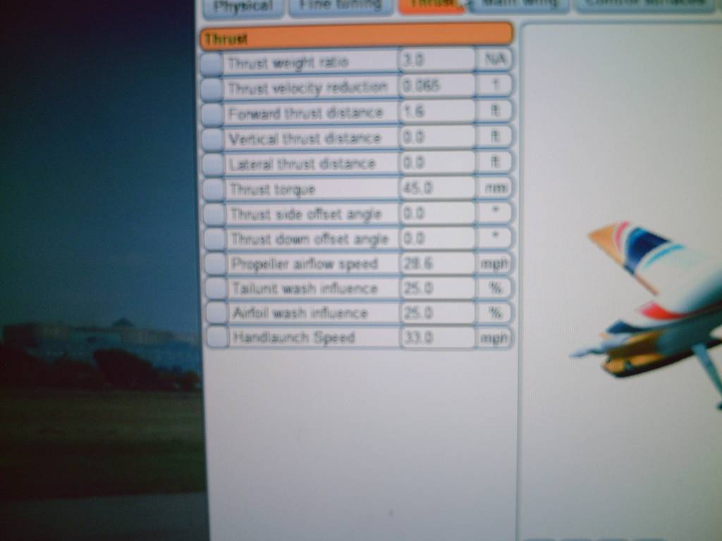

Well, here it where I'm at right now for those interested:
ID:	1378034   Click image for larger version

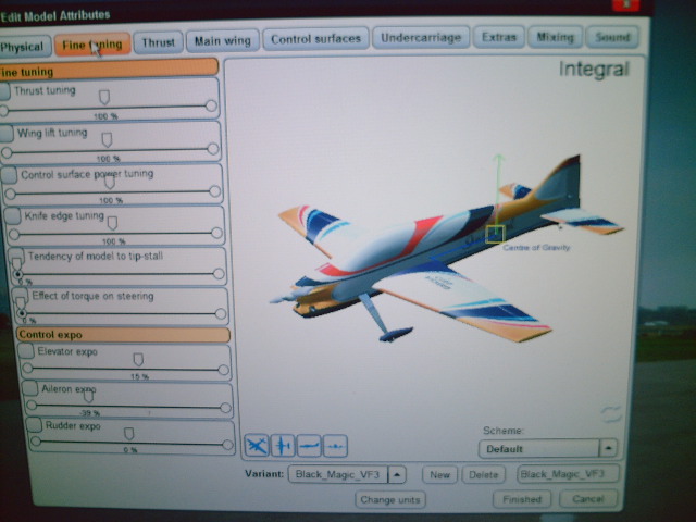

Default RE: Black Magic VF3 setup on Phoenix Mulitplayer
And the rest
ID:	1378036   Click image for larger version

Don, thanks for your efforts here! Question: why did you go with positive expo on the ailerons?

Positive expo feels about right with this setup. I've also got the .pxv file and can send directly if anyone interested, let me know your email.

ORIGINAL: wagen017
Volkert
Don Szczur
NOMB and strictly a SWAG but it is possible that 'Volkert' is a Futaba user and is confused by the positive and negative differences.
It's a thought-
onewasp is offline
Reply With Quote
Old 02-19-2010, 02:11 PM
wagen017
Join Date: Oct 2003
Location: Eindhoven, NETHERLANDS
Posts: 969
Gallery
My Gallery
Models
My Models
Ratings
My Feedback
Futaba it is!
wagen017 is offline
Reply With Quote
Old 02-19-2010, 06:08 PM
onewasp
Join Date: Dec 2002
Location: USA
Posts: 2,035
Gallery
My Gallery
Models
My Models
Ratings
My Feedback
ORIGINAL: wagen017
Futaba it is!
___________________________
Ahhhhhh on Futaba if you decrease sensitivity on a control you are entering NEGATIVE Expo. (from this perspective you are REDUCING control sensitivity around neutral so it is NEGATIVE.)
On JR and Spektrum if you do exactly the same thing you are entering POSITIVE Expo. (Positive because from their perspective you are ADDING something which is POSITIVE.)
Both manufacturers are correct in their statements. It depends on the chosen perspective as to whether it is positive or negative..
Clearer now ???

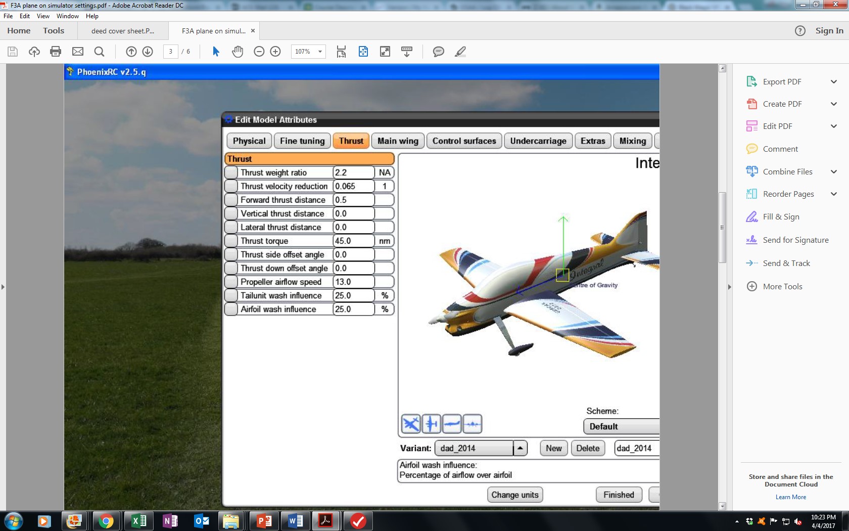

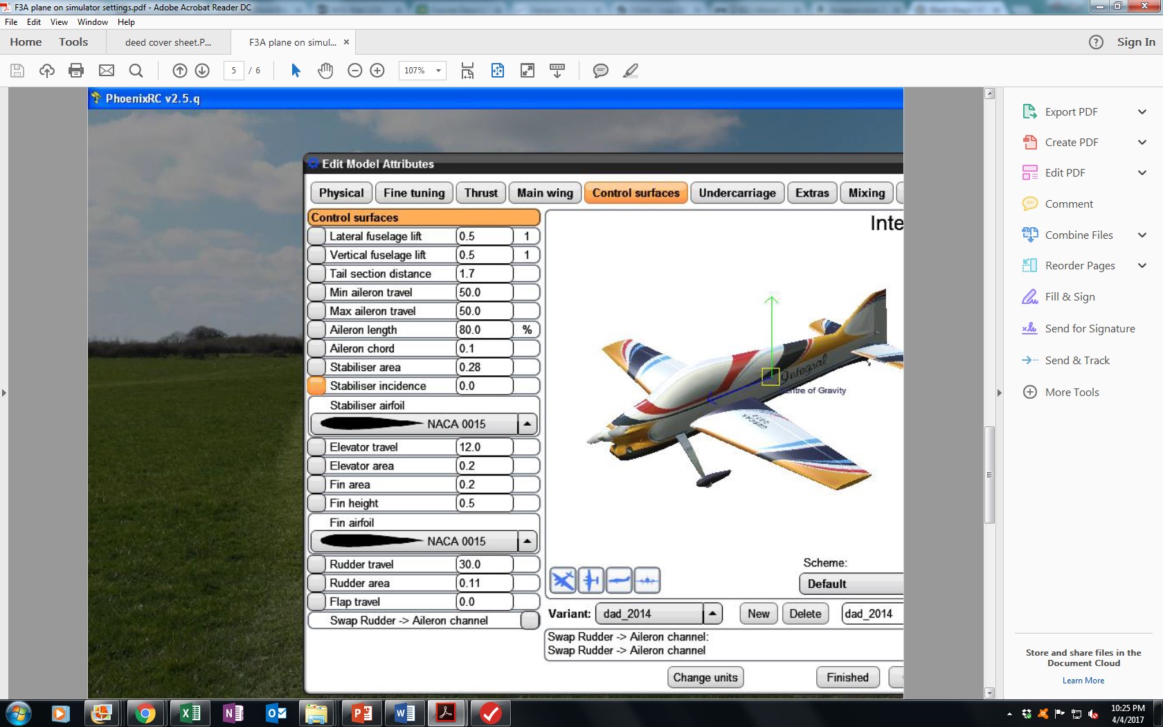

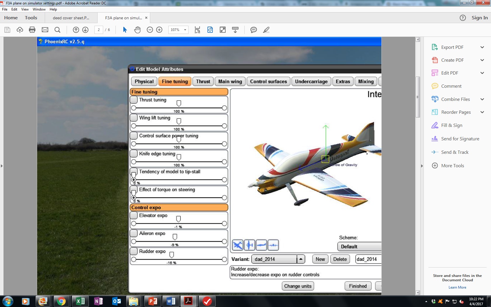

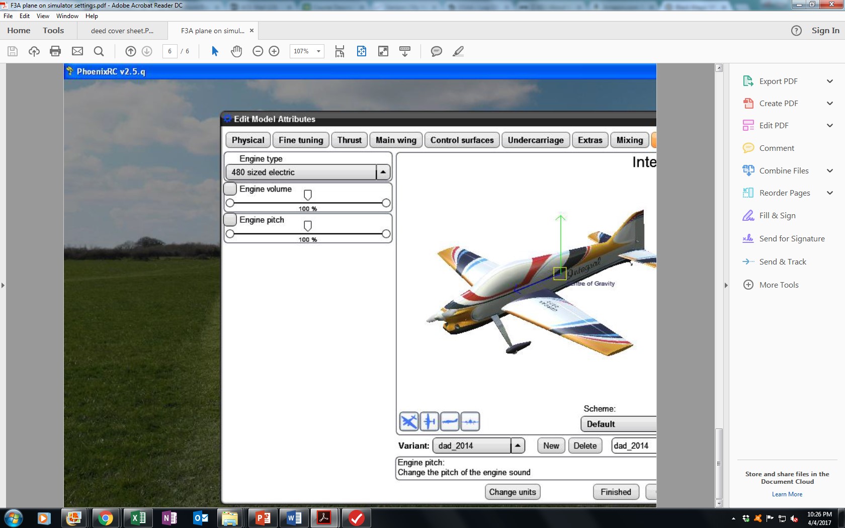

Ratings
My Feedback
Back by popular demand after last weekend's "become a better pilot" NSRCA D2 event. Here are the settings.

first
Name:	settings 1 pattern plane.jpg
ID:	2208465   Click image for larger version
Name:	Settings 2 pattern plane.jpg
ID:	2208466   Click image for larger version
Name:	Picture 3 pattern plane.jpg
ID:	2208467   Click image for larger version
Name:	Picture4 pattern plane.jpg
ID:	2208468   Click image for larger version
Name:	Picture5 patttern plane .jpg
ID:	2208469   Click image for larger version
Name:	Picture6 pattern plane.jpg
