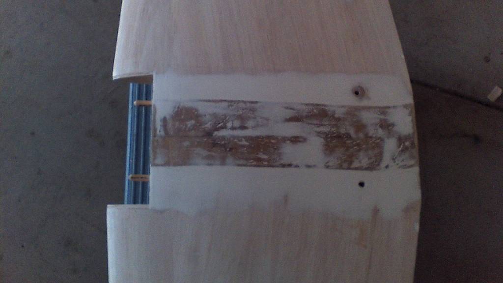

Glassing balsa mid-wing
I'm to the point of strengthening the balsa mid-wing joint/section of my RCM Trainer and need some advice at this point. What glassing process guarantees a smooth transition where this area is not visible under Ultracote? I read somewhere that one can use saran wrap over the area working all bubbles and wrinkles out but I don't know the specifics or if there is a different way. Any suggestions are appreciated.

RE: Glassing balsa mid-wing
Hi!
What you have done in the picture is fine but not the best way of doing it!
A much better way is to use thinner glass cloth (25g) and put on several layers (3-4) in different widths. That way you don't get a sharp ridge where the glass ends. What happens when you put load on the wing is that it might (will) break where the glass fiber ends , like tearing toilet papper.
And do not use the glue variety of epoxy!
Use laminating (24 hour ) epoxy! It's much thinner and easier to sand and most important ...Oracover (which is the best plastic covering) stick to it better than epoxy glue.
ORIGINAL: jaka
Hi!
Hi!
