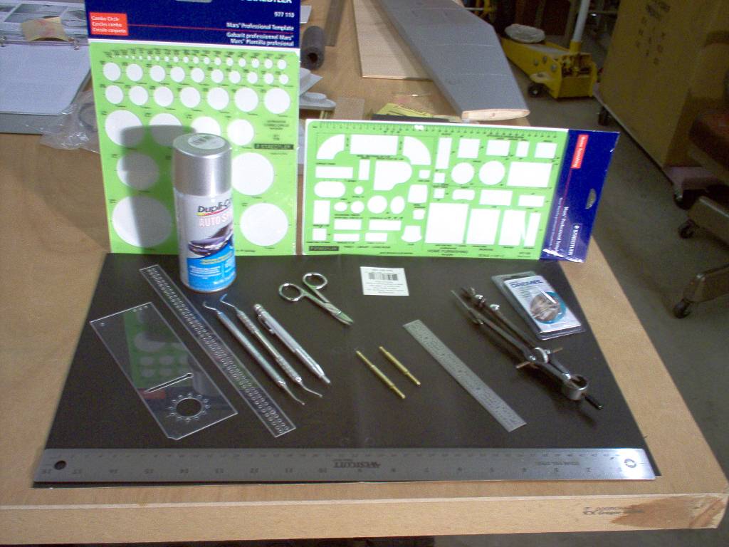

Tools needed are scribes, carbide straight, ( Lowe's ) and dental picks ( they make the beat scribes ) They are so hard if you try straighten one out it will break off but once it's sharpened it will stay sharp. Go to your dentist, they just throw them away. Rulers, the thinner the better and if they don't have cork backing you can spray them with contact cement and when it dries it's not sticky. Now your rulers won't slide around, we don't want a slip at this time. Styrene clear sheets to make rivet patterns, fuel tank and hatch handels and so on. !/6"and 1/8" brass tube.

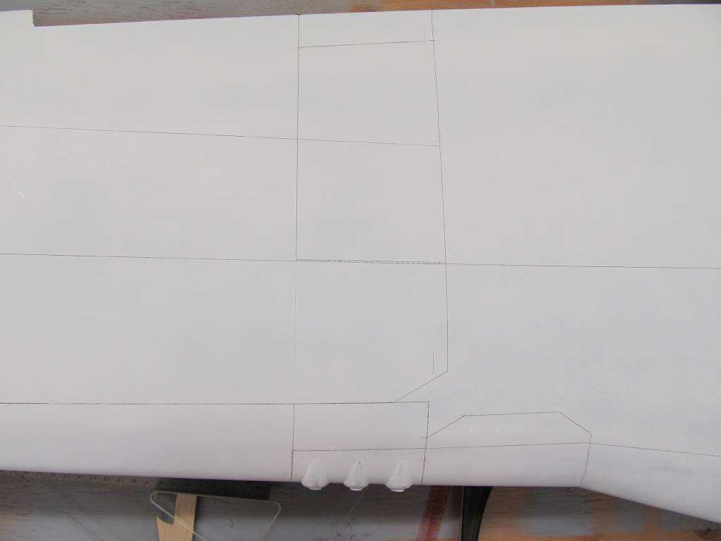

Lay out the pannel lines by very lightly marking with a # 2 pencil, don't mark any interior lines until all pannels are scribed. Fine line between pannels and a little bolder line where hatches are, it gives them more depth. Your not going deeper, just broader, remember, primer thickness is all you have to work with. I should add at this time, you should have made a test pannel finished the same way the plane is preped so you have something to test on and get a feel for it

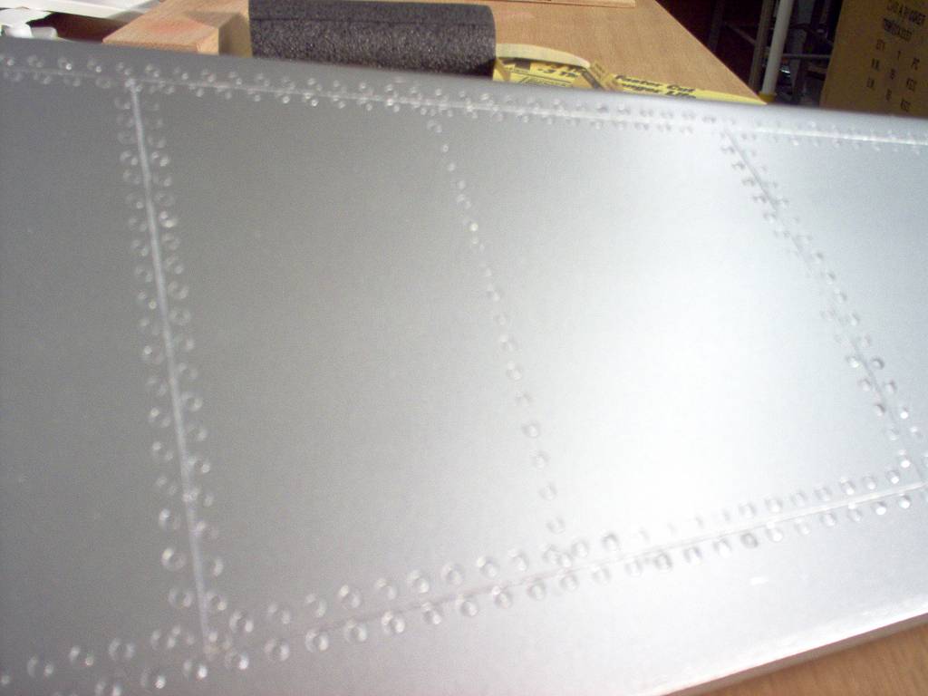

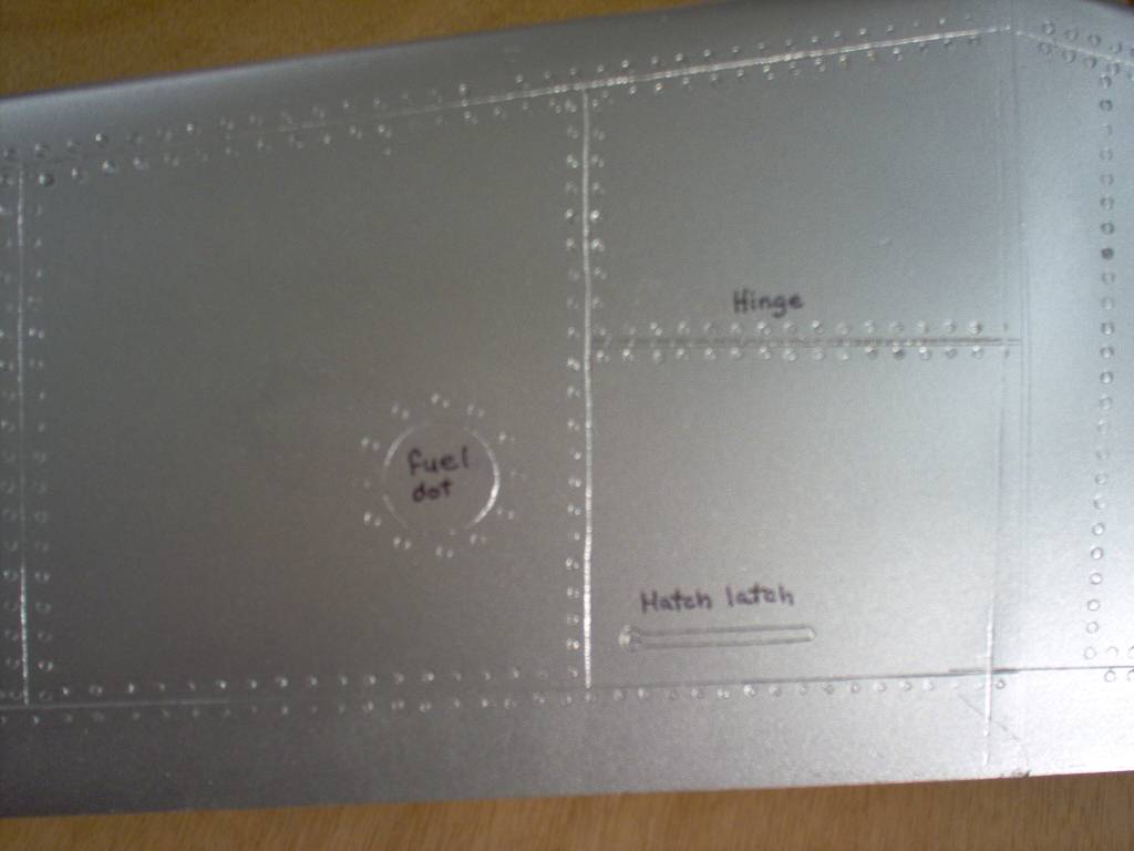

Making rivet tools: Start with a 1/16" brass tube about 2 1/2" long, it will make scale rivets for 1/5 and 1/4 planes. For 1/5 scale the inside diameter will be used. Make sure the end of tube is square and taper the outside about 3/32 long until it reaches the inside diamenter. Use a fine grinding wheel and go slow turning between thumb and forfinger There is probably a burr inside the end of tube, remove it with a Dremel tungston carbide cutter #9909, It can also be used to enlarge cutting size. keep cutting edge sharp for best results. The rivet guide addressed on page one will be drilled with a 1/16" drill bit. The Dremel cutter can be used to de-bur it. I used a Dremel drill press to drill mine and it turned out very nice. I also slid a 1/16" x 1" tube over Cutter and put a drop of CA thin on it to keep it from sliding. Cutter for 1/4 scale is done in the same way but chamfering inside of tube and a guide with 3/32" holes.
Making the rivets: Lay out pannel lines and scribe them, use a thin ruler. cork or contact cement backed to prevent sliding around, you don't want a slip at this stage. Now rivets: with guide you made align center scribe on pannel line and tape or hold firm and insert tool in a hole and turn tool between thumb and for finger foward and back. Heres where the test pannel comes into play, to help determine the pressure needed to cut the rivet. Remember, you only have the thickness of primer to work with. A faint rivet will show up better than you think. Do all 10 inches and move guide sligning last hole. If it's a big plane plan on spending some time and support the parts so they don't rock or move around. Zouse? fasteners are done the same way useing 1/8" tube.
The pictures don't look as good as the test piece, some of what you'll see in them is the results of poor preping resulting in poor adhesion of primer in places and the center of rivet lifting out because of it. I never went to the trouble to prep it right because it was just a test piece, well I won't make that mistake on the plane. My plane is a TF gold edition 1/5 scale P-51D kit built. Plane is built but it will probably take longer to detail and finish than it did to build. Now for some picts..
Don't know why pictures did'nt show? Try again. For some reason picture post can't be found so it's not up loading them. Something wrong here,never had problem before. I'll try again in the morning.

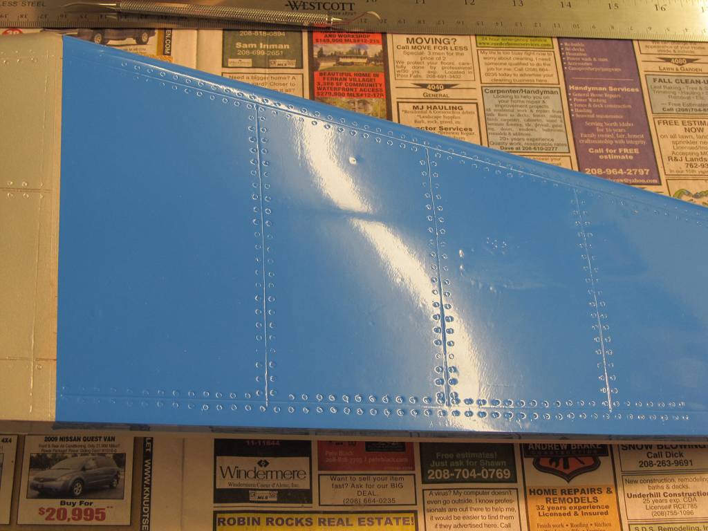

I'll try the pictures again. SO where the H- are picts?. "Oh yes"'

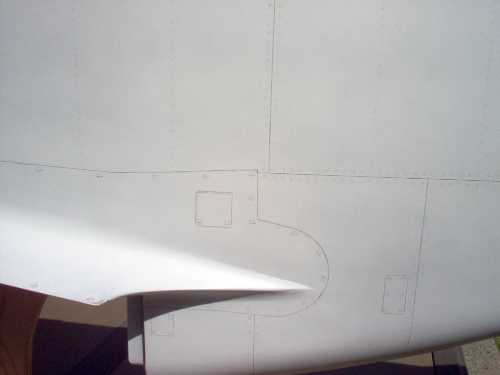

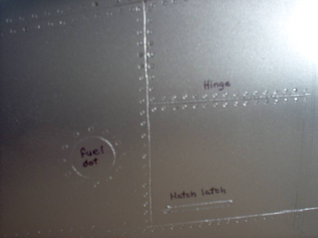

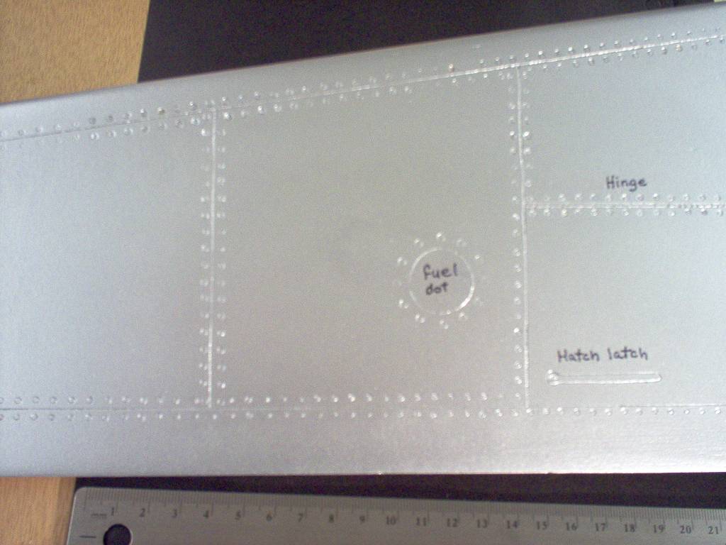

The pictures don't do justice to how they really look but will give you an idea what can be done scribing details. There are tools used, and the paint for this test is Dupli-Color from spray can. I sprayed full wet coats on half of test and 3 fogged coats on other half and it never made any difference to appearance of detail. You can see the size difference of rivets useing the two different cut tube scribes. the sharper the tubes the better they look. I'll fine tune my scribes to get better pannel lines, this is just a test to see what works best. The hinge really looks like a hinge, I was impressed with how real it looked, the fine cut lines are 2/32" apart with segmented cuts every 5/16". Most hatches that open have hinges like gun and ammo bays.
Styrene sheets are easy to cut with razor sharp blades and drills and make great patterns to scribe with, you can go as far as you want detailing your plane. When it's all done don't forget to wipe it down with prep-sol to remove dust and finger prints prior to paint, and keep your hands clean!.[&o]
I'll check back from time to time and answer questions. My question is, when you can do this, why would you want to burn them? Leroy[8D]

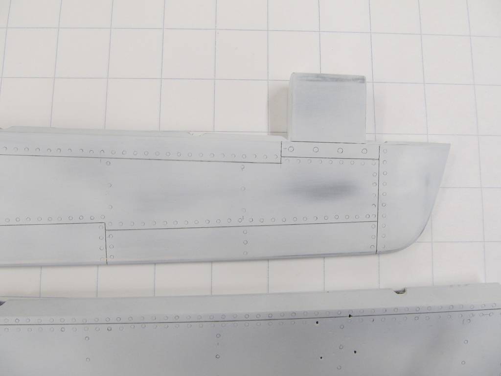

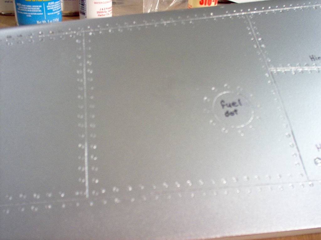

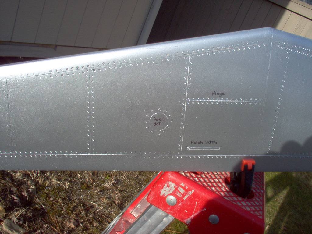

Hi Dash, thanks for reply. Yea, I don't know how this would work on epoxy. it's pretty hard stuff. I use laquer for two reasons, 1 it's the lightest of all paints and 2 you can top coat it with most any paint, well now 3 you can scribe it and get a very realistic look and thats what I want. You might try laquer some time and you won't go back to epoxy, unless your going to do flight-metal over it, thats what they call for. One thing I found out is how fine a scribe showes up, different colors will show differently but the scribe still comes through. Aerosol sprays are the best paints because they are so light and fine whereas heavyer bodied paints will have a more filling effect on fine details and will require a bolder scribe. When I started out I was'nt sure how much painting would effect the scribes so I used both light and heavy pressure cutting scribes and was surprised and pleased at the outcome. Now it's a case of practice makes perfect.
First pictures I posted I wasnt happy with, they were taken under shop lights so I took another set out side in natural light, shade and sun,"wow" what a difference. Silver is very reflective and details really show up. Like I said this is a test piece just to see how it comes out and now I'm sure I can do a uniform job on the plane. I'm starting to get a little excited about finishing this bird, it's been a long time coming. Hand and shoulder surgery has held this up for nearly two years but all is well now,"thank God". Leroy

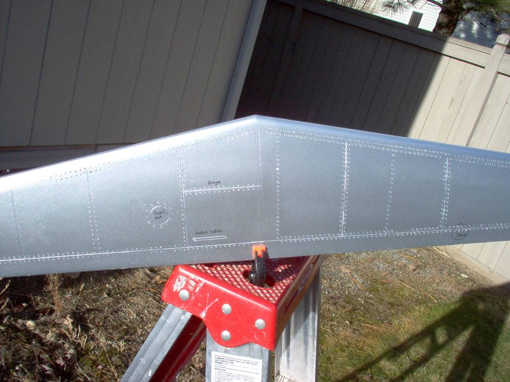

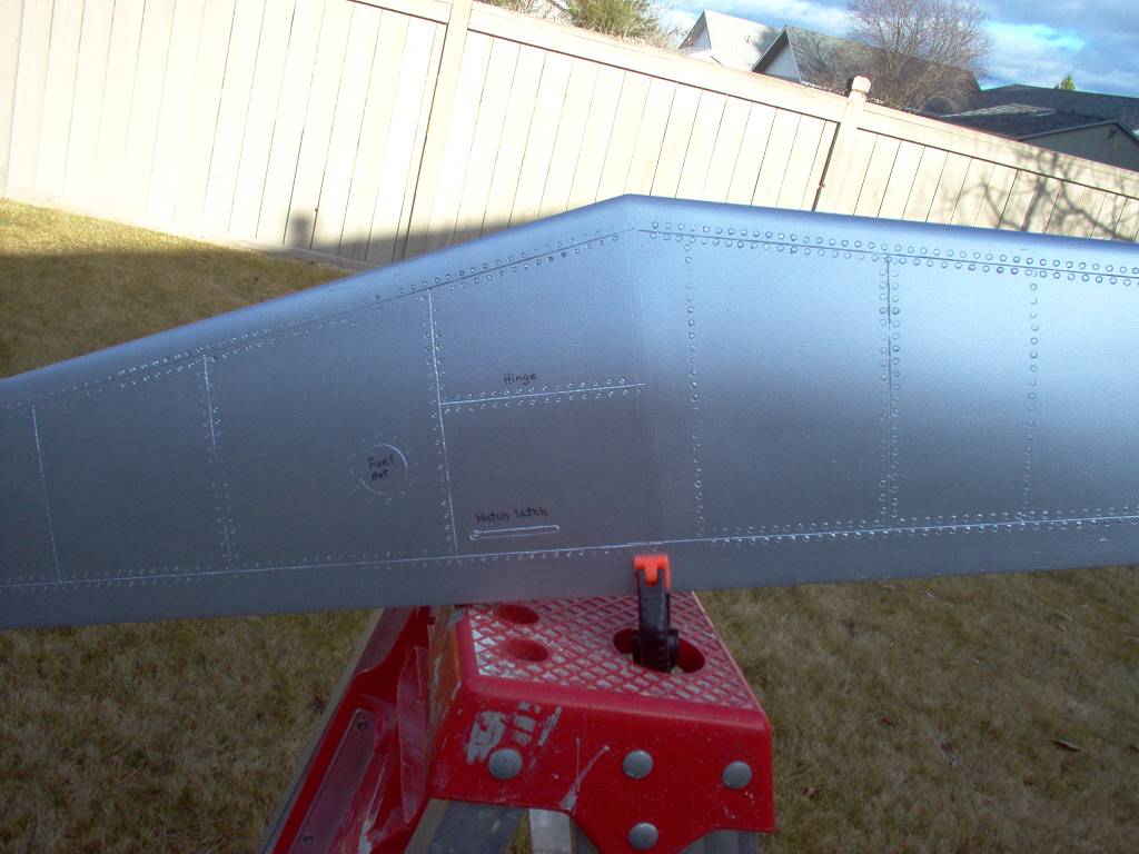

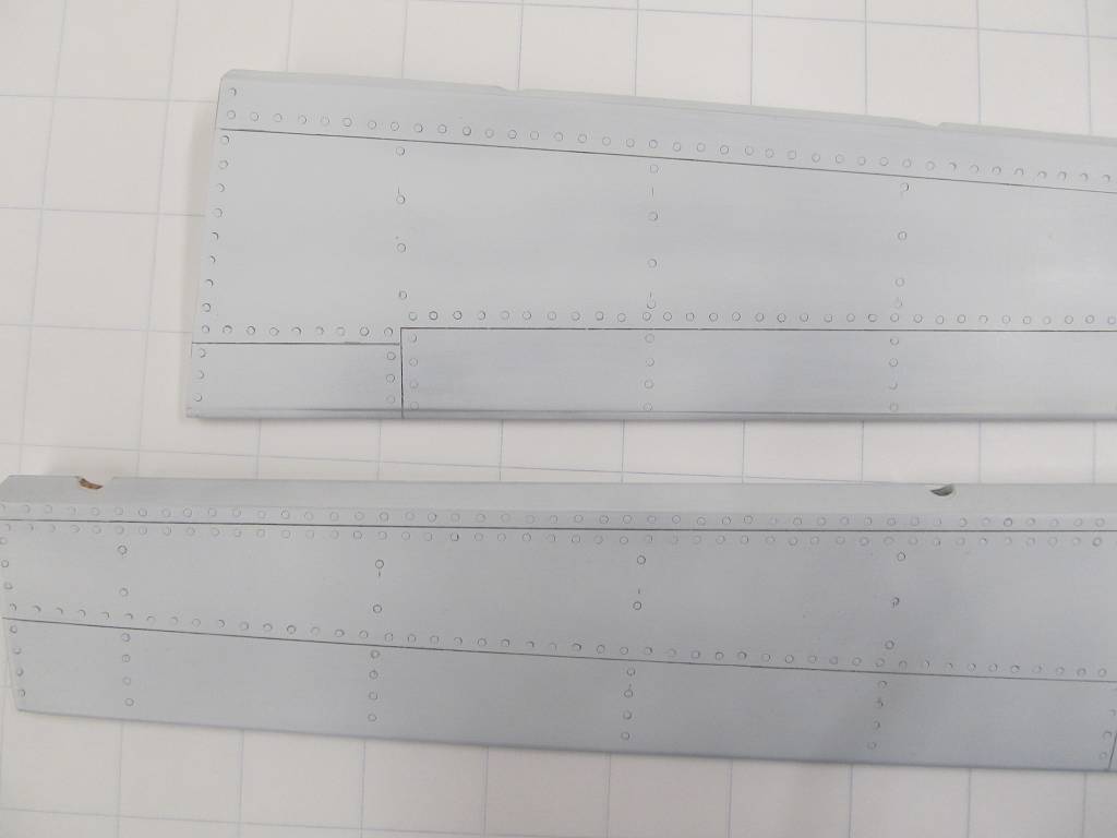

I carried the rivets a little further to include Ultra coat and Flite Metal, results speak for them selves, Any body do this stuff any more? [] Leroy

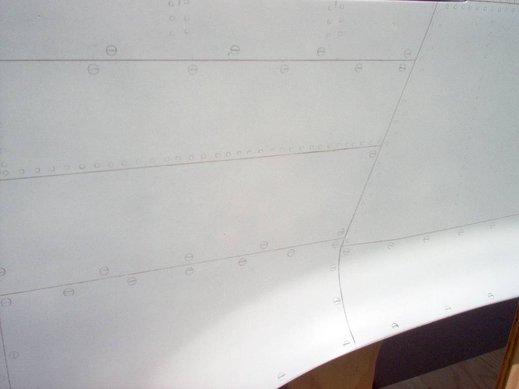

The rivets above are made with a 1/16" brass tube sharpened on the inside and when turned in the inside bevel actually raises it a tiny amount. My rivets are not harsh, they are suttle and they will show up without jumping off the surface, other words they look more real than many others I've seen. Perfect for the all out scale guys doing flush rivets. Raised ones are a different matter. One other thing, keep the cutter sharp and make sure the primer coats are stuck to each other to prevent lifting of the centers. the guide holes are also 1/16" and I used the the Dremmel cutter to chamfer one side, it helps to guide the tool into it. I just finished the wing and was surprised (pleased) at how fast it went. Once you get a rythem going they move right along. I'm guessing around 13.000 rivets before its all done, I'll be damned if I'll do all of them, after all it's only a sport scale mustang. It's looking good! Leroy

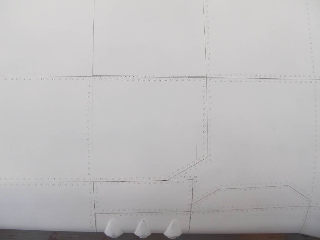

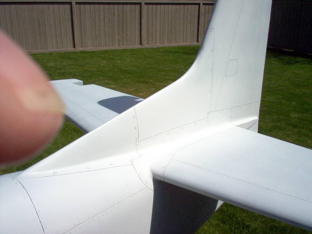

This will be my last pictures of scribed details, fuse. is finished and it's time to paint. I'll do a thread on finishing after it's painted then the results will really show. Pictures just don't show as well as they do to the naked eye. Leroy
