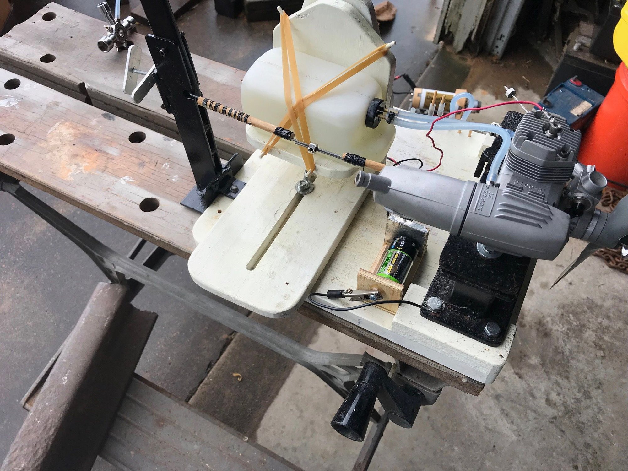

I made this engine test stand when I got back into RC. The engine, with muffler installed, can be easily attached to and removed from the stand. Overall it has been a good engine stand. With use, though, I found it needed some mods done to it.
On the original build, I made the manual throttle actuation out of wood. While it worked good it had problems. I added an idle speed stop screw for setting engine idle speed. Every time I moved the throttle to idle, the screw would dig into the soft wood leaving a hole and erratic idle setting. So my first mod was to make the throttle actuation out of steel. Now the idle adjustment screw hits a steel surface and provides for a good idle speed setting. In the remake, the throttle pushrod came out too short. So I cut it and made a 2 piece adjustable throttle pushrod. So far it works good.
Next mod. I found that working with these engines you may have to start them a few times. This required getting the glow igniter out often. So I added an onboard glow igniter. Flip the wooden handle forward powers the glow plug. Flip it back and power turns off. I tested it today. Used some old fuel and engine a bit hard starting. But it finally ran. Glow igniter a good add on. I have to tidy up the wiring.
One more mod to do. But got I got involved in a big, time consuming, project so this mod is on hold. When I get it done Iíll add to this thread.
This is just FWIW. It works for me.

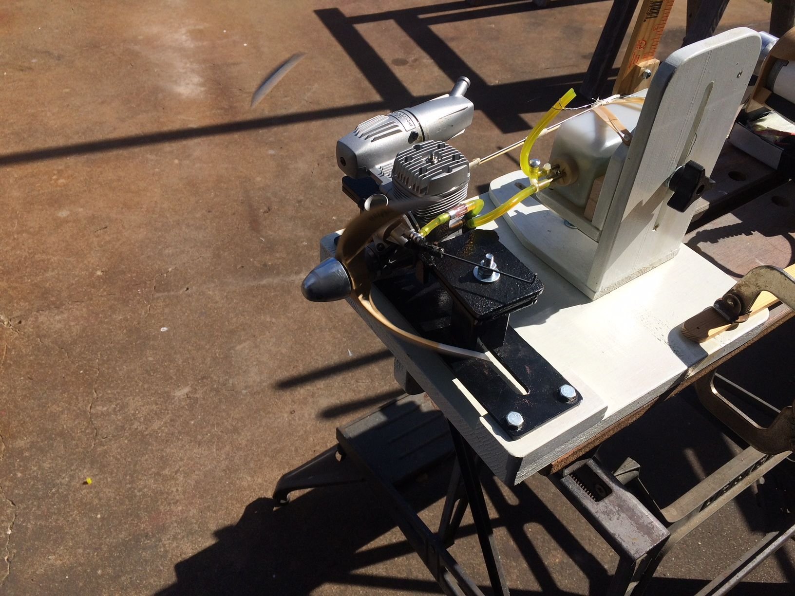

Thanks, just making it more convenient to use. Safety wise, I use it with my workmate workbench. The bottom of the stand is like an I beam. So the stand has to slide on the workmate. No chance for it to twist off. Itís held in place with the workmate vise and the hand clamp is just added security. I also add a piece of heavy railroad track to make sure the whole setup cannot flip over. You can see that piece in the second picture.
The Tatone stand was one I looked at when I was designing this stand.

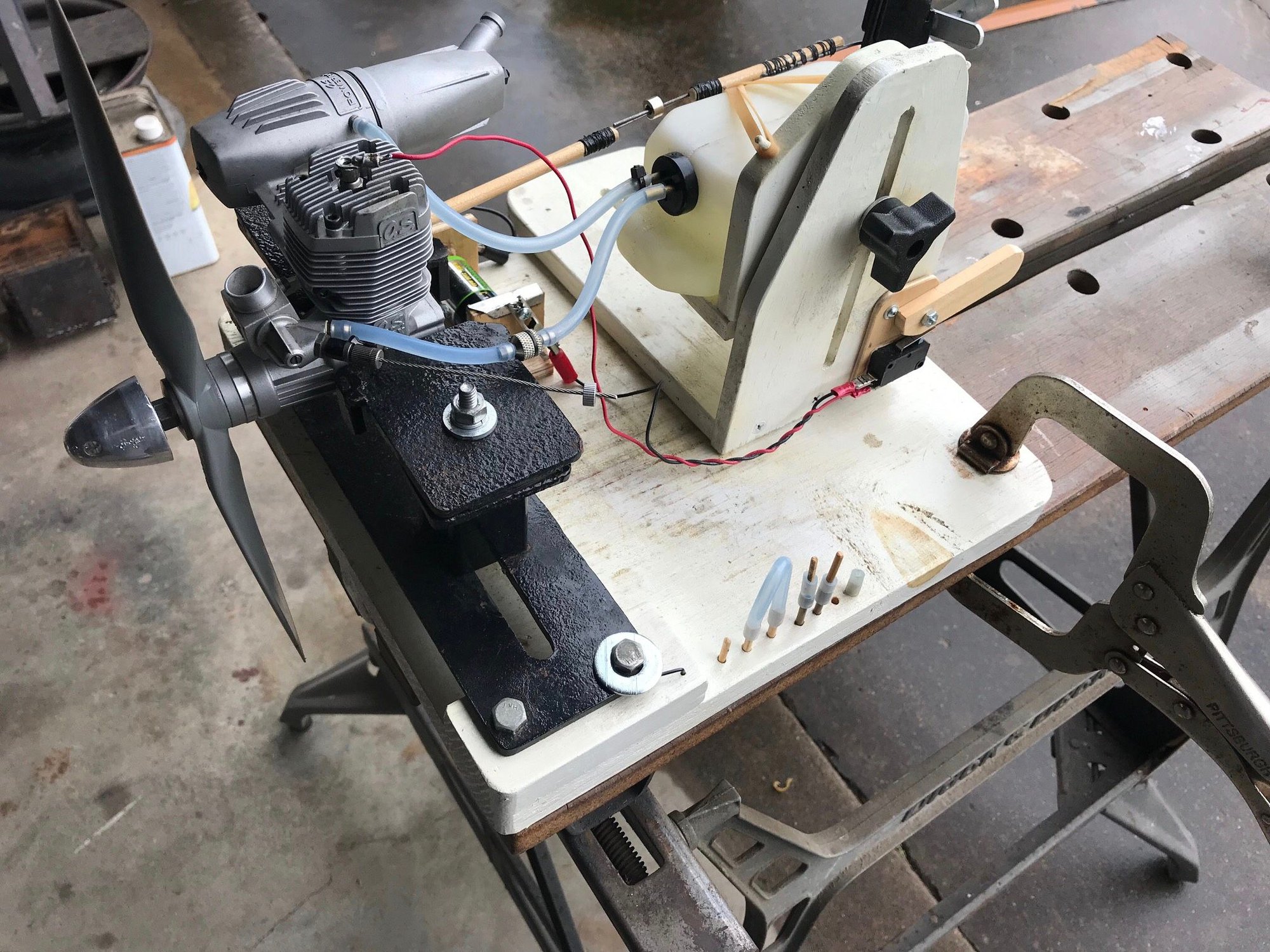

I think I may have looked at that test stand, too, when designing this one. I like the fact that the engine is pinned to the stand. I added pins to my stand. Plus I made it adjustable for different engine sizes. If I ever get into rear mount engines I can make an adapter to attach those engines to the stand. It will be a long time before this one wears out. Fuel is not affecting the wood so far. I appreciate keeping things a long time. Good luck with those engine break in.
