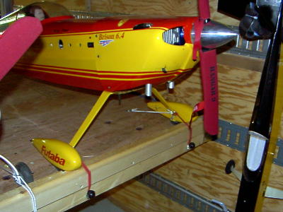

Okay,
Here is the start of outfitting the new (used) trailer. I first started by installing a platform about mid way up in the trailer to create a shelf for two of my bigger birds. You can see that I have also hung two of my smaller models by the tail in the front section of the trailer. This is why I recommend a trailer that has a front side door option.
You will see that I have used 3/16" bungy cord as hold downs. Note the rack system, it is what they call "E" channel and special brackets that fit a 2x4. I have used 1/2" ply as my shelf deck.
I still have to develop a wing storage area and since most of my planes are the two piece design, it should not be too tough.
I also have to create an area for tool boxes, etc. to prevent them from sliding around on the floor. I may build some shelving in the front end.
Please post your trailer photos for all of use to benefit from.

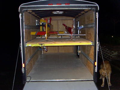

This is a photo showing the shelf. The model on the left is my 36% Edge, the one on the right is my 27% Extra 300xs.

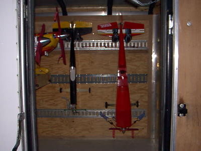

This shows my Somethin Extra and AW Edge 60/90 on the racks.

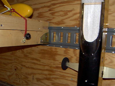

Default Detail of support bracket
Here is a close shot of the "E" channel system I spoke of. You can see the special bracket that locks into the channel and is your 2x4 support.
I will post exterior photos when the sun comes up!

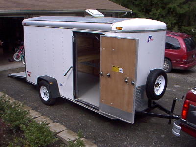

Default Some exterior photos of my 6x12 Pace American trailer

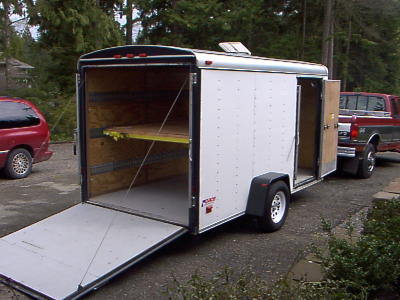

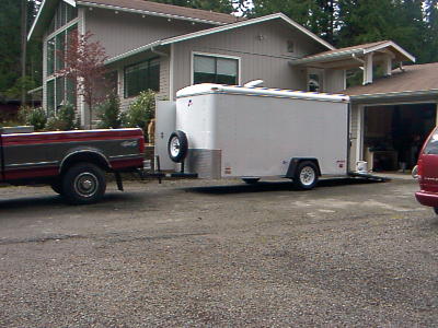

Here is a shot from outside.

Outside view again.

One more time!

I bought the trailer used from a neighbor for $3,600. I then spent around $100 for a few more pieces of the E-track system. I needed to have a shelf at mid level and the E-track that was installed was not where I wanted it. However, it will come in handy for tye downs.
The suspension is an independent torsion system and it tracks very well behind the truck.
I took it out yesterday and I am very glad I went with the 6' width. The 7' would have been too wide for my mirrors and the wheel wells would have been too close to the lanes for my liking.

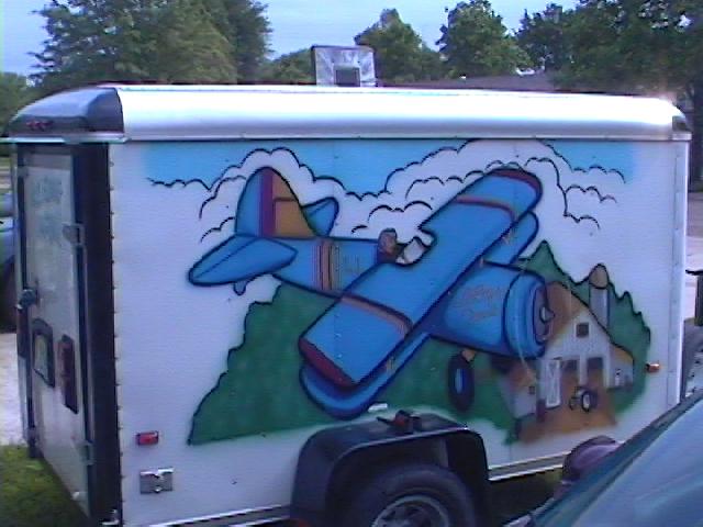

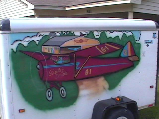

I have not layout on the inside, but thought I would show the outside.

The other side

Don't you have this listed for sale???

What kind of paint did you use on the outside? I've had my trailer for 4 years and still can't deciede what to paint on the sides.

Be careful what you paint on your trailer!! There are guys waiting to take what you worked so hard to build. I prefer not to advertise what's in my trailer.

I am not sure what kind Of paint is on it as I bought it from a Widow. I do have it for sell Crash and Burn.
