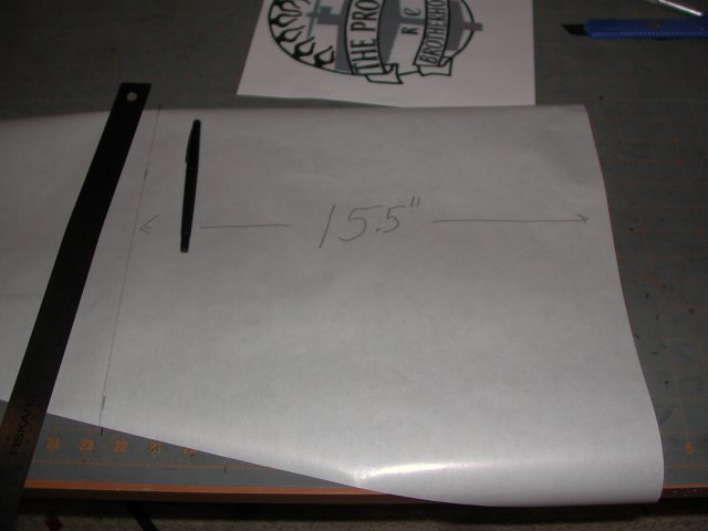

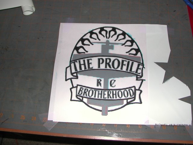

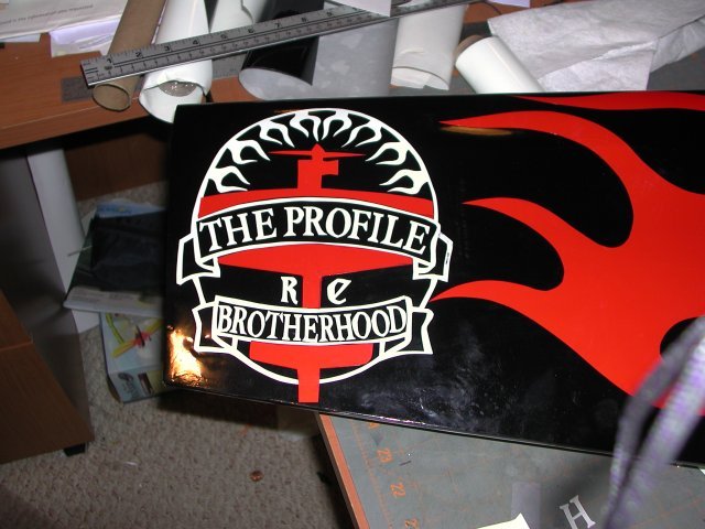

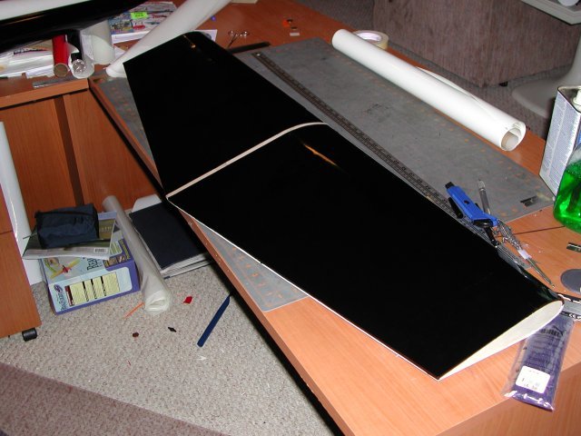

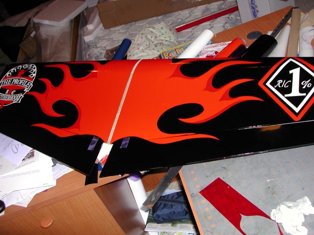

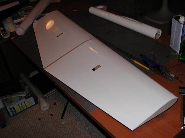

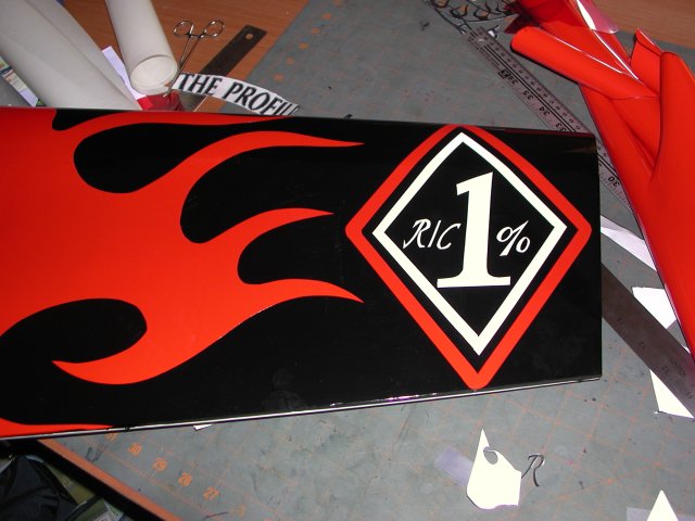

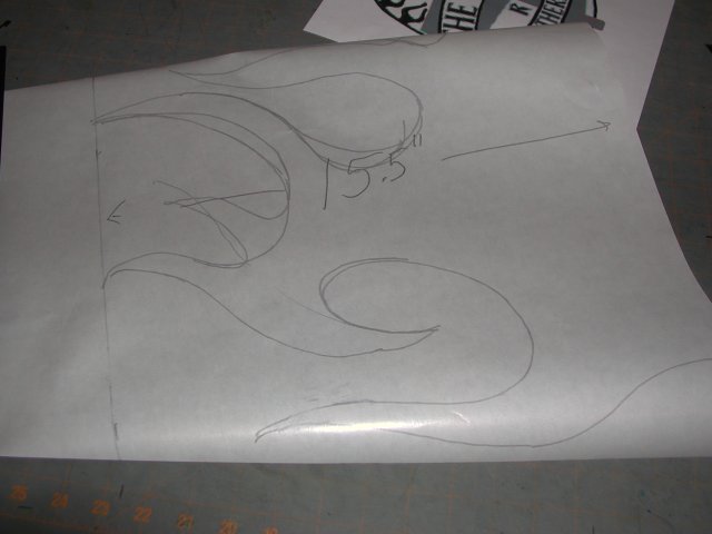

Here some how to on useing Heat and Windex to apply graphics. The plane is a Morris Hobbies Sledge 540. I used Ultracoat white and black to do the base coat on the wing. The red on the fuse is monokote.
pic 1 &2 show the top & bottom of the wing
pic 3 is the graphic that will be used
the graphic was saved off a web page and turned into a negitive so as to save my printer from running outta ink, the top of the wing will also have some red monokote flame ontop

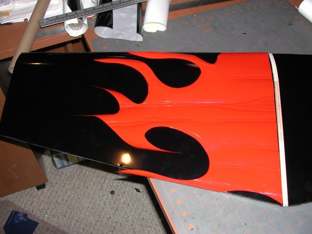

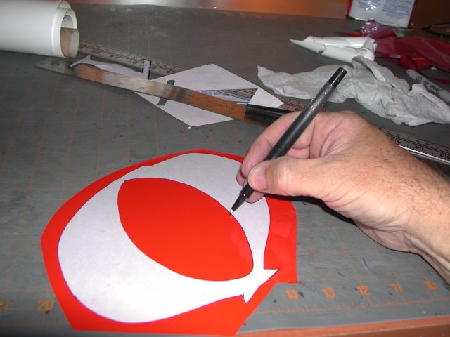

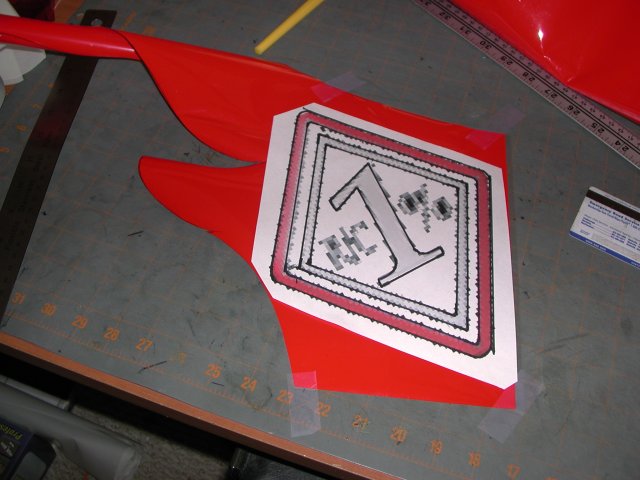

In pic 1 I use some of the ultracoat backing to free-hand the flame on. I also need to keep in mind that I want to have the graphic out on the wing tip, so with the graphic on paper laying ontop of the wing I measure out to the graphic =15.5", this keeps the two graphics from over-laping
pic 2 shows the free handed graphic, this was cut out and then traced over the top of monokote with a felt-tip pin
pic 3 the cut out monokote laying on the wing

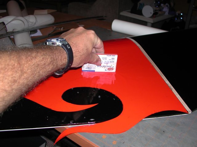

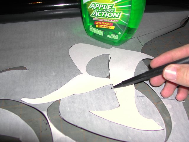

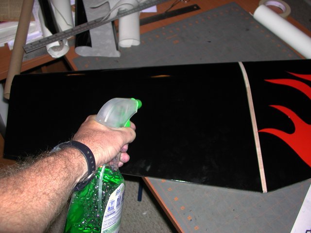

pic 1 shows the windex being applied(its actually Lysol cleaner, its a little more oily'r than windex but works just as well, its just what I had on hand at the time.
pic2 useing an old credit card to squeegy out the liquid
pic 3 shows the graphic, taped down on a piece of white monokote, the backing has also been removed from the covering just to make it where the knife#11 blade won't have as many layers to cut thru

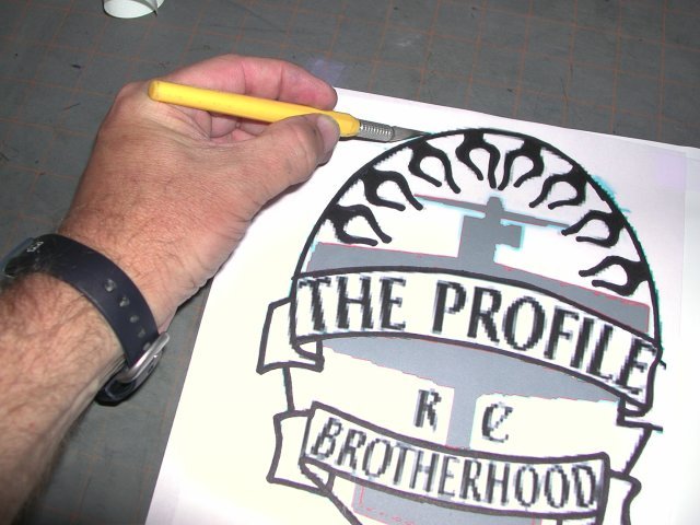

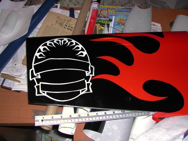

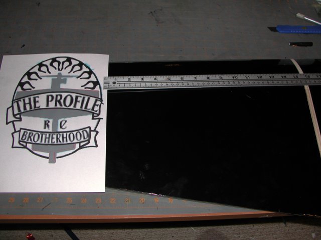

pic1 cutting out the graphic
pic2 the graphic laying on the wing, The letters that say ''THE PROFILE BROTHERHOOD" were not cut out yet because the graphic that was printed on the paper had alot od disstortion, so I just sized other letters in a simular font and cut them out seperate. the letters took the longest to cut out maybe about 70 min
pic 3 showing the graphics with the lettering
this graphic was ironed on, it was way to flimsy to try to use windex plus too many edges for the credit card to get caught on

Hey Gator,
I tried this method a couple weeks ago on my Burrito. Most of the areas went great but just behind where the sheeting stops there was still noticable covering sag between ribs. My graphic was on both sides of one rib. I could get one side to lay down or the other but not both. I tried to carefully heat the wrinkling area to try to shrink it down so it would lay down but it really made it worse. What is the trick to correct this? I'm sure you've ran into this before after seeing many of your pieces of art.
Thanks,,,basmntdweller

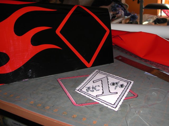

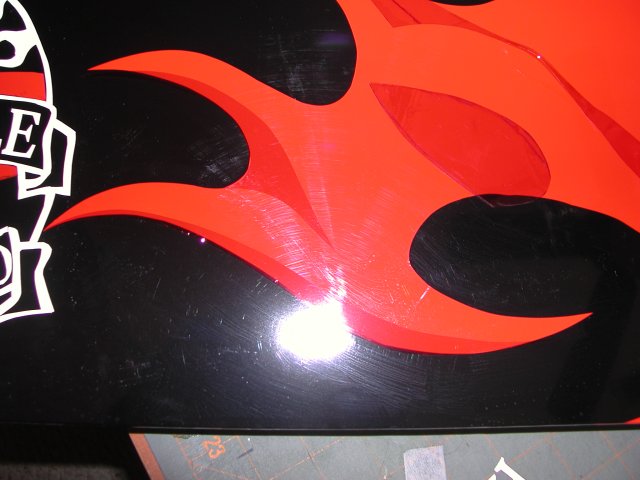

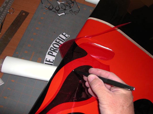

pic 1, 2 &3 I used some red transparent ultracoat to give the flame a little hi-lite, this pic show the variations in red just laying the trans red ontop of the opague color. I lay a good size peice of trans red down and trace the outline of the flame on it, you have to be careful so the red transparent doesn't move, but even if it does, its still ok, it doesnt have to follow the outline of the opague covering, just be close to it
I almost forgot, this small pieces of trans red where stuck in place with windex, then I came back the next day and used heat at a low temp setting so as not to blister the opague covering. The oapgue red was also layed down the same night, so trying to iron down the trans red would have really been bad new on the windex

Sometimews if the graphis is on both sides of the rib, and you get a wrinkle, I try to squeegy the wrinkle to where its ontop of a cap strip, then i take my knife and I filet that wrinkle and try to let the wrinkle overlap onto its self, I had to do this alot on the flag scheme around all the stars....hope this helps, I was pretty lucky on this sledge coverjob, didnt have any wrinkle with the flame layeing over hatch opeings and open wing bays

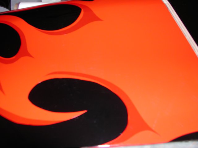

this graphic was done the same way as the graphic on the left wing. you can see that the lettering is almost unreadable, so this is another case where I just sized aanother simular font and cut it out seperate, I just aminly needed the red and white diamonds cut out of this graphic

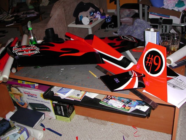

heres a pic of the top and the bottom of the wing nearly finished

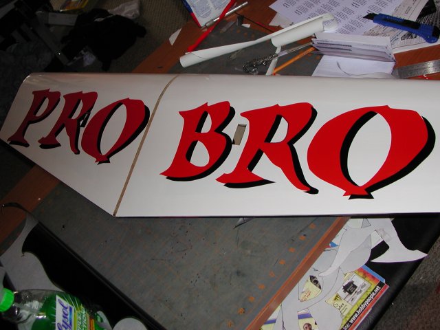

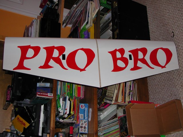

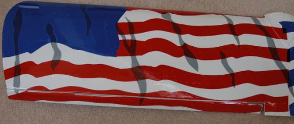

heres how I did the PRO BRO on the bottom, this is all done with monokote, I have used these letters on like 3 different planes so I just put down a peice of red covering and trace around them
the 2nd pic show how I made a shadow with some black ultracoat, when useing black for lettering I like to use the ultracoat because you can draw on the back of it and see your lines, you just gotta remember when you drawing letters on the back side of ultracoat, you have to remember to do them backwards so when you turn the covering over the latters will be right
these shadows where stuck on with heat a few days after the monokote letters were stuck down with windex
pic 3 shows the finished bottom of the wing
I havent mention this yet, one of the last things I do is come back where ever i used the windex and seal the edges down with Trim solvent or Acetone.
hope this is helpful to folks.....Gator
