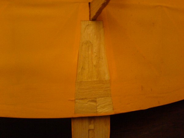

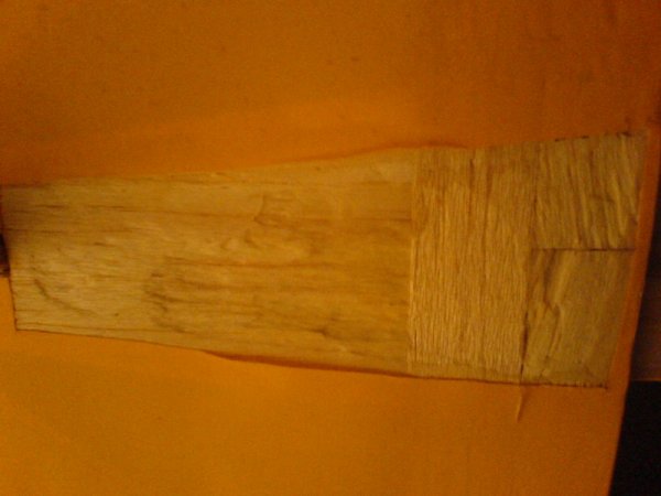

Hi I have just got my hands on a built up but damaged Goldberg Cub, the stab\fin was broken off, damaging the tail end too, some of the stab surface where it was glued to the tail has been torn out leaving a 1 mili deep crater, could any of you fine folk have any suggestions on going about the repair, I don’t have much experience in building planes, but im sure ill pick things up quick with a little advice
Soz if this is the wrong place to post, im a newby to forums
Kind Regards
omally

best way i find is:
cut back to the fresh wood (free from cracks and fractures) and cut a new piece of wood to fit into the gap
i.e. your photo, i would cut off the fractured wood in the rear end and replace it with wood of the same thickness, epoxy the tail back on and re-apply some of the covering
ive had to epoxy the tail onto my trainer countless times

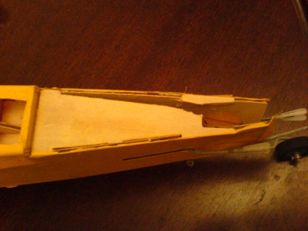

Hello all,
After attempting to fly my piper cup several months back, I made the classic newbie error of giving it too much elevator with not enough speed. The result was the plane climbing 5 feet, stalling, and coming down hard on the spinner. The damage can be seen in the below pics.
after learning to fly properly using a sim and a pz spitfire, I want to give this otherwise perfect plane another go, which means installing new bracings that hold the engine to the front bulk head. Because I did not make this plane, im not so sure how to go about this and would really appreciate some expert advice as how to tackle the repair. Would the best course of action to be remove the formed balsa of the nose section and take out the bulk head, or would it be possible to some how unstuck and pull out the old broken supports and slide in new ones and glue them in? is there anything in particular I need to look out for apart from having them put in straight?
Thanks for any help!!
Mike.
