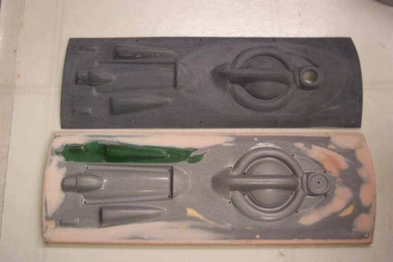

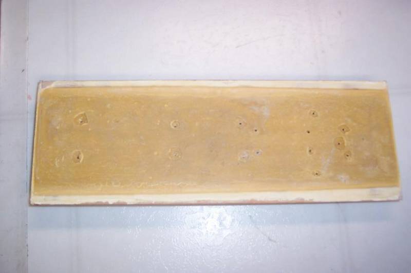

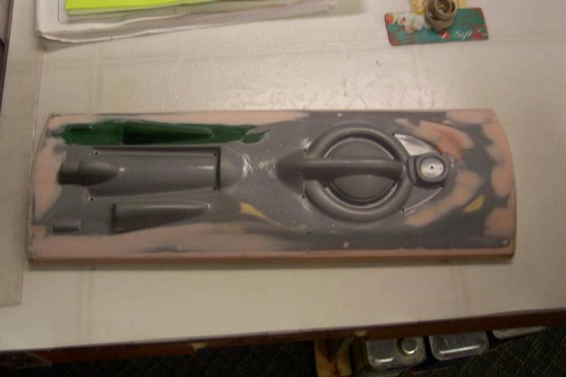

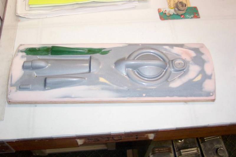

One suitable way would be to use your existing ABS part's and fill the part with Water Putty.
http://www.waterputty.com/
Once dried, it is rock hard and many part's could be vacuum formed over it. Attached are a few pic's of the process used to make new/thicker ABS superchargers for a KMP P-38.
