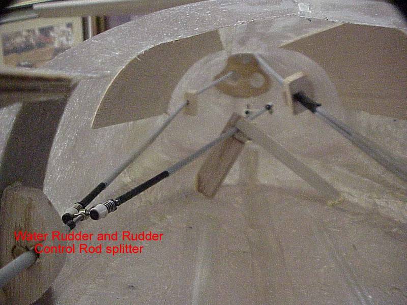

Another way to handle dual elevators on larger planes is what I did on my 104" PBN Nomad - using one servo to control both halves as shown in the attached photos.

my ultrasport 40 plus is setup using two control rods that are then linked in the end to one servo. the rods meet somewhere just before the servo and use something to bind them together then the one rod is longer by a short amount to finish connecting to the servo.
