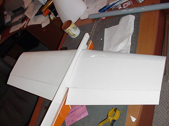

Default How to make a 3D American Flag on your planes
This is my 4th flag I'v done, all have been done on profiles.....the types of covering in this series are:
White Ultracote for my base/back ground
Grey, transparent red and transparent blue monokote.
I applied the all monokote useing windex...I do use heat around some edges as you will see in these pics....Total time was maybe 6 hrs...I kinda rushed it. alot of these steps work best if you let them sit overnight.......here we go

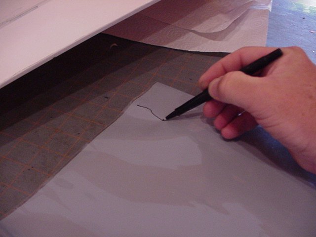

Default drawing the grey stips
after you have your model covered white , its time to start laying down the gray monokote. These lines are just random, nothing has to be defined, I like for the 1st few to go from the LE to TE but they dont have to

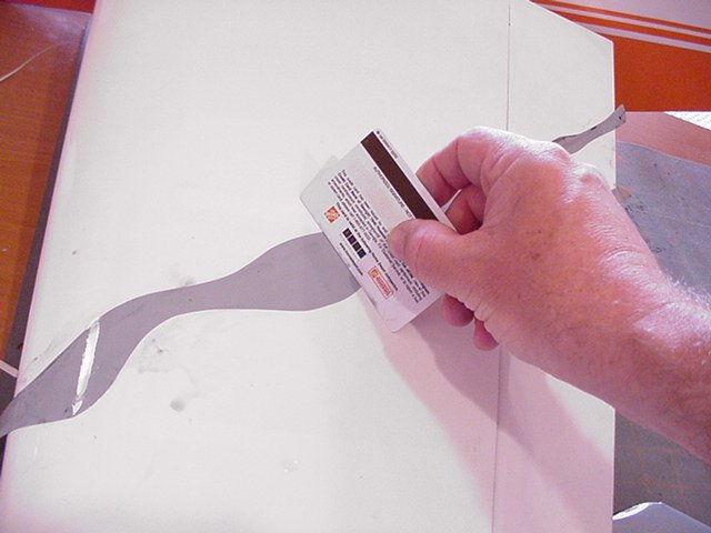

Default credit card
use an old credit card to squeegie the windex out from under the grey, and wipe up excess Windex with a paper towel

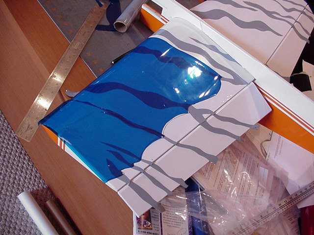

now after you have the grey down, draw the outline of the blue box with the stars. I like to use water soluable flair felt tips for monokote jobs
TERMAGATOR is offline
Old 03-05-2003, 10:10 PM
TERMAGATOR
Join Date: Apr 2002
Location: MEMPHIS, TN
Posts: 2,776
Gallery
My Gallery
Models
My Models
Ratings
My Feedback
Default transparent blue
now lay a peice bigger than the area you drew on the wing over the wing, you can look thru the covering and trace where your blue box will be on the wing.....I screwed up here and didnt cut a peice of monokote big enough so I had to use 2 peices of trans blue, but thats OK...I was running low on trans red too

Default blue box
Heres the blue box temperarely layed down

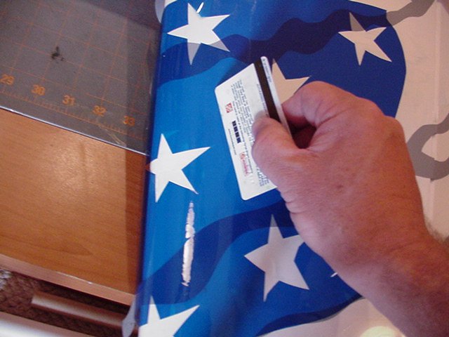

Default applying the stars
after you cut out all the stars, apply Windex to the wing and lay your blue box down, again squeegie the windew out form underneath the blue, be careful some of the tips of the stars may catch the edge of the credit card. make sure you got plenty of blue covering hanging off the LE and wing tips

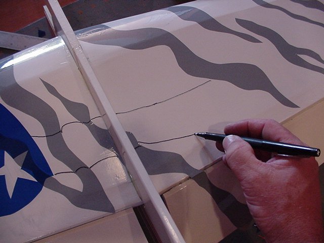

Default continue red
now just continue to draw the red line, remember to change the direction slightly when it touchs the gray
