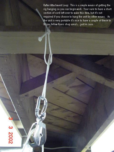

4) Also included: An “S” hook, and a very short loop of rope. These are for hanging the pulley from any handy spot overhead, and/or securing the main Inverted Tee support rope to a stationary object so adjustments can then be made via the slider bar, for model height and such. Use them for either or both jobs.

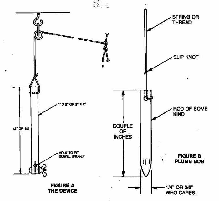

It can be made of almost anything kicking around the workshop - a piece of 1 x 2 (or 2 x 2) wood about a foot long; a piece of 1/4 or 3/8 dowel also about a foot long; some flexible but strong cord about 1/8" in diameter; a pulley you can hook up to the ceiling (preferably over a bench where your plane can sit), and a little plumb bob.
Construction:
Drill a hole parallel to the long dimension near the end of the 1 x 2. It must be snug enough so that you can just turn the dowel by hand. If it is too loose put a saw-cut through the hole and a bit beyond it, and a bolt with a wing nut (as shown in Fig. A) so that it can be adjusted by hand. A hole in the other end for the "hanging rope," a pulley, and two nails in a stud to snub the "hanging rope," and that part is ready.
Next, make two equal loops of soft rope or cord to support the model. The pair I use are 40" in circumference, and they handle most 40 to 60 size models. Cut two pieces of soft cord 40" long and tie the ends together. Pull them taut over your index fingers to make sure that the lengths are equal, and then put a drop of CA on each knot to assure they stay forever.
Now make a small plumb bob. I made one out of a 2" length of 3/8" dia. aluminium rod. I chucked it in a drill press and filed a point on one end. A small axial hole at the other end and a cross-hole made a neat place to tie a piece of string or thread. I discovered later that wallpaper stores sell little lead bobs that are perfect. About a foot and a half of thread tied in a slipknot will allow you to adjust the height of the plumb bob.
Use:

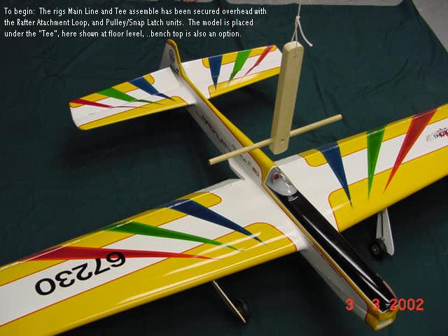

To use this marvellous device, place the model aircraft on the bench with the centre of the wing more or less below the pulley in the ceiling. Lower the dowel and support to a couple of inches above the wing. Place the 40" loops around the wing as shown in Fig. C or D, and wrap them around the dowel 4 or 5 times (same on both sides). Since the C.G. is normally well forward of the centre of the chord of the wing, there will be more weight on the forward side of the, loop than the rear, and the angle of dangle will be different fore and aft. Thus the rope would like to slip forward, but the wraps around the dowel provide enough friction to prevent this. Put the plumb bob string over the dowel. Usually it is more convenient to have the plumb bob on the inside of the loop, hanging over the fuselage, or wing root.

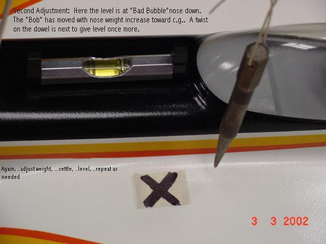

Carefully hoist the model a couple of inches off the bench. Steady it until it reaches a state of equilibrium. By hand rotating the dowel in its hole, adjust the model to a level flight attitude. An important detail in using this device is to have the dowel parallel to the wing spar.
Adjust the slipknot on the plumb bob so that it hangs just above the model and - Voila! - It points to the Center of Gravity. Since all of the weight of the model is being supported by the dowel, the C.G. will be directly beneath the dowel (where- the plumb bob is pointing).
Put a piece of masking tape on the model where the plumb bob is pointing, and mark the spot with a felt tip pen. Or better still; put the tape on before you hoist the model, mark where the C.G. should be, and then get the good/bad news when you hoist it. While it is still up there, you can add weight to the nose or tail, adjust the attitude to level flight again by rotating the dowel, and see before your very eyes where the C.G. has moved to. After a couple of tries you should know exactly how much weight to put where.

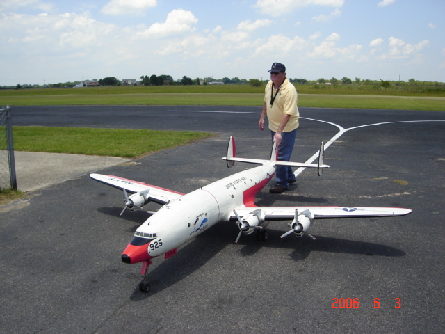

The SIG Magnum C/L stunt model pictured is of 60" span. The techniques shown here could/should be able to service any size model you like. Size the hardware and lines to suit your models size a weight.
Tony
