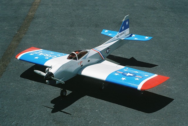

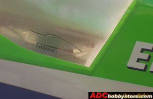

A while back I decided to try and give my plane a smoked metallic look. So all I did was spray two light coats of aluminum lustrekote, letting each coat dry before reapplying. i think it came out great and get alot of compliments at the field. I would guess regular colors would give the same effect as long as its kept light. I am planning on giving it a shot on the next plane. I would practice first. I plan on using clear juice or soda bottles cut in half as my dummy canopy to try first. See if you like, and if it works....just do it!
Tip: For a little extra detail...maybe try using a Vinyl mask of some sort prior to painting. Whether it be pilot name or whatever. See pic.

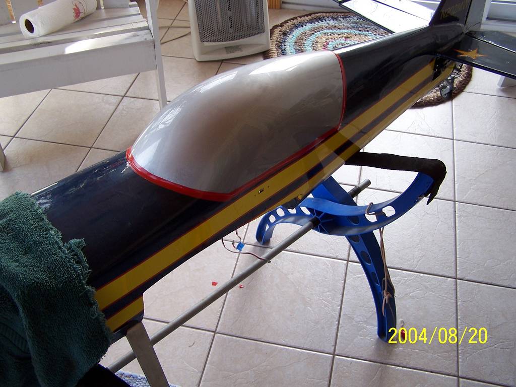

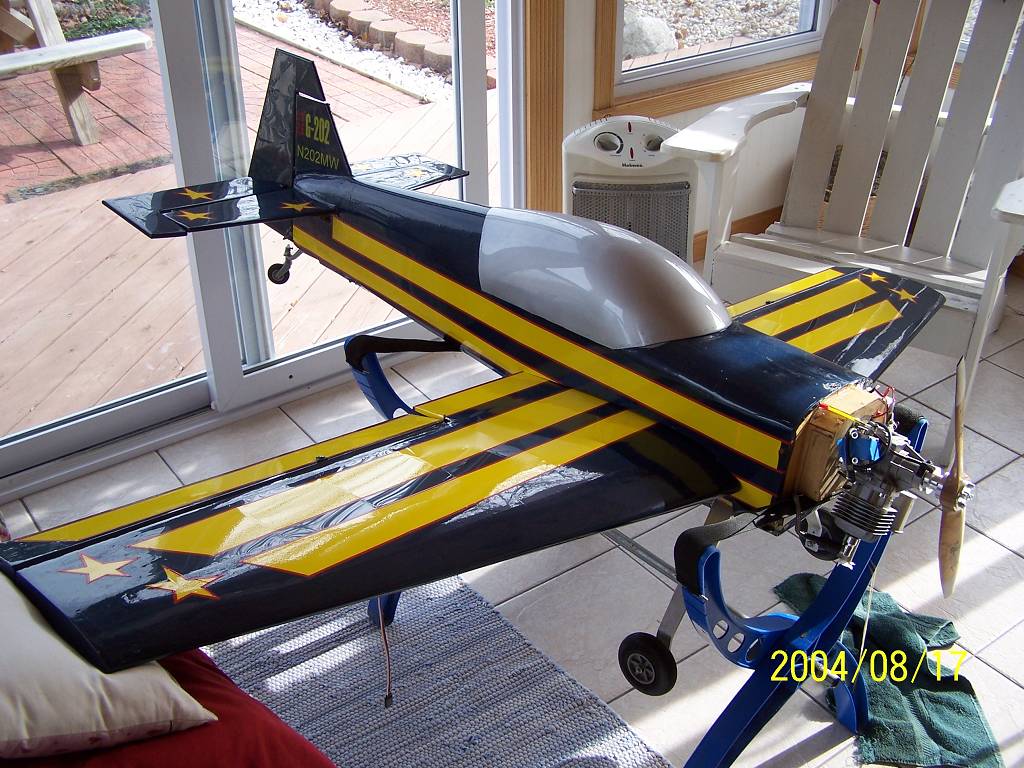

Hey, Thanks a lot Guys. I did the paint job from inside with some crome paint I had...looks ok to me! I will post a photo here shortly. Next...install it. Will the monocote it contacts take glue or should I try clear silicone sealant, which I have lots of??? Best Regards Capt,n
ID:	1309958   Click image for larger version
Old 11-08-2009, 10:06 AM
Jim Thomerson
Join Date: Oct 2002
Location: Austin, TX
Posts: 4,086
Default RE: How to tint a canopy
I used some rattle can aluminum paint on the inside of a canopy. I got a canopy aluminum on the inside and grey seen from the outside. So I'd suggest a test on any metalic paint. Chrome canopy above looks good. What brand paint did you use? A friend has used chrome paint intended for bumpers of plastic model cars. Used it on the outside and put 2-part urathane over it.

I use an ammo can, with the lid removed on teh stove. They are large enough to hold most canopies. Use the powdered RIT dye. Black seems to work best. Tried green on a TigerII and the canopy came out looking like wax paper. Heat it to 135 or so - use the wife's candy thermometer, which she always appreciates. Like has been said, keep it clean, and don't touch. Use tongs, lest your fingers become the color of the dye.
Keep an eye on things, and check often. Once the dye starts to 'take', things go quickly.
I used this dye process on my TF Contender last summer. Still stick the canopy on with dood old slo-cure epoxy. Rust-oleum (brush-on) on the outside for the edging. Works like a charm.

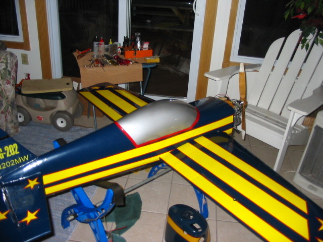

I did use the arrow fletching glue you can buy at most sport shops...even W.world. Here is a photo of the canopy with red trim tape. Capt,n
