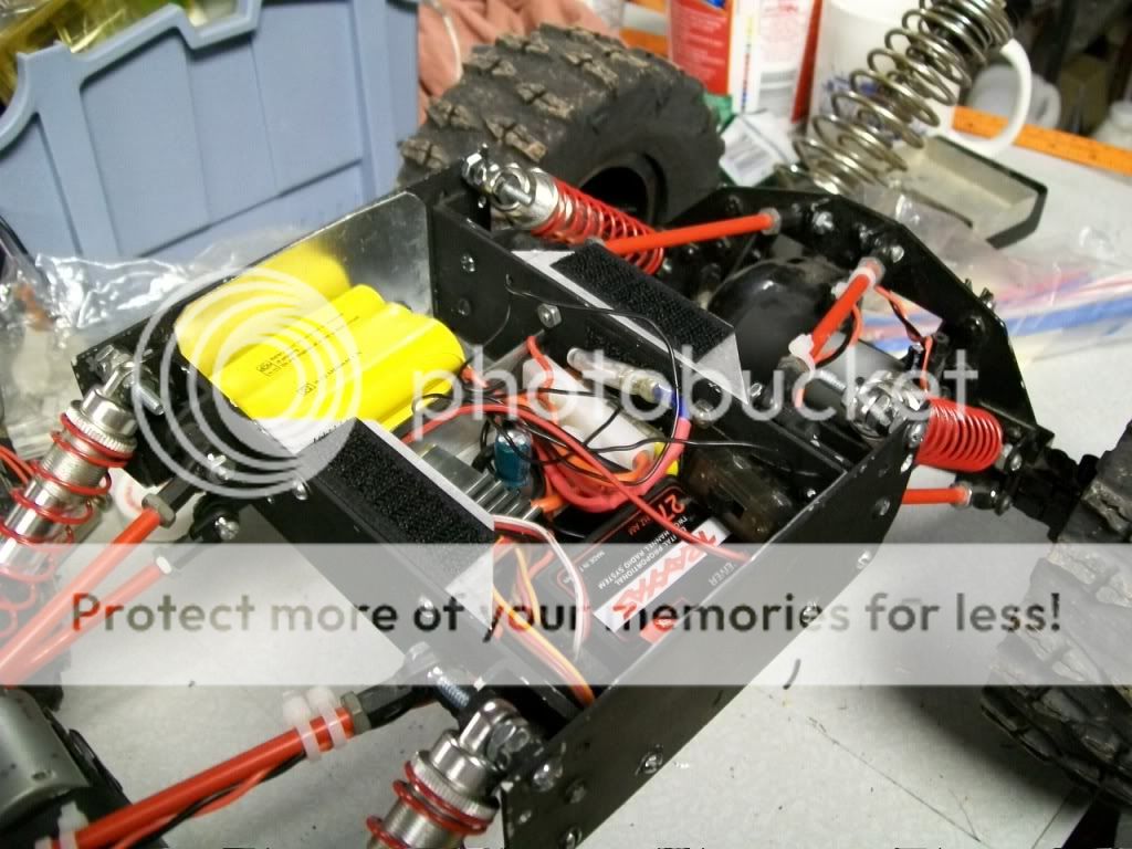

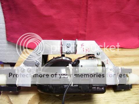

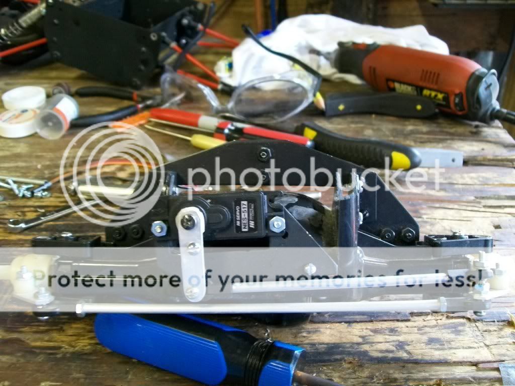

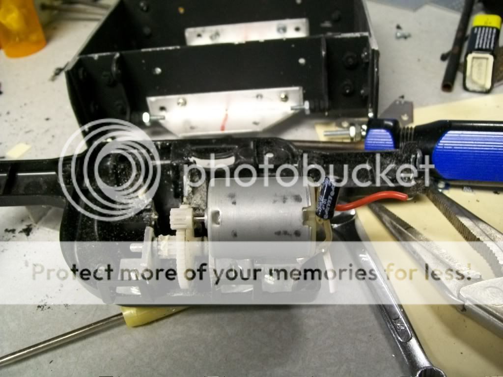

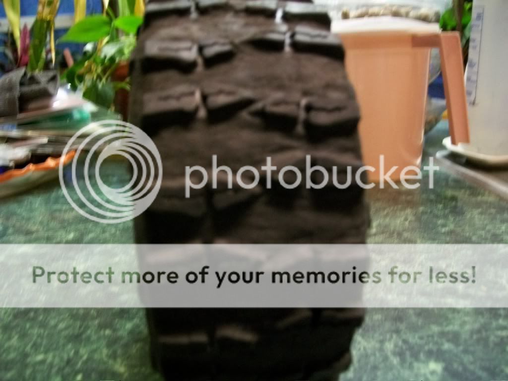

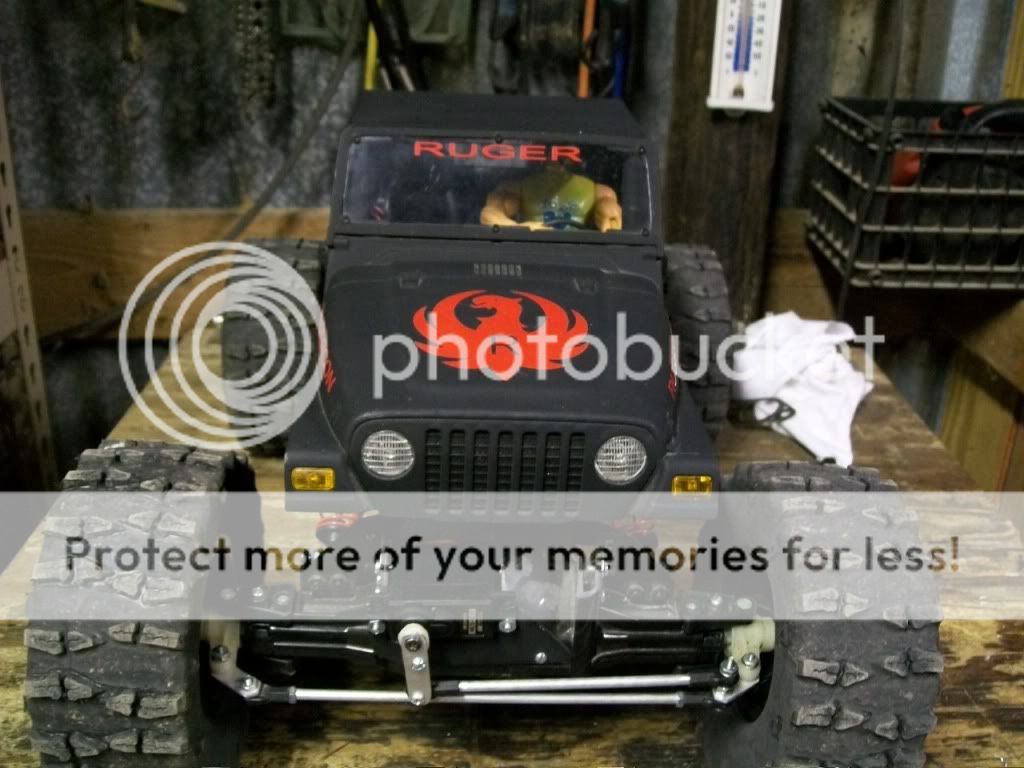

Hi everyone...here is my modded New Bright [8D]
The stock gearing was weak...so I took Texx's advice & did a 4th gear mod 46x10.
While the axles were open I installed 280 motors from an old megatech rc tank
also fabbed a mount on front axle for a H/G servo.

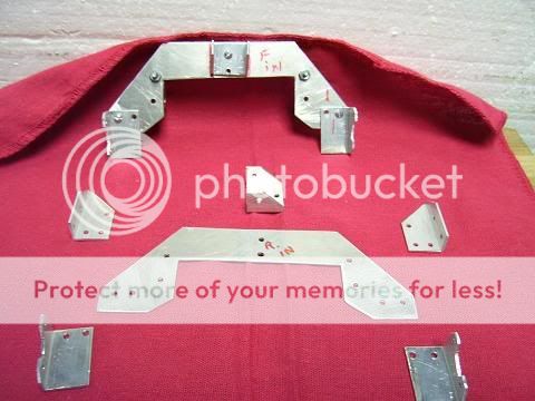

Decided to trash stock suspension & chassis & make a 4 link set-up
new axle,link, & shock mounts
completed front axle
new chassis with H/G electronics
cut tires ,thinned sidewalls, & removed chrome from wheels

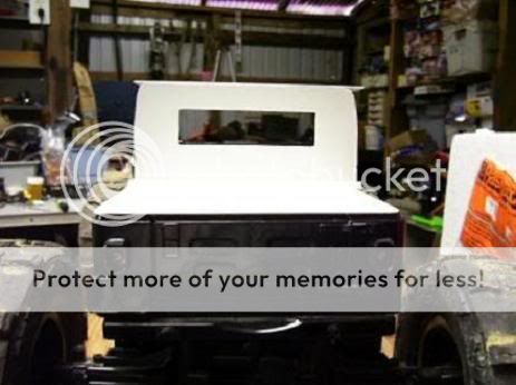

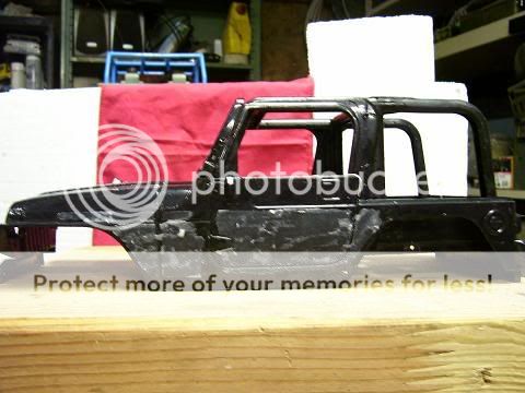

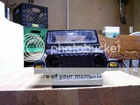

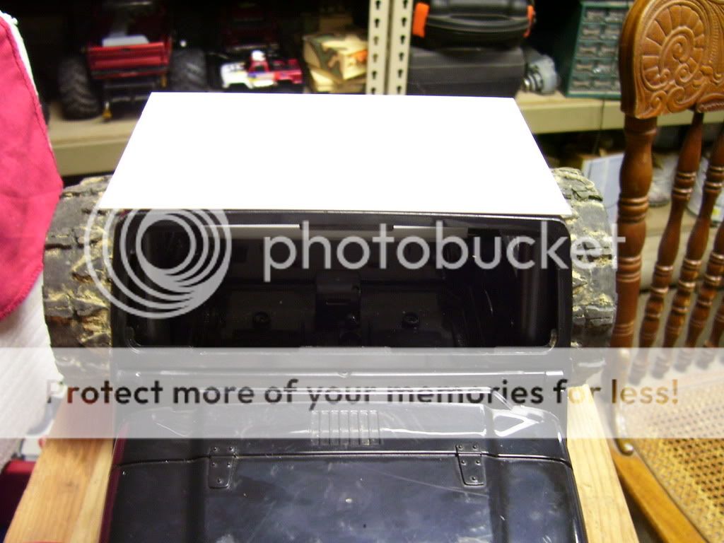

Modded an old NB jeep body
Finished crawler with working lights & home made decals
